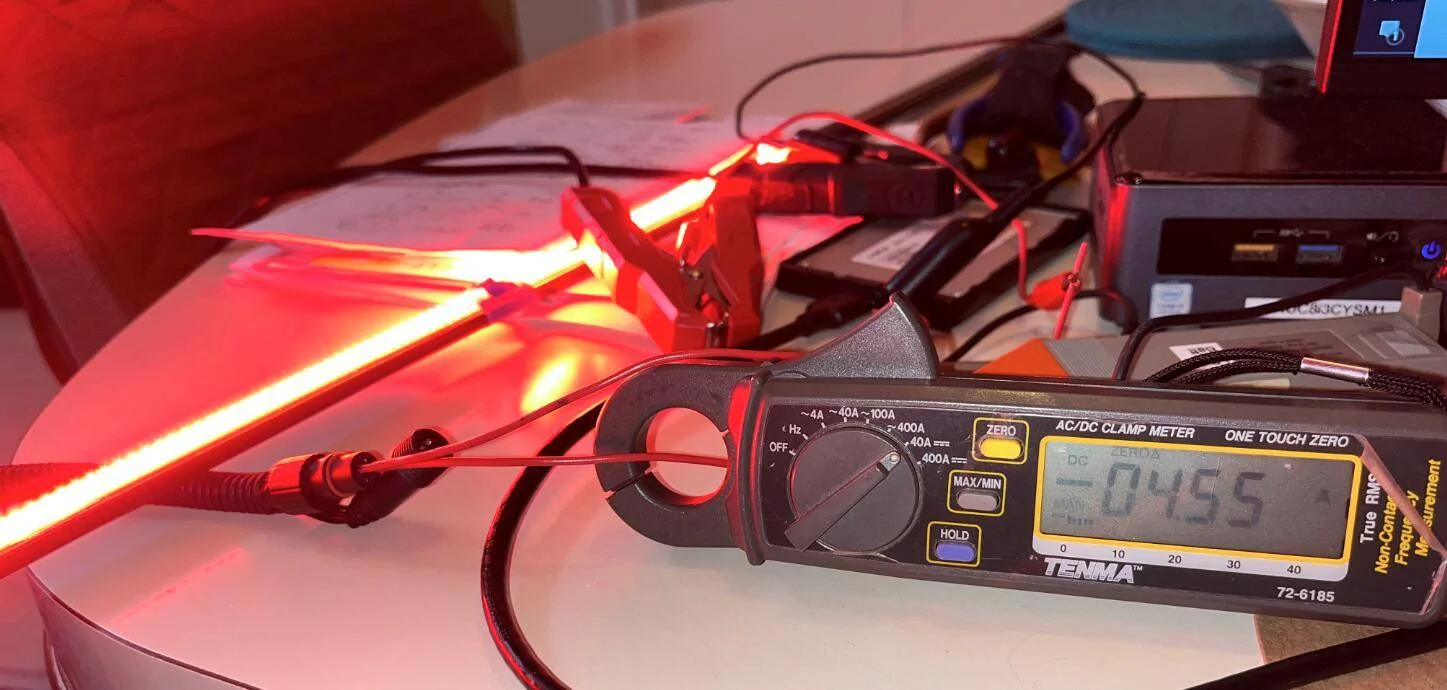

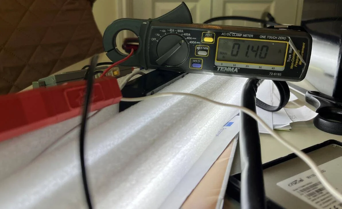

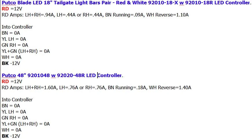

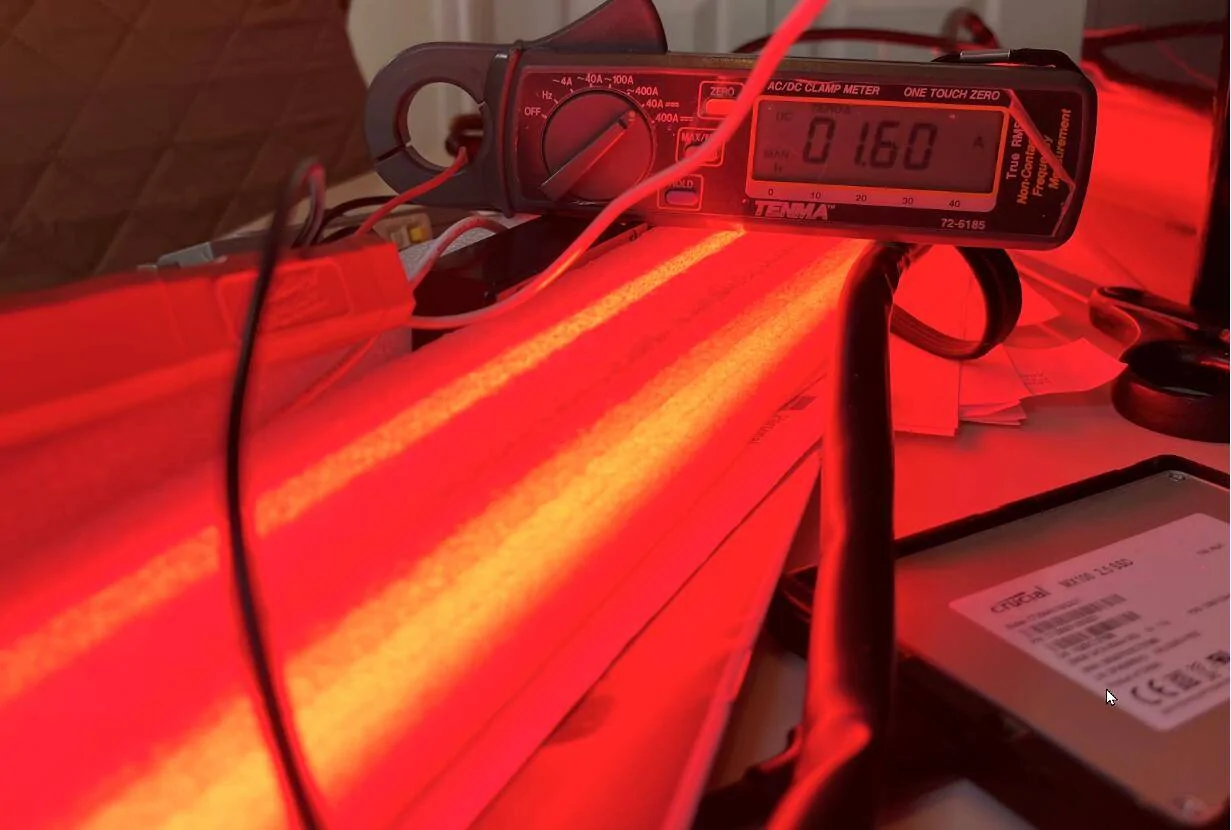

Took some amp readings on a Putco 48" and 18" Pair.
I've had the 48" sitting awhile and then decided I'll use the 18" Pair instead.
48" on a 12V battery going thru Putco controller (the lightbar is sitting in the foam packing)
LH+RH LEDs On. +12 line into the controller 1.6A. 0 Amps on the YL, GN into the controller.
Reverse White LEDs On. +12 line into the controller 1.4A. 0 Amps on the White into the controller.
It appears the LED controller is pulse width modulating and regulating the current to the LEDs.
Running a Putco 48" direct from 12V, LH RED LEDs is 4.55 Amps

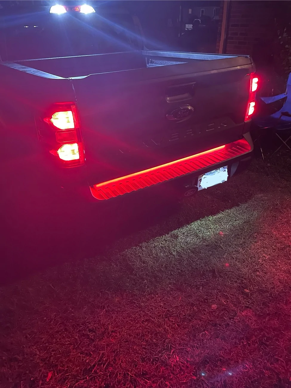

Checking back in. I just finished installing the Putco 48” Blade using the OPT7 harness as a plug and play option. Everything is working 100% with no modifications to the harness or the Blade.
I decided to skip the ACC 12v feed to the Blade driver for now. Wired direct to the taillights. I took some amp draw measurements of the factory incandescent lamps, and the LED replacements. There is enough energy savings that I believe I can add the Blade without overloading the FETs.
I basically tucked all the connections and the driver behind the left rear taillight in the body cavity. If I need to add the 12v feed I can just remove the one taillight housing and add a connector to the flex bed outlet.
I will add better pictures and a video later. So far I am very happy with the outcome.
I also plan on adding a 15” pair of Virtual Blades to the grille, hopefully tomorrow.
