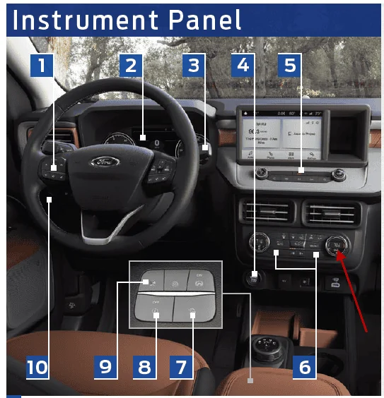

I'm not sure if this is by design, or quirk of my truck. If the climate control is off, the auto start stop is also deactivated. I found no reference to this feature in the owners manual, but I like it. Included image indicates the climate control on/off for reference.
