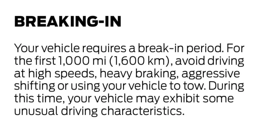

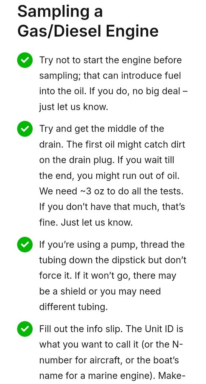

Per the Blackstone web site - When it’s time to take your oil sample, you can do it one of two ways: either take the sample when you change the oil, or draw it out through the dipstick with a pump
If during an oil change, they suggest taking the sample from the middle of the drain.
Thanks for posting. I was unaware.
Blackstone also recommends NOT starting the engine before sample is taken.

I have a pump Im just waiting on a hose extension because it doesnt reach all the way down the dipstick hole.

If you are following Blackstone Labs instructions. (☝post #21 first line)
You should NOT be dealing with hot oil at all??
