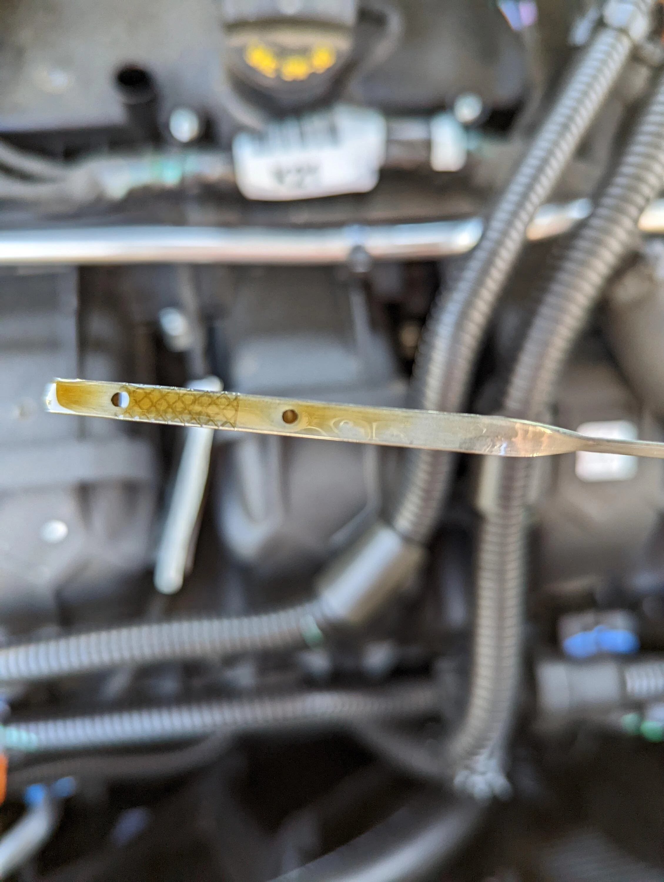

Shut the engine off for at least 5 minutes before checking the oil level. Oil can remain in the dipstick tube and 'contaminate' the stick with oil. Also, pull the dipstick out, wipe it, and wait a minute before reinserting again. This lets the oil drain faster from the tube as opposed to with the stick in place.
I mention this because the dipstick picture appears to have gaps in the level of the oil, meaning that it might be oil in the tube has not had a chance to drain out and you are getting a false reading of high oil.
Good luck.
Engine hadn't run in at least 12 hours when I checked. This picture was taken after I had checked it a few times, and a couple minutes after the first time I checked it.
Getting it over-filled is frequent with pro shops, I've found. One solution is to get an oil extractor pump, works great. or something similar. Put small tube down the dipstick hole, easy, quick. If I ever have a pro do it, I'll check it in a nearby parking lot, and it's so quick to pull out half a quart, I could do it in 3 minutes into a small container.

I would check dipstick length to make sure it is correct length. In my case i did oil change by myself and added 5.7 quarts of oil - that was right amount of oil. (hybrid model)
