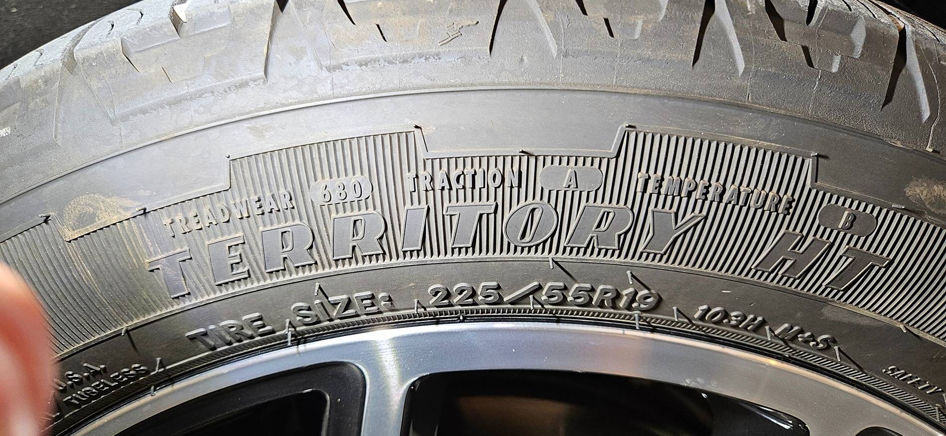

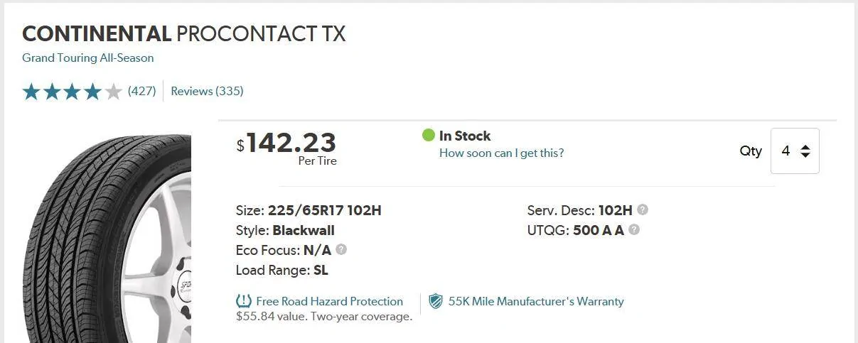

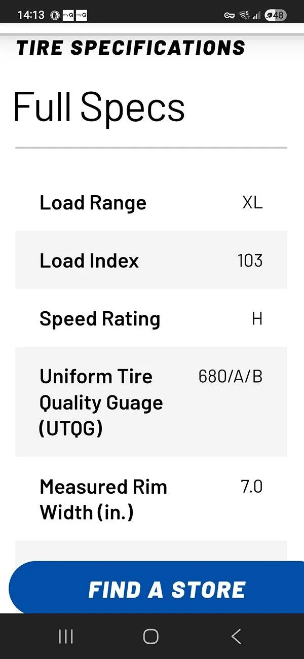

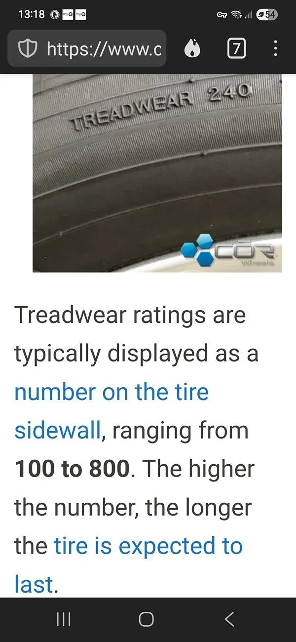

Its all about driving properly. Other people can easily exceed the rated miles on the tires. Look at the federally-mandated UTQG number on the sidewall. All of the different factory tires sold on the Maverick are molded with between 500 and 680 UTQG. Multiply that by 100 and that's what the expected life is in miles. If you can't get that number of miles then there is nothing wrong with the tire and something is wrong with your driving.

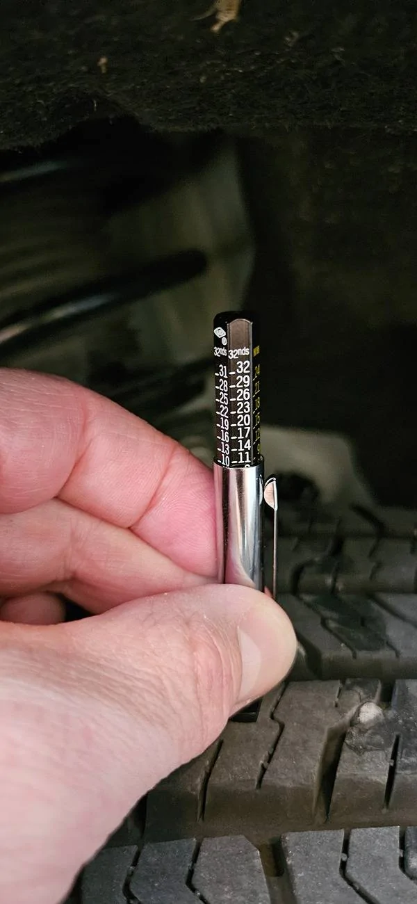

My factory spec Michelins are doing great so far. I expect I’ll get only 25,000 because I’m in the Appalachian mountains and am turning a lot.
My 25,000 estimate is based on 6mm useable tread because I always replace at 4 mm, I never go to the wear bars at 2mm.
I’ve used 1mm of tread and am at 4,600 miles.
4,600 X 6 =27,600 miles, yeah I’ll make it to 25K
