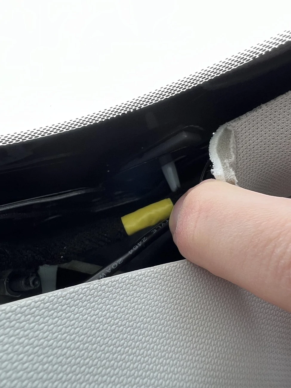

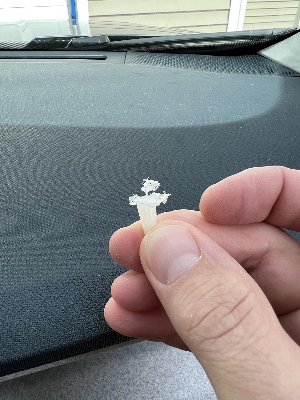

Yep. Rsttle n knocking sounds. Vicinity of pass side dashboard.
Took truck to dealer. They never touch it for 5+ days, and never got any progress report that I asked. Can see truck not moved on Ford Pass location status. Retrieved truck, angry.
A owner posted pictures of his rattle, and solved it. Windshield guide pin.
