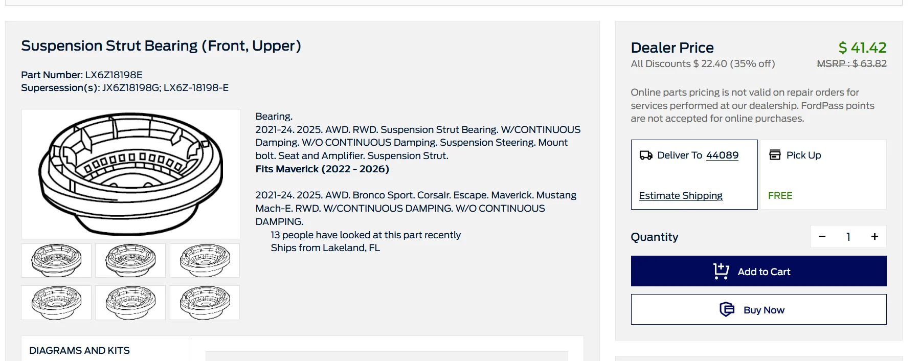

I had a front strut bearing failure. Clicking and popping when turning. Replacement was not very difficult but not impressed with the quality of the OEM bearing assembly. Cheap plastic and small bearings for a critical component.

Usually it is strut bearings that wear out first, and are the first component in a strut system that makes noise.
There are no struts in the rear...
