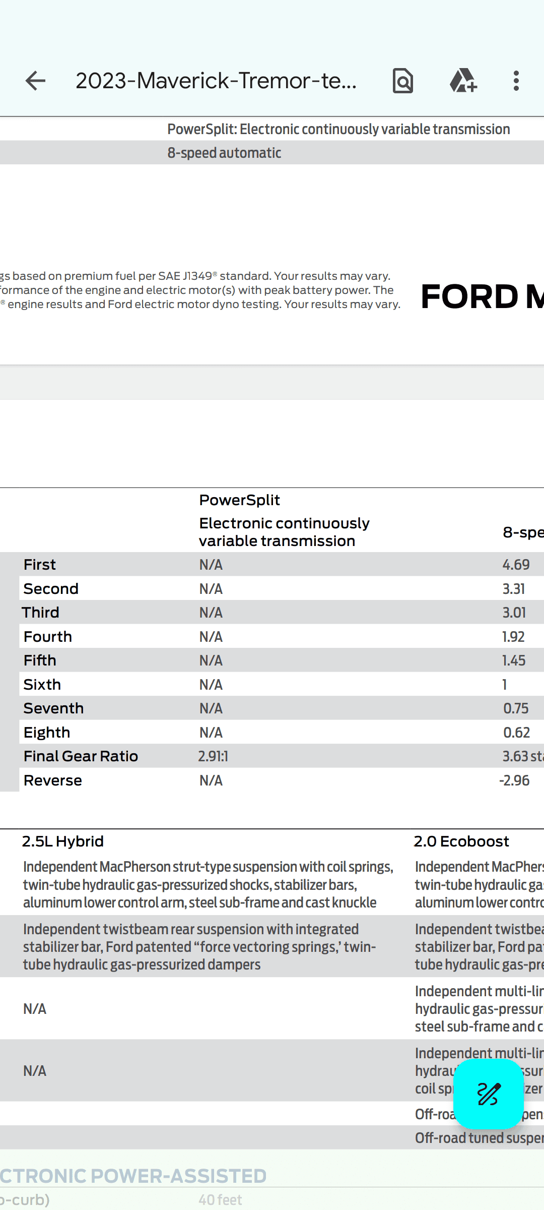

Think this is why
Ford Maverick No second gear? Screenshot_20231218-204302
the tune basically makes it a seven speed
