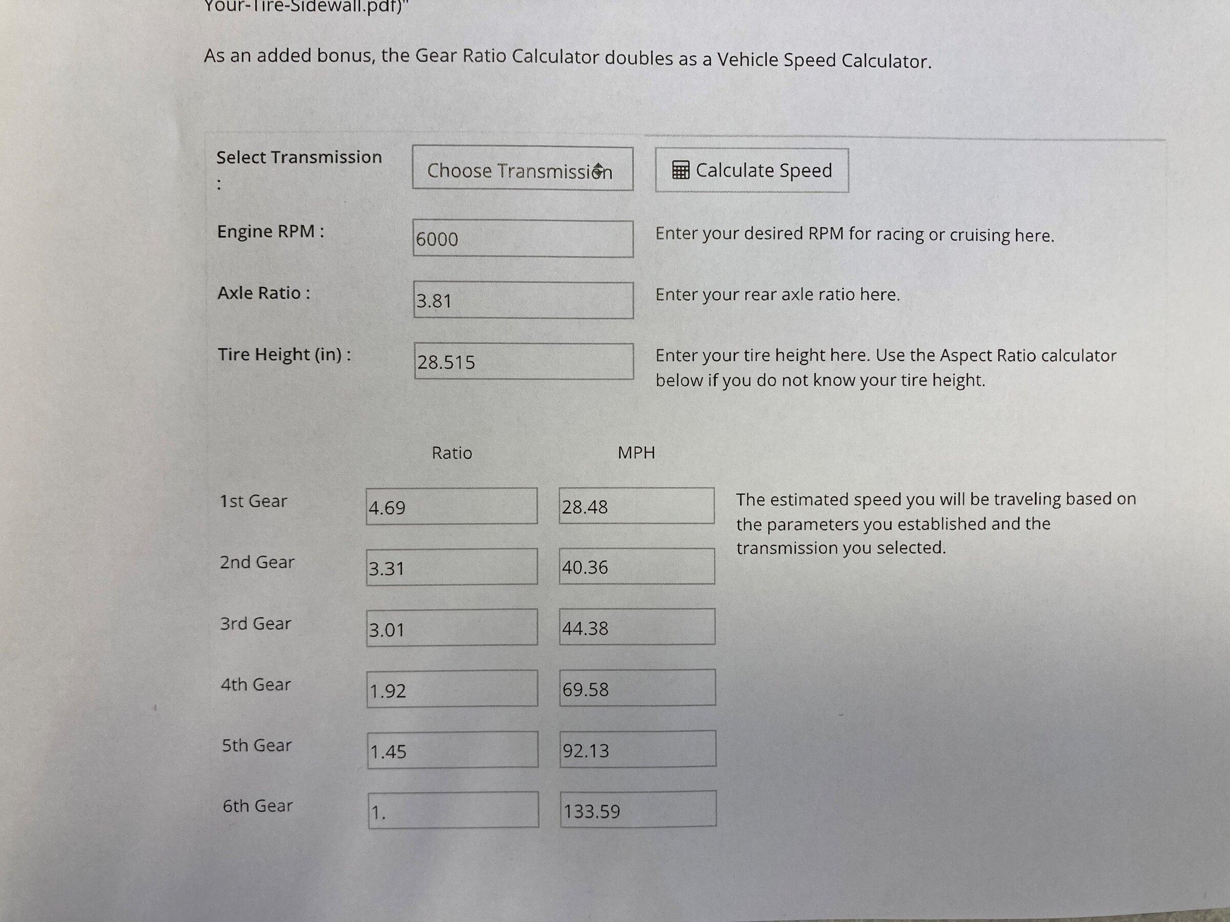

Ford Maverick 0-60 skips 2nd gear gearing2

Gear Ratio Calculator (tremec.com)
If you can agree that the truck shifts twice to get to 60mph (1-2 and 2-4) then you can see by the gear ratios in our trucks there is no way that it can hit 60mph in 3rd gear. 6000rpm in 3rd gear in a non 4k tow 2.0L would be 45mph. That means the transmission has to be using 4th gear to get to 60mph.
Like I said it is not necessarily a bad thing since avoiding another shift (2-3) might actually be quicker since the 2-4 shift put the engine in the torque peak.
I did not believe it either but if all the numbers I am using are right than it makes sense.

I was looking at some more videos tonight and I think I was wrong. It seems that the transmission actually skips 2nd gear not third like I originally thought. The problem is since the 9 speed design that this transmission is based on had the 4th gear removed which used to be in between the current 3rd and 4th gear we have. Our fourth gear is actually the 5th gear this transmission was originally designed with.
The more I look into this the more it frustrates me. Some Mavericks are skipping 2nd and others are skipping 3rd instead. I made a video of mine this morning and based on the rpms at speeds and using the gear calculator mine is actually skipping 3rd gear. Many of the videos I analyzed online the truck skips 2nd. I am surprised that it varies. Regardless the issues remains that we are stuck with a GM transmission that had 4th gear removed
