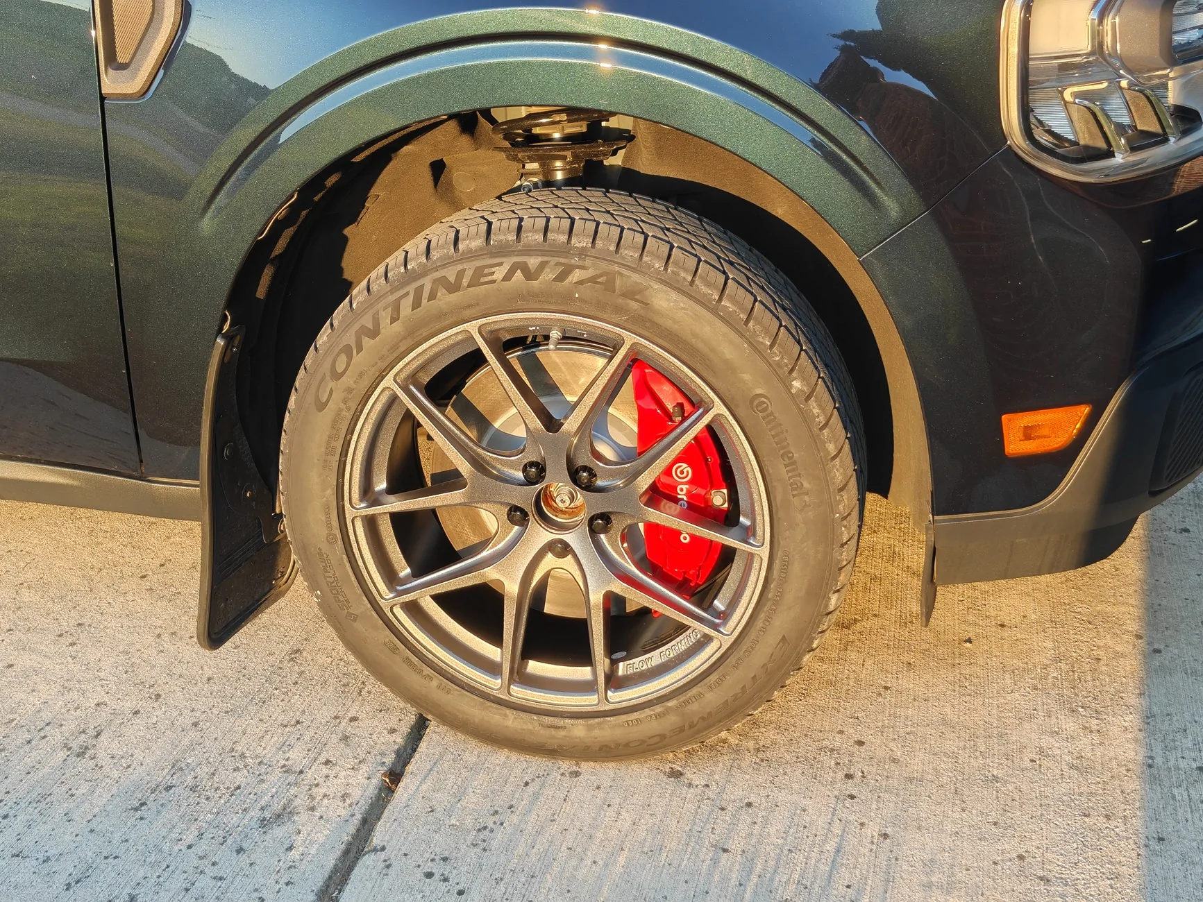

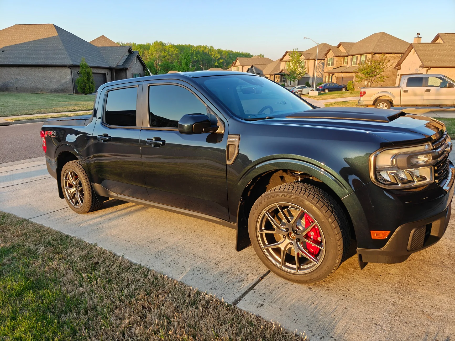

I bought the Ford Performance lowering springs and dampening kit. So it lowered my truck to the standard height of new Lobo.

I got the front calipers off a dead 23 Mustang MachE GT from car-parts dot com and bought OEM MachE rotors. My pads were still good so I am using those. I did this upgrade since others had already proven it would work.

What about the centering of the caliper onto the disc? I’ve heard you need spacers.

Here's what my installer used:
(X4)12mmIDx24mmODx3mm Stainless
Steel Grade 8.8 Spacer $4.99EA = $19.96

I don't know where he got them. From what I can tell, it's a standard washer/spacer size so should be easy to find and cheaper.
