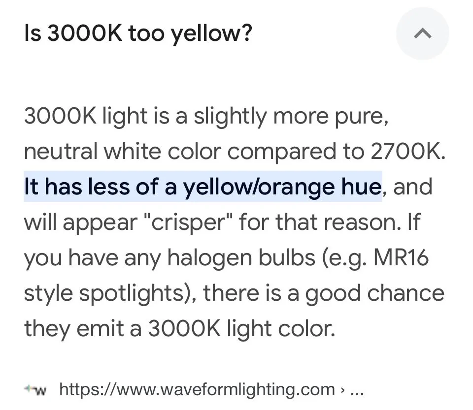

3k is traditionally NOT YELLOW.
3k is traditionally “warm white”.
Hell, I have 2700k all inside my home, living room, kitchen.
It’s not yellow.
Ford Maverick New Ford Maverick Lighting Kits by Diode Dynamics | 1/18/24 1705681225710

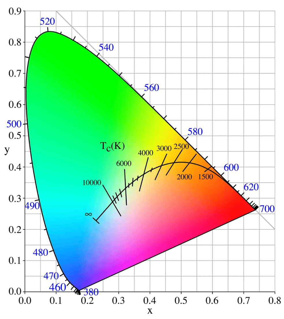

Reference: CIE 1931 chromaticity chart
You're correct, 3000K is warm white within the White color space.
2700K or 3000K is the energy, it does not refer to a specific color unless it is within a defined color space.
Selective yellow generates the same energy level but outside the white color space.

I am sorry you are confused about the technology in your business.
To call yellow fog lamps 3000K color temperature is not correct and misleading at best.
In no known universe does a 3000K color temperature look like the photos you provide.
So 3K is just a name. Not a specification. Got it. Maybe a better name could be used?
Ford Maverick New Ford Maverick Lighting Kits by Diode Dynamics | 1/18/24 IMG_0826
