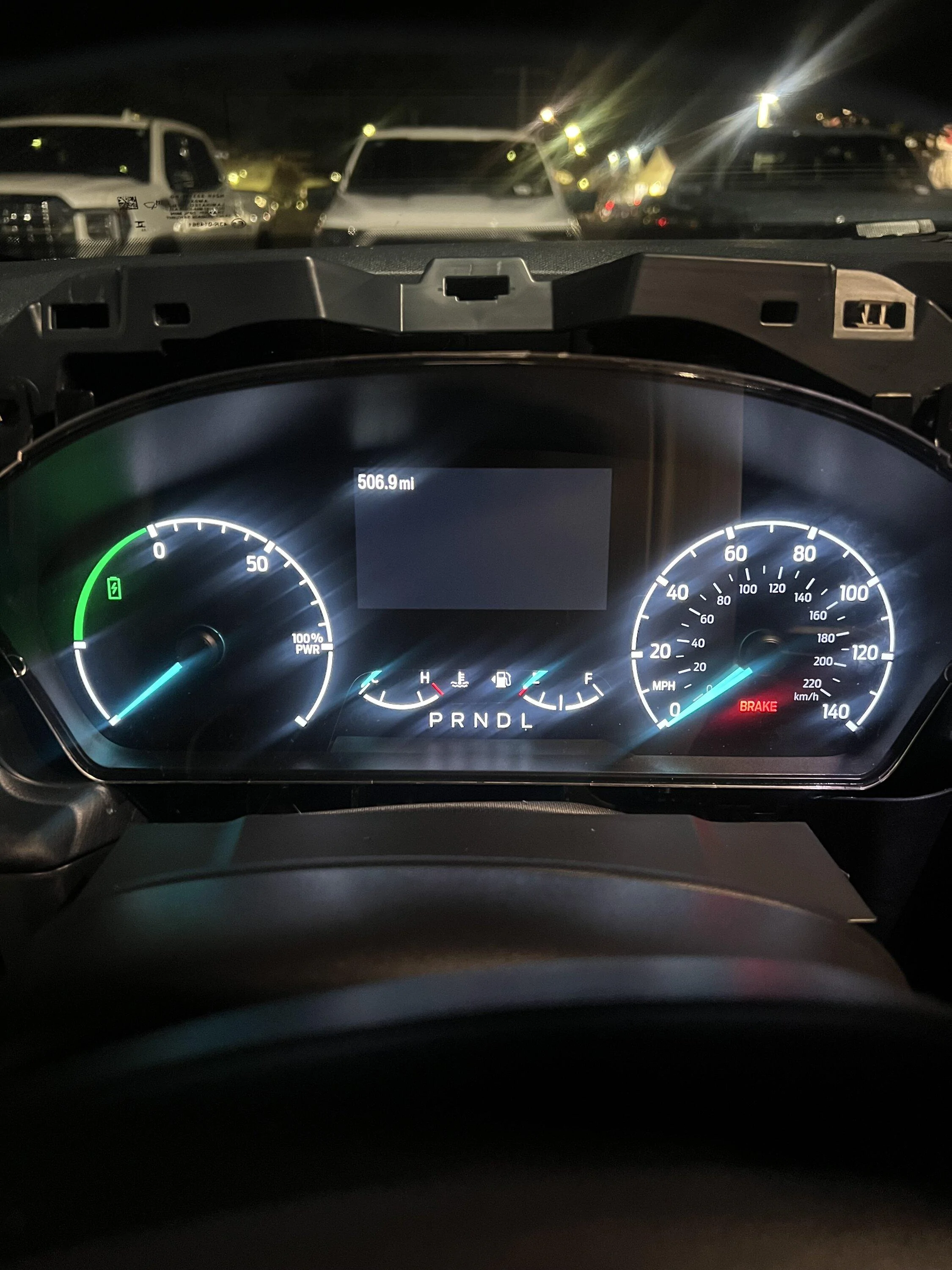

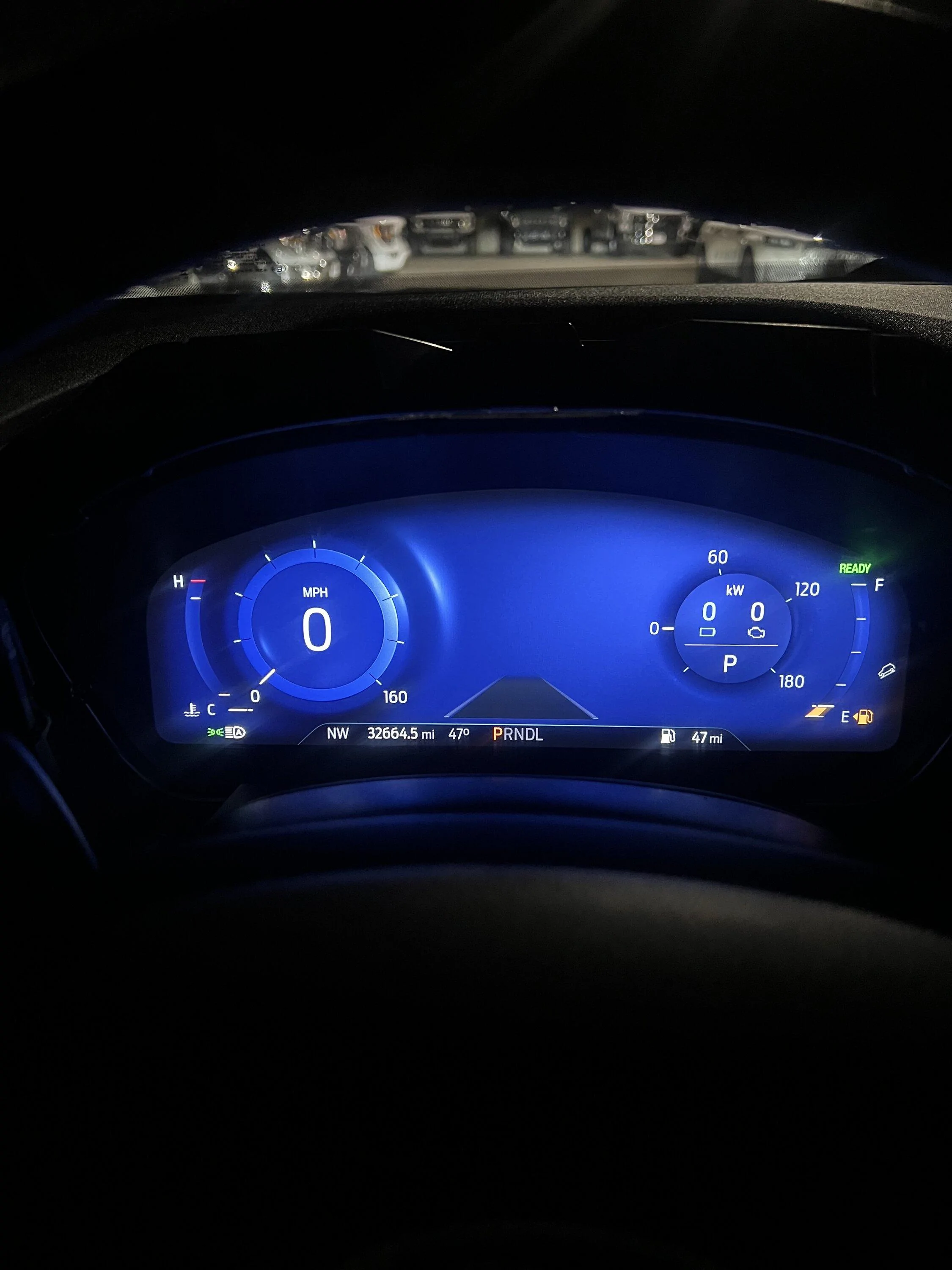

First off hey guys! Loving the truck so far I’ve had it for a month now and just hit 500 miles and still have not put gas it it!
Anyways I’ve ordered a digital cluster for the Maverick from the escapes and wanted to know two things if anyone has any info on how to get the miles to match my current one please let me know! Or do I have to send it off to be done. (I’ve found one guy who’s website says $190 to complete) Second. What settings do I need to make sure I copy over in forscan I know the ipc is definitely one I should backup and make sure I save but then how do I sent the as built to the new one? Do I just plug it in and send the settings etc? New to forscan and everything so please bare with me but I am ready to learn!
