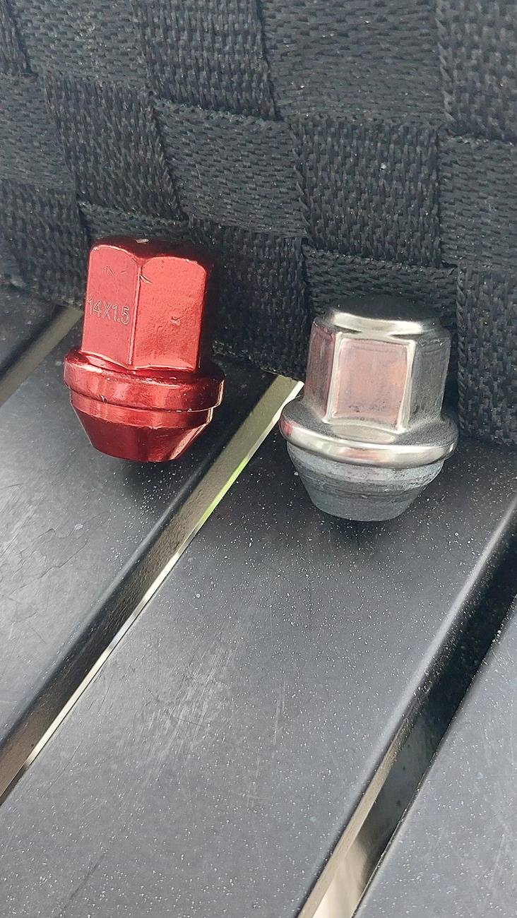

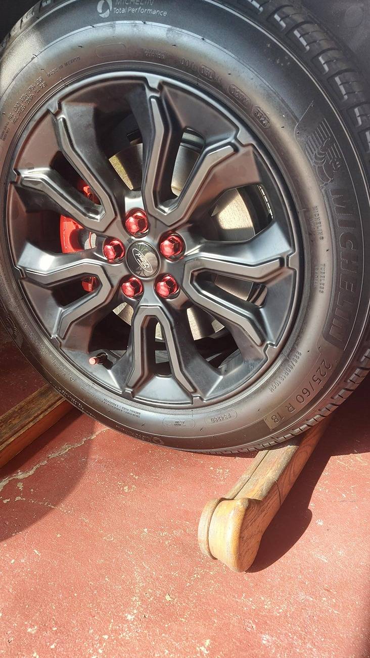

23OxOrdered
Sep 25, 2022
75
NJ
2023 Maverick XLT - BAP and LUX package
M14x1.5 bought and put on my 2023 trucklette
24Pc FORD 2015-2022 F150 M14x1.5 LARGE SEAT LUG NUT FIT FORD STOCK WHEEL &MORE ({RED)}
https://www.ebay.com/itm/384325331000
note: needed to buy a new lug nut socket 7/8"
