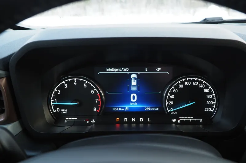

This is driving me nuts. My 22 Lariat AWD Ecoboost has a really strange AWD behavior that i haven't seen in my last AWD car. Basically it runs like a FWD until the front wheels spin, then it finally starts behaving like an AWD car. I can see this through the AWD monitor on the dashboard and also feel it when accelerating. But after maybe 10 minutes of proper AWD with 60-40, or 50-50 bias whenever i step on the gas, it just goes back to almost pure FWD mode. Shouldn't it kick in if i give it enough throttle from a standstill in order to prevent wheelspin?? It's like the computer is too dumb to predict when it's really needed. Instead it seems like i need to burn out my front tires a little if i want AWD functionality, and only just temporarily... I used to have an AWD RAV4 and it never failed to kick in, so at no point did i ever have any front wheelspin... It's definitely not related to fluid temperature because i've driven the shit out of it the last couple of days and it just LOVES pretending it is a FWD Maverick.
EDIT: I just talked to the Ford dealer and apparently they have not programmed the RDU they just installed on my Mav (the original one died at 28k) So that explains why it's acting so weird. I've got an appointment to get it programmed. Scary to think a non car person could have simply continued driving without noticing anything.

If all Mavericks were like this, the 0 to 60 times wouldn't be anywhere near as good. Something's definitely wrong but it's not showing any fault codes. Also the logic of the computer seems off aswell, it'll give me a 90-10 bias in city driving, but i get on the highway and it goes 50-50 while doing 60mph on a perfectly dry road?!

So from a stand still, you hit the gas and it only shows the front wheels being active? Because at normal speeds yea the front wheels are only going to be propelling the truck.

Yes, then maybe for the next 10 minutes AWD kicks in as it should and it's glued to the road when accelerating. Then at random it goes "Nope i'm back to FWD only"

The few times I've used that display, whenever I start moving, it shows the rear wheels doing something, and then that backs off. In Sport mode, they don't back off as much. I have the 4K towing package, but I doubt that makes a difference.

Well if that’s the case then you should probably have it looked at for sure. Especially if you come to a complete stop and it doesn’t show the rear wheels working at all if you start giving it throttle. Could be something easy like a software update maybe.

I can only speak to what I see on my display but after I come to a stop, taking off is the only time I see the rear wheels being used and that dwindles down depending on the amount of throttle I’m giving it. I don’t have sport mode so I cant say one way or another on that.

I've tried the different modes, but they don't have an effect on traction bias for me
