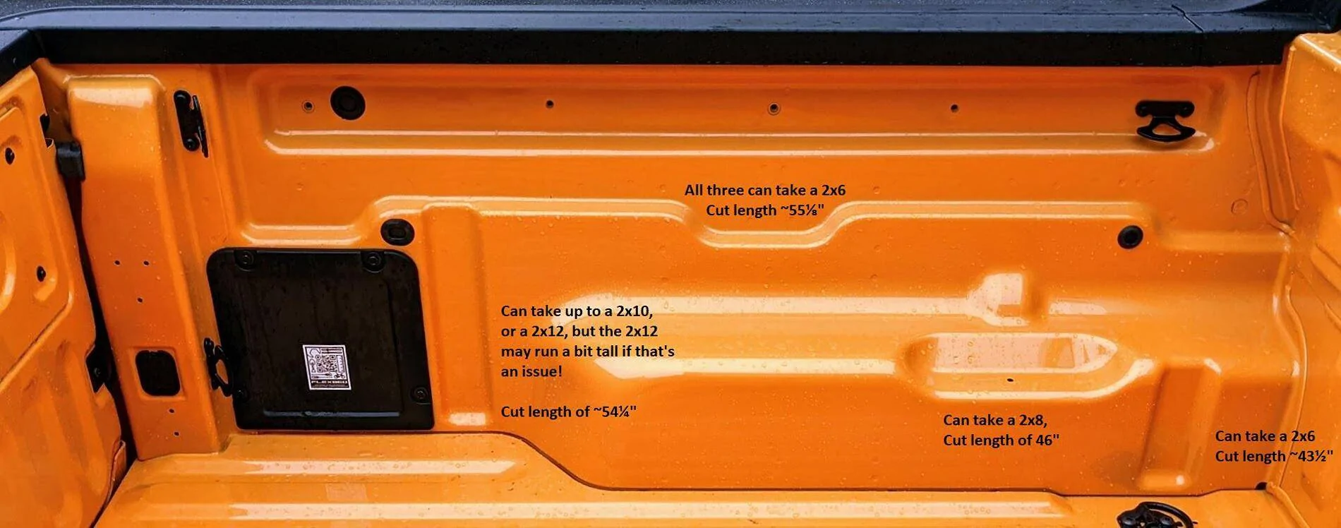

If you use the 2x6 cut exactly the right lengths, you can build "sections" in the bed and have stuff not shift around as much. I have spray in liner, soft tonneau cover, and always a 2x6 sitting vertical in the rear-most position. That section works great for groceries!!!

Just remember that the rear end is slightly higher than the front end, and unless you accelerate like a jerk then your load will tend to slide forwards and not backwards. If you want to stop smaller things like groceries from sliding to the front then cut a 2x6 to fit in the first bed slot, giving you an almost 2ft "trunk" in the bed. If a load is going to roll to the sides, then think about strapping in down with some common ratchet straps. The ones with the tab release are much easier to undo than the big-truck types. With the tailgate down you have a 6ft bed, so a kayak up to about 11ft will just need strapping down and a red flag attaching, and no mileage-killing roof rack is needed. If you strap down the front of a load then you can get away with maybe lighter 16ft loads too, but you need to think about that swinging out of the turning circle and hitting things when cornering.. Lastly, get a dog seatcover off Amazon so that you can put a lot of stuff on the back seat without messing up the upholstery.
