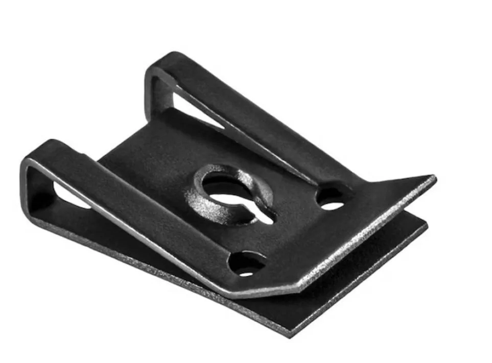

The (2) lowest positions actually use a #8 screw and a metal clip nut, if the drivers side you should be able to crawl under and see if the clip nuts are still there, and just put new #8 sheet metal screws & washers on. If not, you can get clip nuts at any decent hardware or auto store.

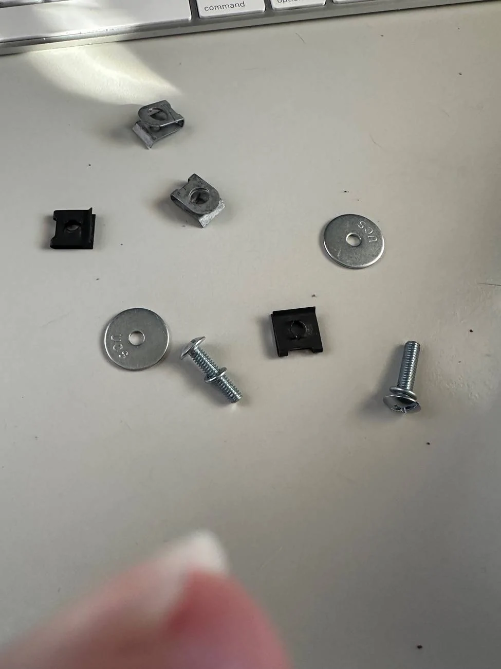

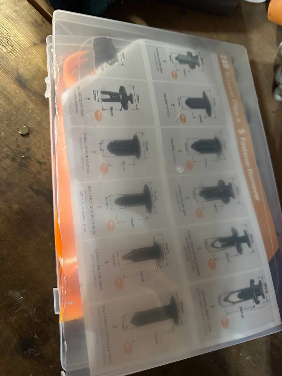

So my saga is now and this was far more of a PITA than mud flap should be. But here is the resolution:
  1. Mabett Mud Flaps from Amazon $33
  2. Plastic rivet kit from Amazon $12
  3. Ford OEM plastic rivets $16
  4. Hardware from Ace Hardware $1.57
    1. 2 Fender washers
    2. 2 lock washers
    3. 2 #8 threaded screws
    4. 2 of the clip nuts.
    5. Spending 5 minuets with the guy that was a few years older than me: Priceless!
  5. About 2 hours of my time, research, store and crawling under the truck!
I will preface this with I have MS so when I first saw the @MABETT mud flaps and how they attached I was excited since the MS has mess3ed with the muscles in my legs. Getting up and down from the ground has its challenges, I will leave it at that.

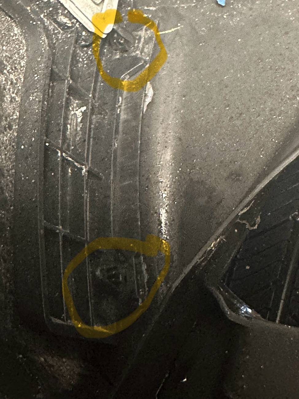

So, since the original plastic rivets seemed to work well that came on the truck, I went out and bought an assortment pack of them. I had figured that even if I used the two out of the pack, I still have mud flaps on all 4 and I have taken a look around the truck and see these things all over, odds are good that I will need a few again. When none of those fit right, I bought the OEM ones from Ford. Those did not fit correctly either! I took @Hot Runr Guy 's advice and bought the hardware looks like a great cure and I believe that it still is, so thank you for the suggestion! The #8 screw I bought was 3/4'" would fit but was almost short, so if you find your self in this but the 1". I got my partially crippled a$$ on the ground and the original nuts were still there. Not sure why they were there nothing screwed into them! Also the #8 machine screw did not fit. I pulled those off and tried the ones I bought but at the same time, I realized that I not had this nice big holes to tie everything together and now it looked like the plastic rivets may work. So, I pulled out the plastic rivets that came with the mud flaps and lo and behold they now fit with that clip nuts removed! The plastic rivets now appear that they will hold nice and tight going forward. Time will tell on that one!
The remaining flaps will need to be checked down the road and I have no idea why the top hole is different than the 2 below on the truck or why the clip nuts were installed and never used! To add insult to injury, that hole does not have s clue nut behind it either. Which for me was quite misleading for the lower two holes, since the top one fits great! The silver clips are the ones that were on the truck in the photo below.
So if you took the time to read this I hope this does not happen to you or perhaps you googled it and it saved you some frustration!

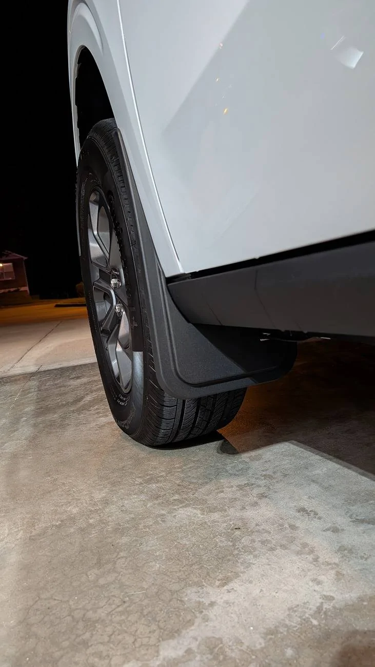

It warmed up enough to clean it up and do the install! They went on easy, seemed solid enough, and look fine.
