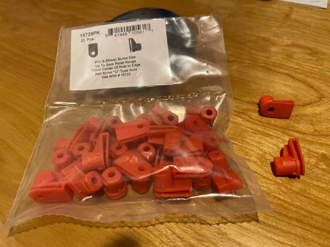

I've owned a Maxzina set of mudflaps in the past that had plastic clips that were clearly better than the factory ones. Now I have a set of Rockblokz mud flaps that have a different setup that I consider much better.
Rockblokz supply sheet metal clip-on nuts, sometimes called "J-nuts" or "J-style nuts" that clip onto the holes that are in the body sheet metal. Then a stainless screw is inserted through a small fender washer, through the flap, the felt liner material and screwed into the J-nut. This seems to be a much heavier-duty way of fastening than the usual plastic clips.
I thought these were the ones that came with my RokBlokz?
HRG
Read the whole thread. ;) See post #5, posted a couple of hours before your comment.
Thanks for the pic!
