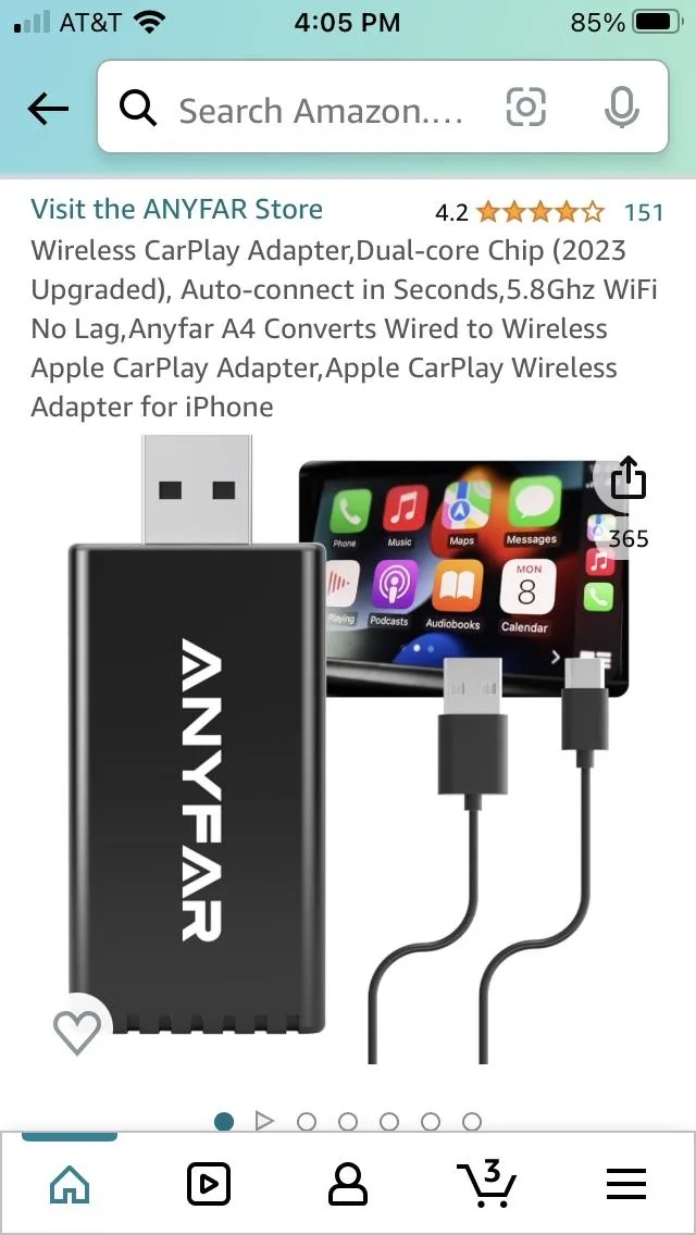

I’m right there with you. This is single-handedly the low point of my Maverick experience. I’ve said it before and I’ll say it now: my 2013 Volvo had a Bluetooth connection that didn’t drop once in 9 years. If CarPlay is the issue, I’ll go without it. It’s very frustrating. I’m considering purchasing one of the wireless CarPlay adapters so my stereo will quit guessing and by pass the factory Bluetooth.
Works great
Ford Maverick More bluetooth woes 539978C3-65B1-44EA-AE94-0A9C883AB113

I don’t have my mav yet, but I have tried a couple different wireless CarPlay dongles in my Prius. A lot of them are all the same internals, packaged a little different. We were having problems with the usb port in the Prius (never tried to get it warrantied) but the wireless CarPlay dongle seems to be working ok. It disconnects sometimes and reconnects right away, but amazon music has quirks. I’m not sure if it is the amazon music app or the wireless CarPlay. It does it on all of the CarPlay dongles we have tried, and I don’t remember trying it wired.

Hoping that this will let me utilize a couple of apps., one to play mp3's, and OSMand without having to connect my phone at all.
https://www.amazon.ca/gp/product/B0BB1T9P94/ref=ppx_yo_dt_b_asin_title_o00_s00?ie=UTF8&psc=1
