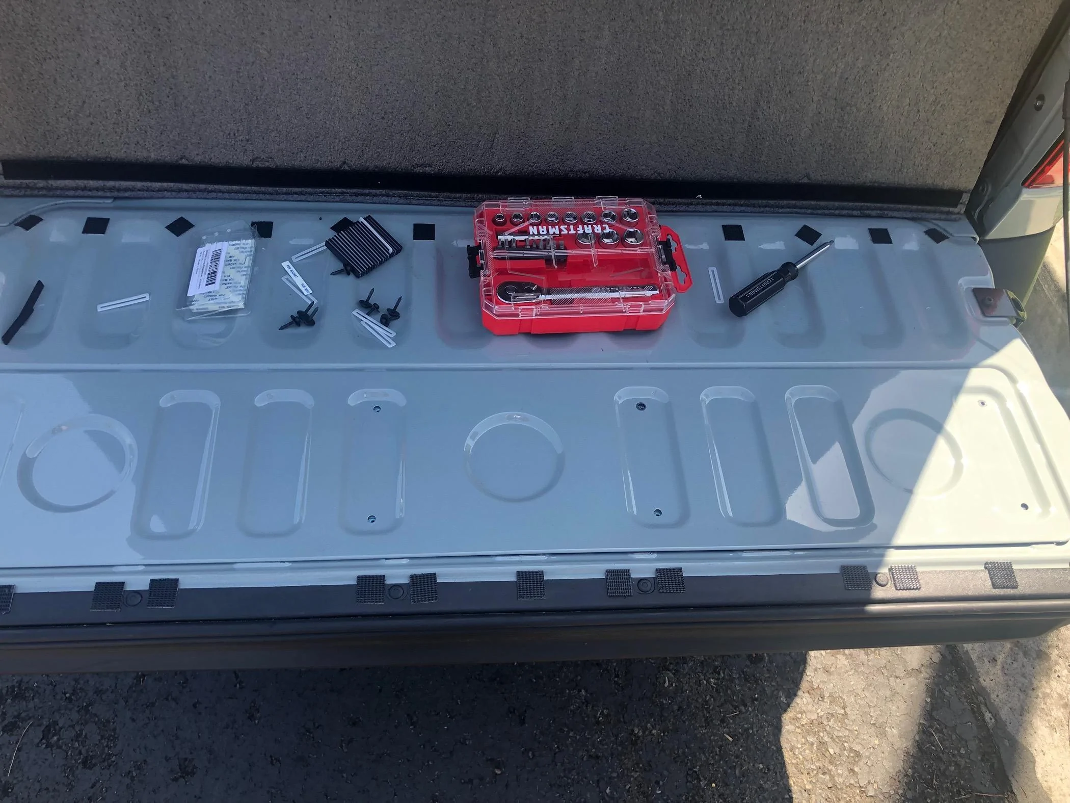

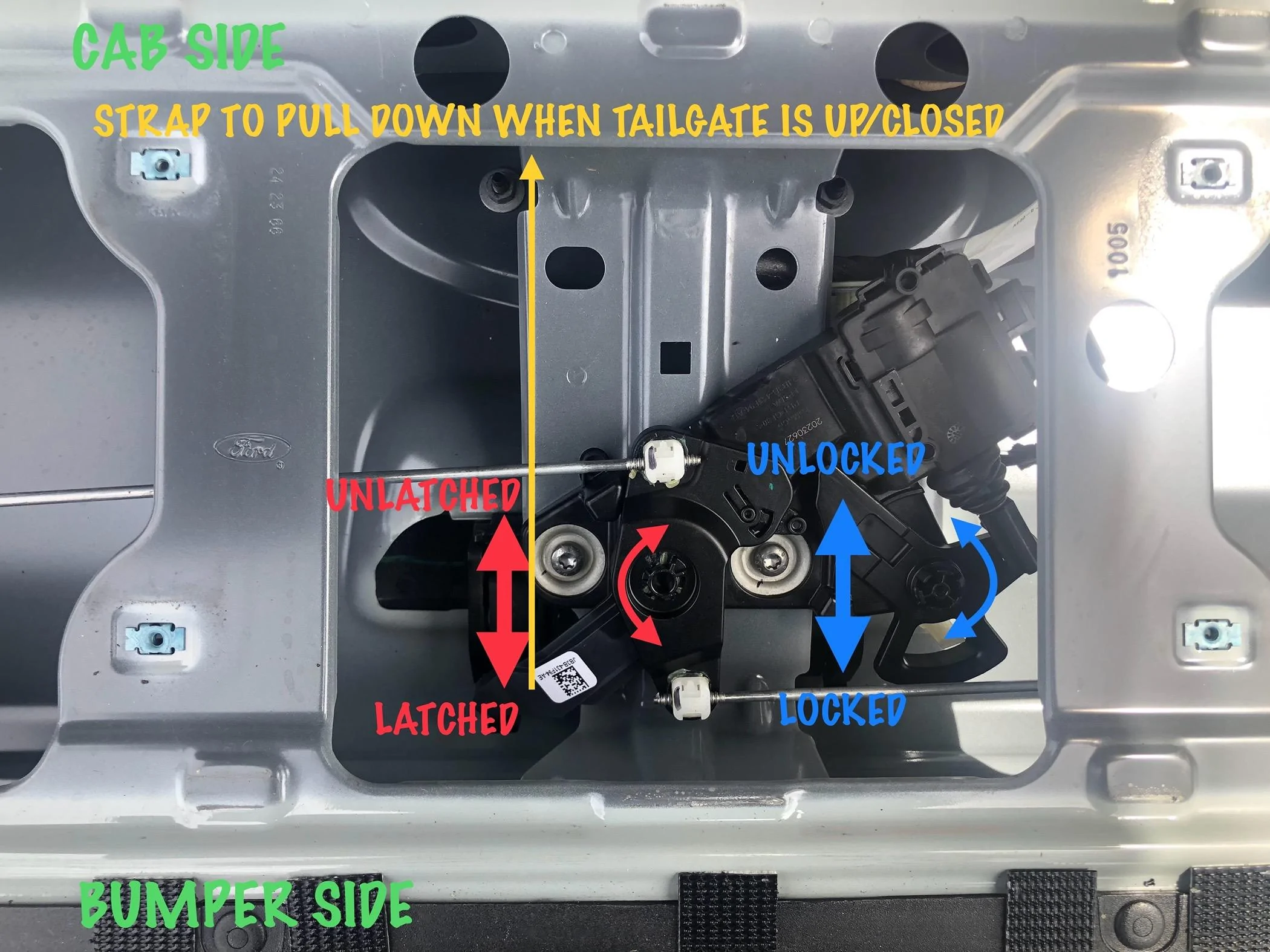

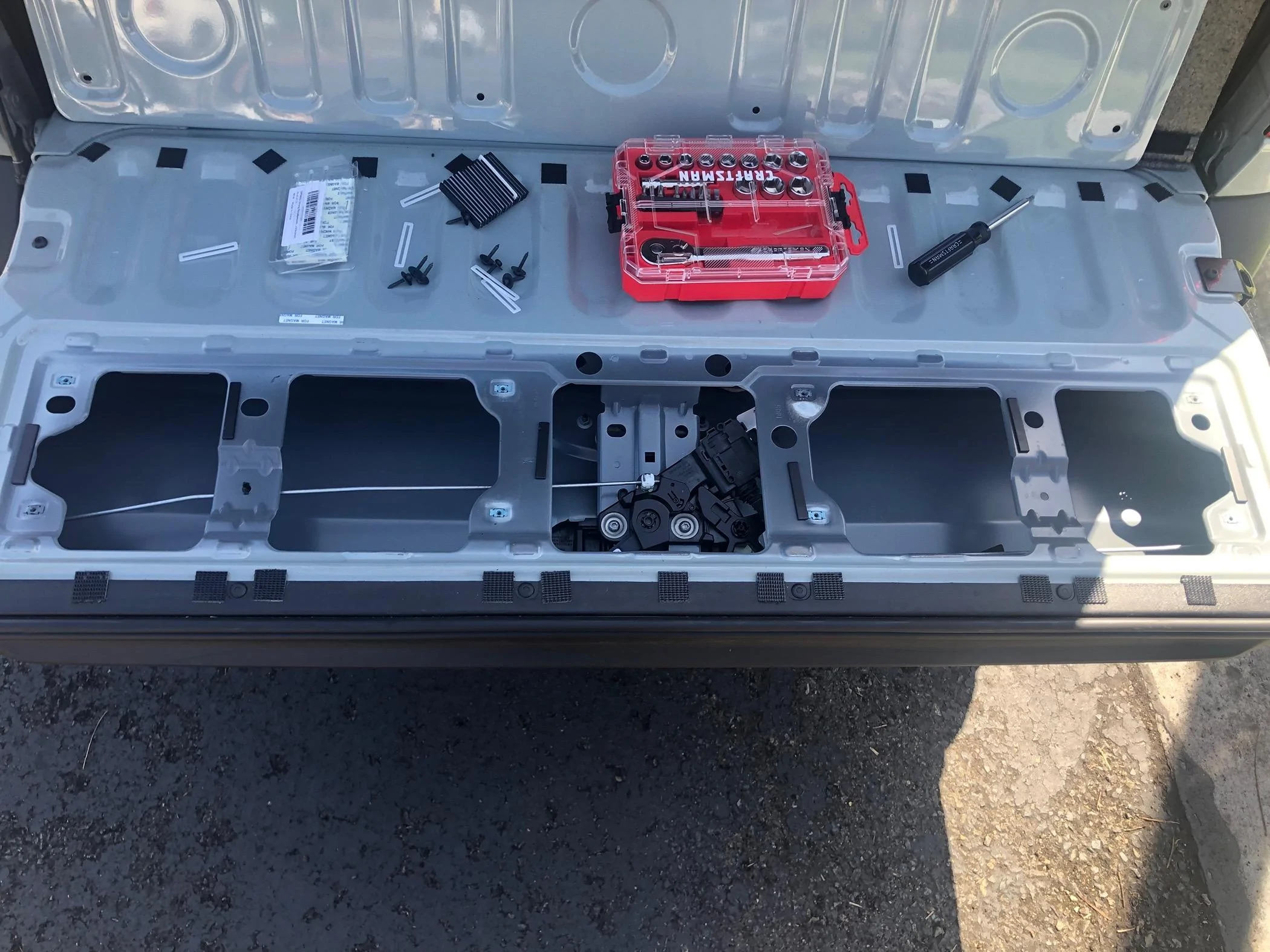

Was so curious that I took a peek on my lunch break.
GOOD NEWS:
  1. Interior unlatch seems totally feasible.
  2. Electronic tailgate release is probably doable.
  3. Lots of unused room in the tailgate.
BAD NEWS:
  1. Latch release mechanism is plastic and will probably fail at some point.
MY PLAN:
  1. Sandwich two small metal plates around latch release lever.
  2. Attach small webbing (looped) strap to pull on metal of release lever to pull downward when the tailgate is closed (or towards the cab when the tailgate is open).
  3. Drill a hole/slot in the removable tailgate cover.
  4. Grommet the edges and feed the strap through.
NOTES:
  1. Strap will normally be covered by my bed mat.
  2. The picture below shows the latching and locking mechanisms:
    1. Travel of LATCHING lever shown with straight RED arrow.
    2. Pivot point of LATCHING mechanism shown with curved RED arrow.
    3. Travel of LOCKING lever shown with straight BLUE arrow.
    4. Pivot point of LOCKING mechanism shown with curved BLUE arrow.
    5. Direction of new RELEASE STRAP PULL shown with YELLOW arrow.
    6. As pictured, the tailgate is LATCHED and UNLOCKED.

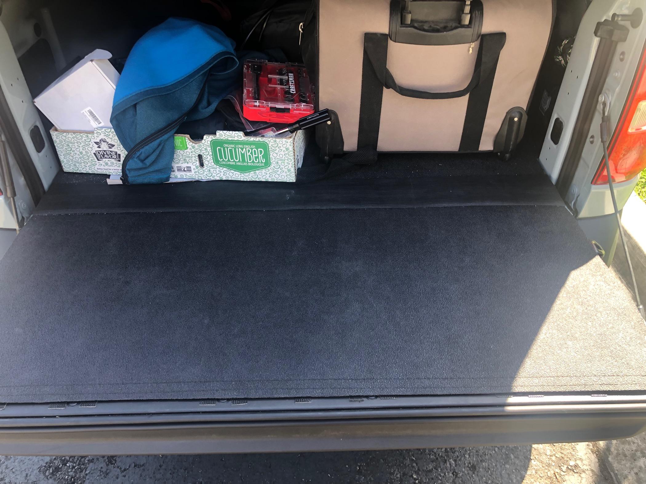

Quick update:
I change my approach and just installed neodymium bar magnets in between the tailgate cover (which I’ll refer to as the “hatch”) and the tailgate itself.
Ford Maverick Mod to Unlatch Tailgate From Inside? IMG_6036
As pictured the magnets were too strong and so I ended up removing two of the magnets (2nd away from each end). Even with four magnets the “hatch” is plenty secure and does not move. The hatch is still flush with the ta
Ford Maverick Mod to Unlatch Tailgate From Inside? IMG_6037
So for my use case, even if it was shut I could quickly pull of my (black Velcro’s) tailgate cover and the hatch and single unlatch the tailgate by hand.
Ford Maverick Mod to Unlatch Tailgate From Inside? IMG_6039
This mod definitely isn’t for everyone but just posting in case it’s helpful to someone.
Side note: I’ve read here on MTC that the tailgate was aluminum. It is most certainly steel.
