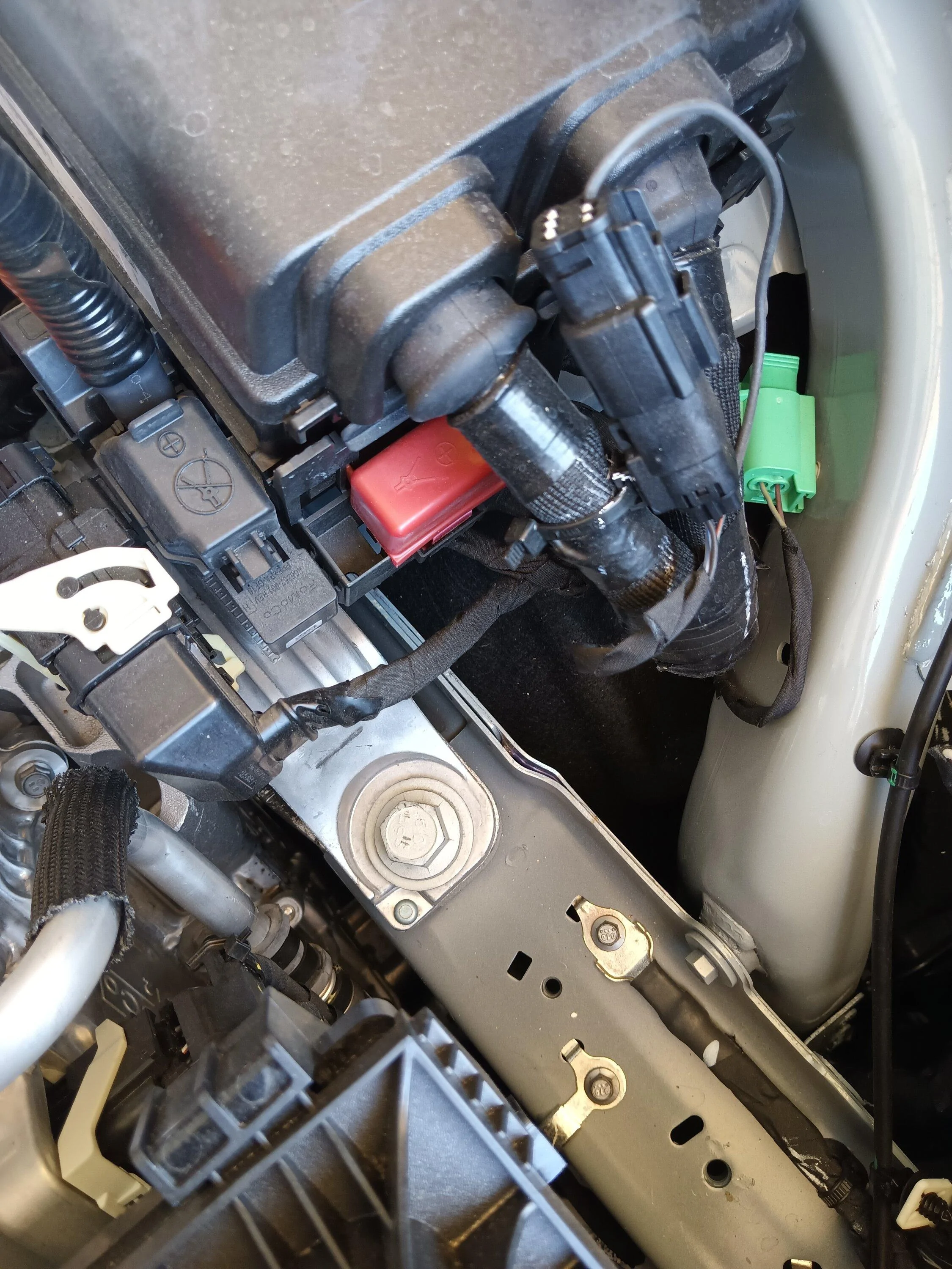

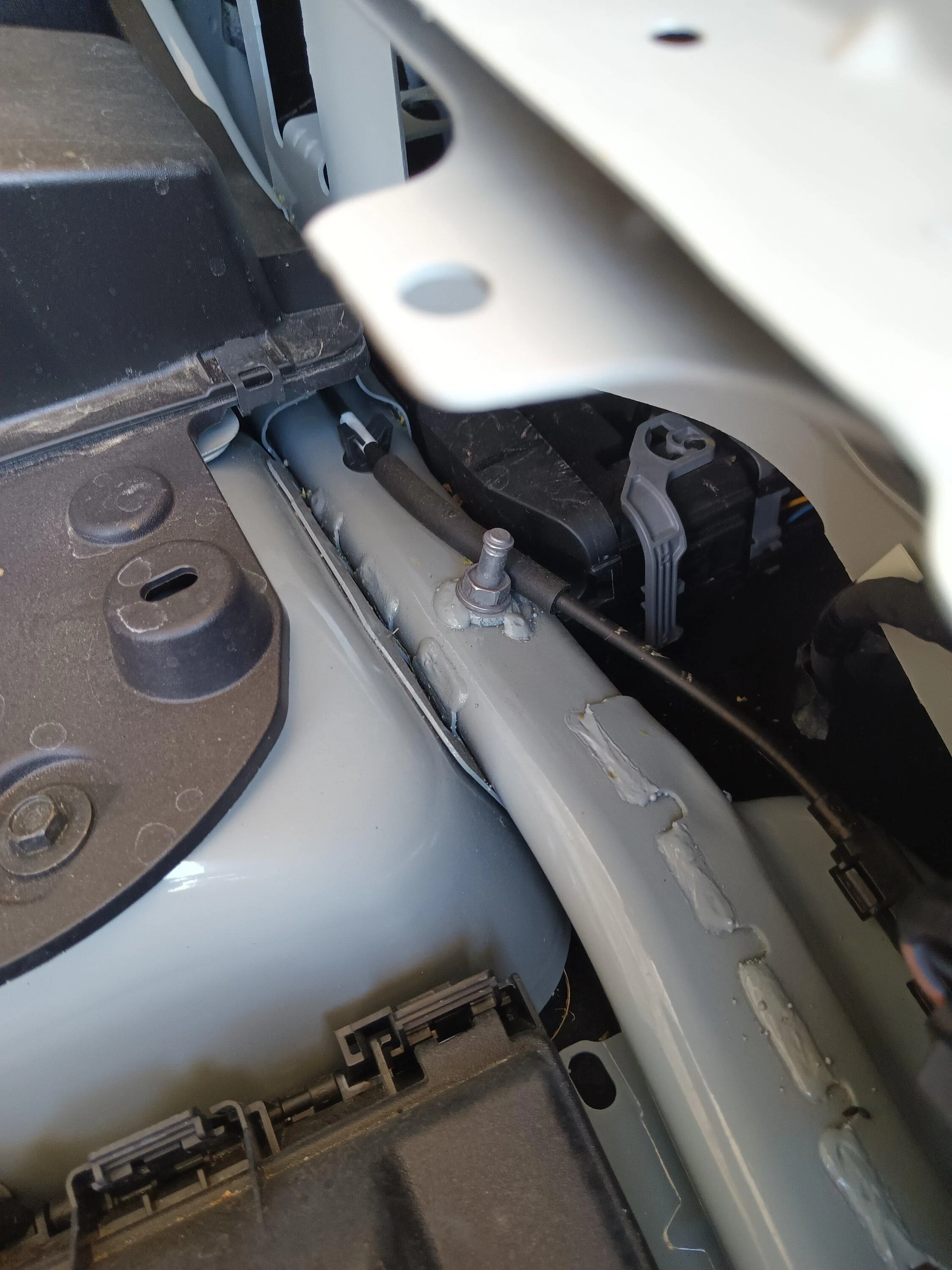

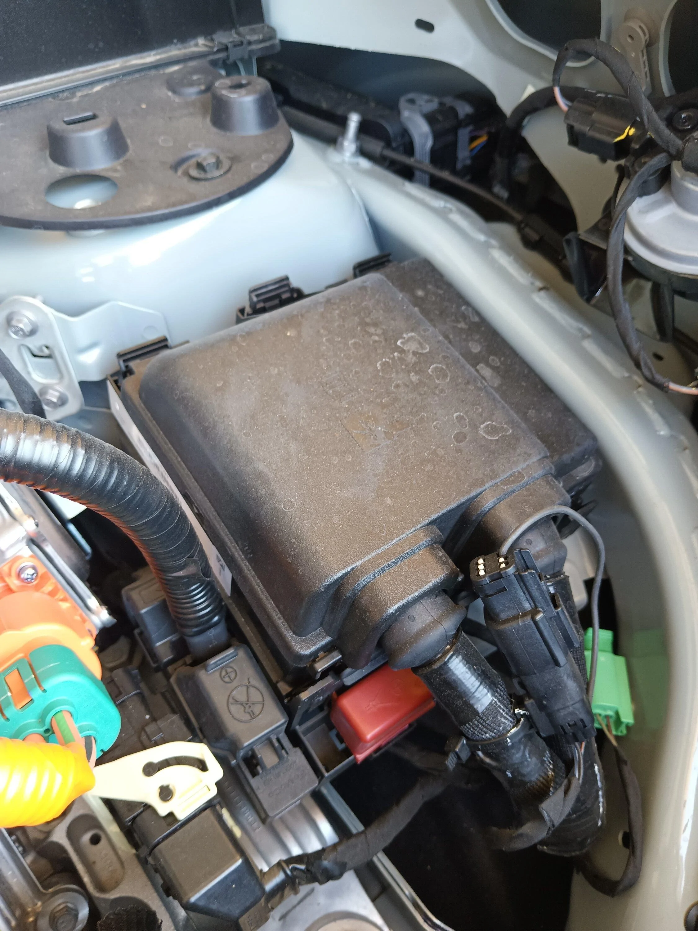

One is Red, the other is more neutral (bare silver)...
The first pic shows the red cover for the positive threaded post (the red cover tips forward for access)
The second picture shows the negative rust proof ground
The third picture shows both connection posts the red positive near bottom of picture and the ground near the top.

Don't connect anything directly to the battery. Doing so bypasses the BMS system, so the charge (and/or load, if you're connecting a dash cam or something like that) will NOT be seen by the BMS. This can lead to all sorts of obscure problems.
For tricky charging, you should DEFINITELY use the posts under the hood.
