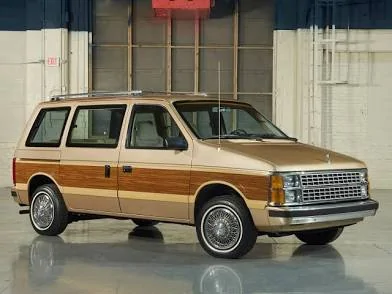

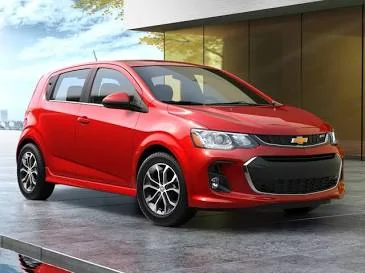

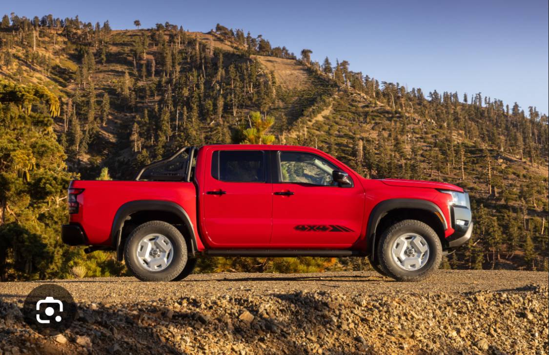

Only persons at under 35 psi may consider tire life poor. And no one is talking about 70 psi which is what it would require to wear out the center of these tires. 40 psi may make them last 5-10% longer and yields 5-10% more gas milage. Simple science.
Surely you don't think "one size fits all" do you?
What do all these vehicles below have in common? They all "recommend" inflation to 35 psi. Do you think they all drive the same? Are used the same? Weigh the same? Behave the same?
So why the same pressure?
It's a good "average" all around starting point that will suffice for a wide variety of conditions while being sub optimal for most conditions
Unless you, like most owners consider "set it and forget it" to be optimal for the driver's convenience.
