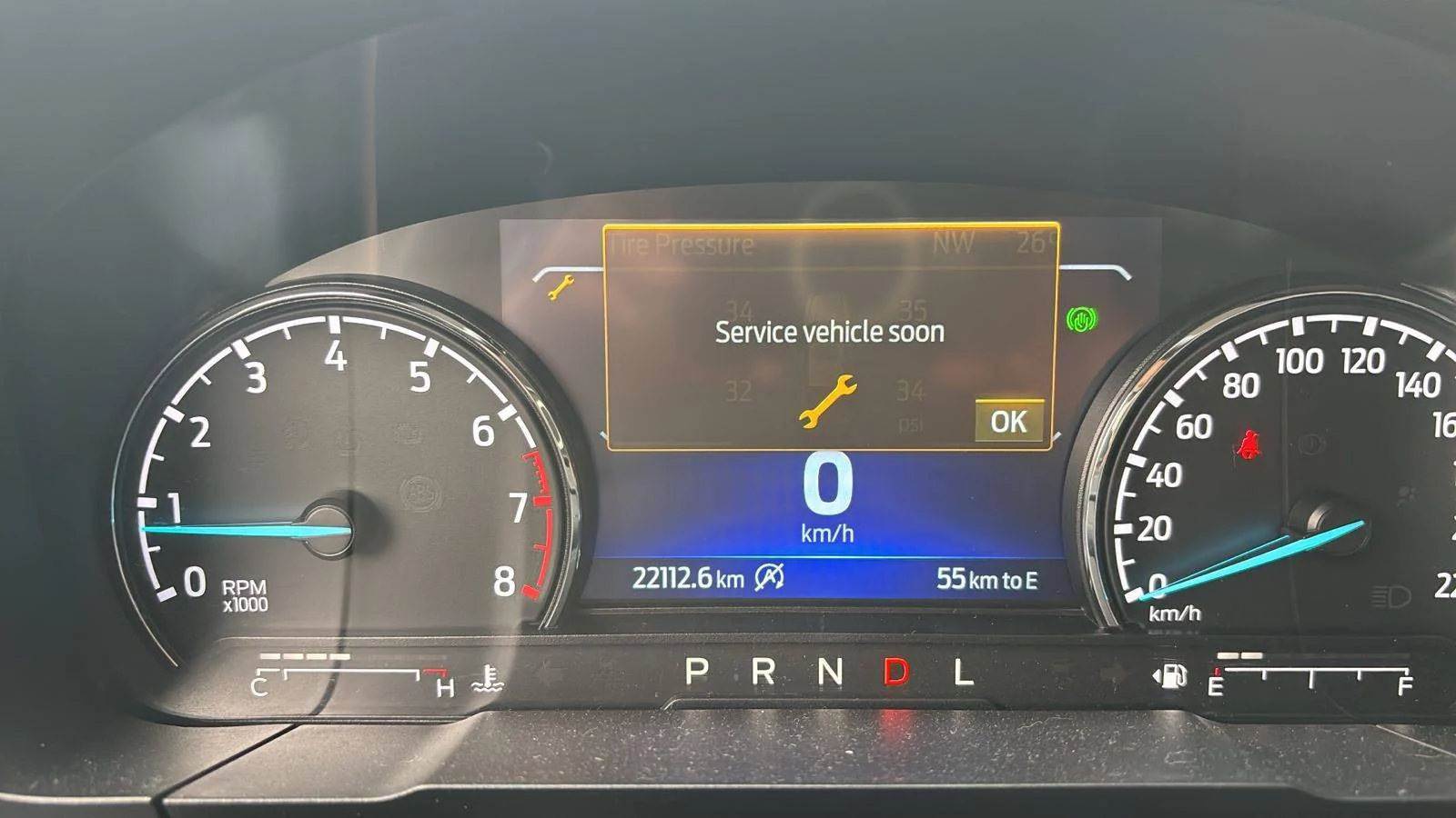

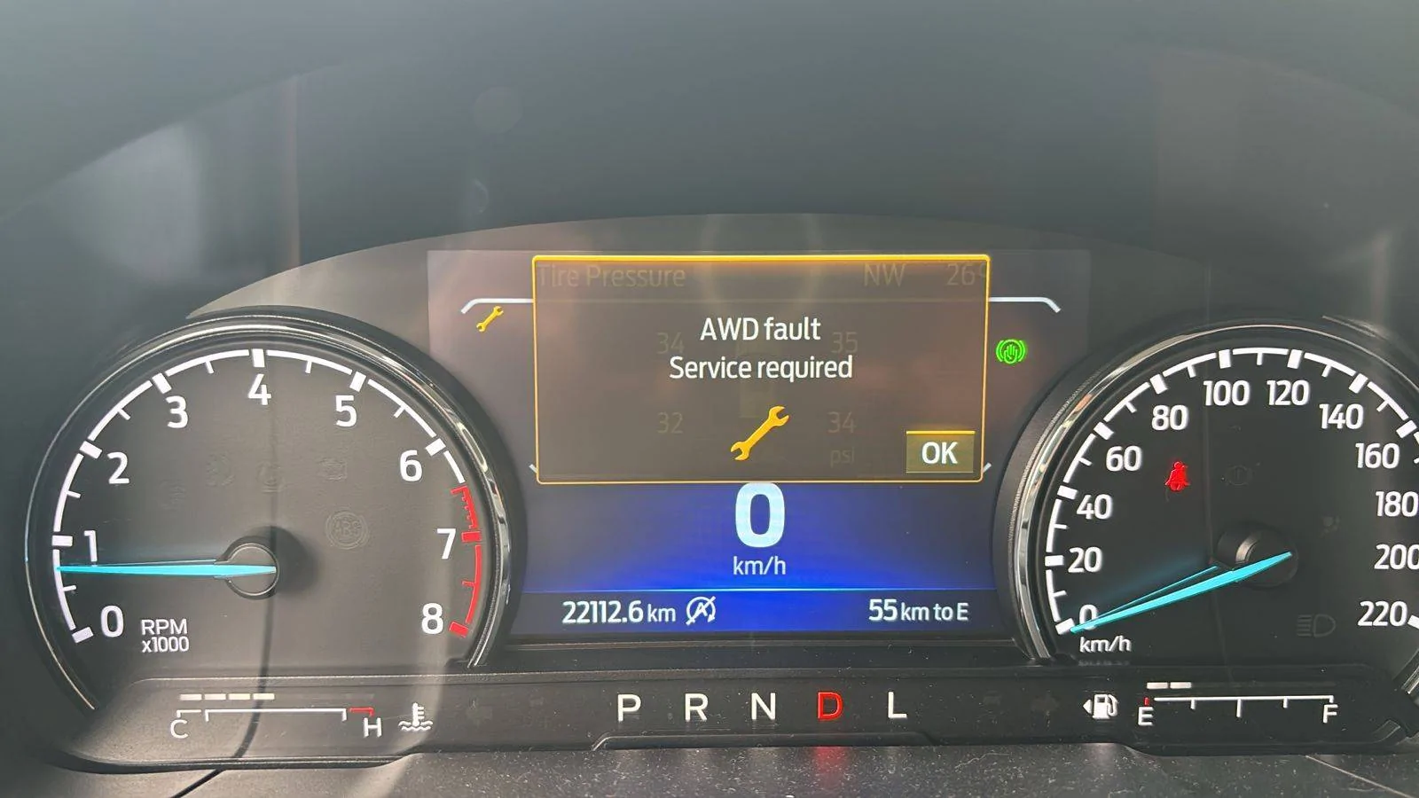

Hey everyone, I'm posting a video and some images of the error messages from my Ford Maverick 2022 FX4 2.0L EcoBoost. My truck only has less than 14,000 miles, but the other day when I started it, I heard a really loud, pulsating noise coming from what seems like the back—possibly the transmission or power transfer unit area. Shortly after, I got the all-wheel drive fault and service required alerts.
I've already taken it to the dealership and am waiting on their feedback, but I'm curious if anyone else has experienced something similar or has any insights on what might be causing this issue. Any help would be greatly appreciated!

The response #18 seemed to be a little different, the AWD starts making a noise as soon as I turn the key and once I start the car the AWD gets deactivated and I get the fault message and some others.
thanks
