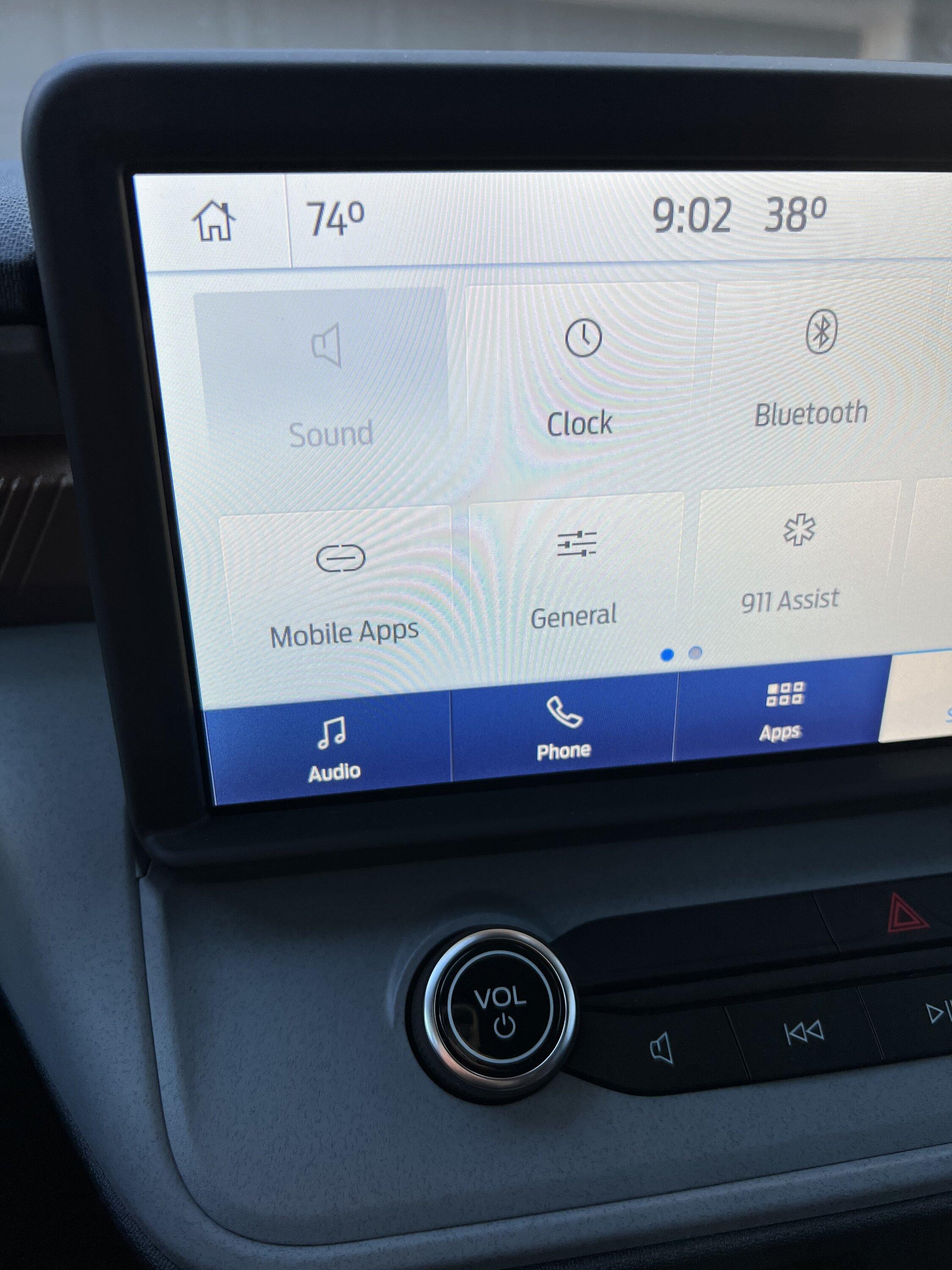

I connected my iPhone 13 via CarPlay for the first time last night and lost all audio. It’s even grayed out on the screen. Clicking on the power button doesn’t do anything. No steering controls work. BT audio doesn’t work. Radio doesn’t. No sound and no response from anything. The only sound that comes from the system is the beeps when you press something.
I tried resetting the radio with the power button + skip forward button holds. No luck.
I tried removing the phone both from BT and CP. no luck
And then randomly I was getting gas and it started working! At least the radio did. But just for that one trip. It seems to work 1/5 times.
I checked for software updates and connected wifi. I’m at a loss…
Anyone have this problem? Know a solution?
Sound is even disabled on the settings:

Sounds like you've tried all the basic troubleshooting steps, which points at a likely hardware issue, unfortunately. Couple other suggestions would be just to press the power button with the vehicle running to see if anything changes. Failing that, try a master reset of Sync 3.
Could always try disconnecting the 12V battery for 10 minutes, though that may or may not accomplish anything.
Sync 3 uses an APIM (Accessory Protocol Interface Module), which is the module that contains the touchscreen, and a separate ACM (Audio Control Module). It seems like the two aren't communicating for some reason. That's likely why the Sound settings are disabled. This would require disassembly of the vehicle to troubleshoot/reconnect/replace.
Unless, of course, anyone else has any suggestions that you haven't tried yet.
Note that the description of hardware above only applies to Sync 3, which requires Lariat with Luxury Package.
I’ve tried the power button and shutdown (holding power and forward for 5s) but I haven’t tried the factory reset or that sync 3 trick. Is that what you mean? Going into the settings where there’s a reset to factory option?
Yes, a Master Reset.
The other suggestion is that, with the vehicle running, simply press the power button once and confirm that the Sound settings icon is still grayed out and sound doesn't play. Sync 3 never really turns off when the vehicle is running. Instead, pressing the power button turns audio on/off. The only way to turn the screen off is to press the button below the screen of a rectangle with a slash through it.
When the vehicle is off, pressing that same power button turns the whole system on and off instead of just the audio.

Thanks, I’ll give it a shot. Yeah I tried the power button and it didn’t do anything once the problem started. It seems like I have to hit the power to turn it on during or right before starting the engine - still trying to figure it out! But I’m taking it in to the dealer when I can. It’s only three weeks old…
