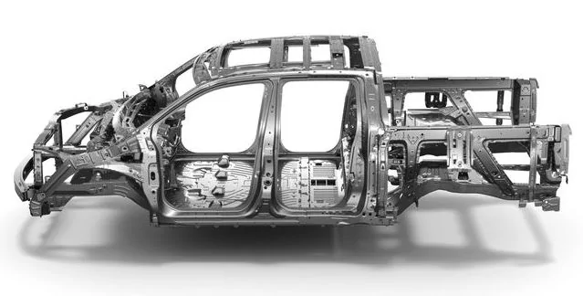

Maverick not truly a Unibody?

If they didn't do that they couldn't replace body panels after a minor accident.

Sooooooo….this raises the potential for dually Maverick mods? o_O
*Insert “why would you do that” memes*

And then there is the monocoque chassis, which consist of a center tub (bolted, welded or rivet construction) that houses the humans….to that are bolted front and rear clips that attach to the tub, the front clip is motor and suspension, the rear clip is rear suspension and differential. The fenders bolt to the clips while the center tub has minimal body work other than the pre skinned doors which are hung from the tub…..the old XKE Jaguars are a beautiful example of this
