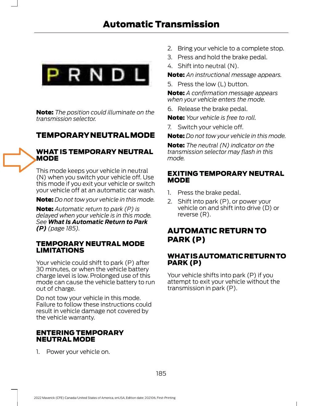

Hi, Has someone taken the Maverick to an automatic carwash. My question is do you just put it in Neutral or do you have to press the L and turn it off as the manual says?
