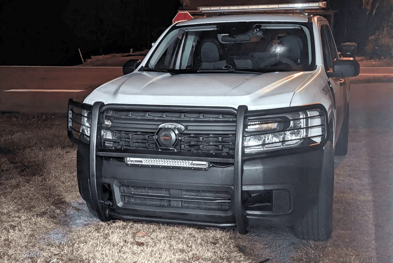

I successfully installed what I believe may be the only Ford Maverick Grille Guard / Pushbar / whatever you want to call it.
I installed it back in October of 23 and drove it around a lot for testing but forgot to post about it.
As most of you know, the chassis for the Bronco Sport is very similar to the Maverick
So I took the risk and purchased the TrailFX - Standard Grille Guard from CARID for the Bronco Sport.
I've got a '22 XLT with the EcoBoost, so I purchased the grille guard for the '22.
I have the tow hooks, and those WILL need to be removed for this installation (unless you can figure a work-around)
The first steps to this install are removing the front bumper. This process will vary depending on model year, trim, & engine so I won't go into it here.
What I will discuss in this post is the modifications I had to make to the Grille Guard to make it work:

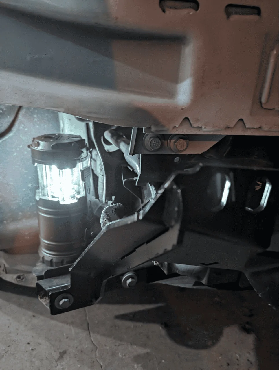

The bulk of the Grille Guard is attached to the frame with three mounting points: two at the top & one at the bottom.
On the Bronco Sport, the bottom attachment point is about 6"-7" further-back than it is on the Maverick
I've done my best to show that in the first photo by attaching the mounting bracket to the bottom mounting point.

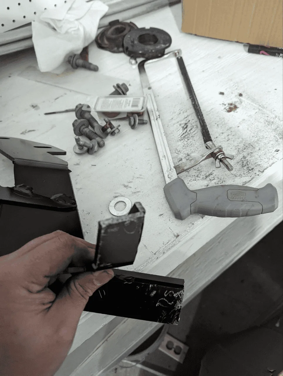

So to rectify the issue with the maverick mounting points being too shallow, I took a hacksaw to the mounting brackets (photo 2).
As I mentioned above, the only other big modification I needed to make was the tow hooks - unfortunately I had to remove those. They actually use the same mount points that the grille guard uses.
I'm sure someone with more metalworking tools could figure a way to keep the hooks but for me removing them was easier.
Like the tow hooks, the mounting brackets will insert through the holes in the front bumper, but you'll find that it's much easier if you open them up a little bit; I used an oscillating multitool for that.
The third photo is the final photo showing the finished installation. Please note I did spray the grille guard with a few coats of rustoleum bedliner, and obviously the PA & the LED Light bar aren't included with the grille guard - I just installed those the same day.

Walk me through what’s going on with the bumper. Did you rap it? Plasty dip it, is it a separate mold? I really like the look and would like to hear what you did and how it’s been.
