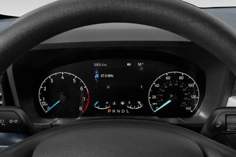

I’ve been browsing the parts department on the ford website and stumbled upon the cluster for the ford maverick and it showed 2 different types, 1 that was analog ($525)and another one that was I believe digital($625), is their a possibility to upgrade this? I’ve seen people on here put in different clusters but also have some issues with like the gas gauge not reading.
I think this was be a pretty sweet upgrade.

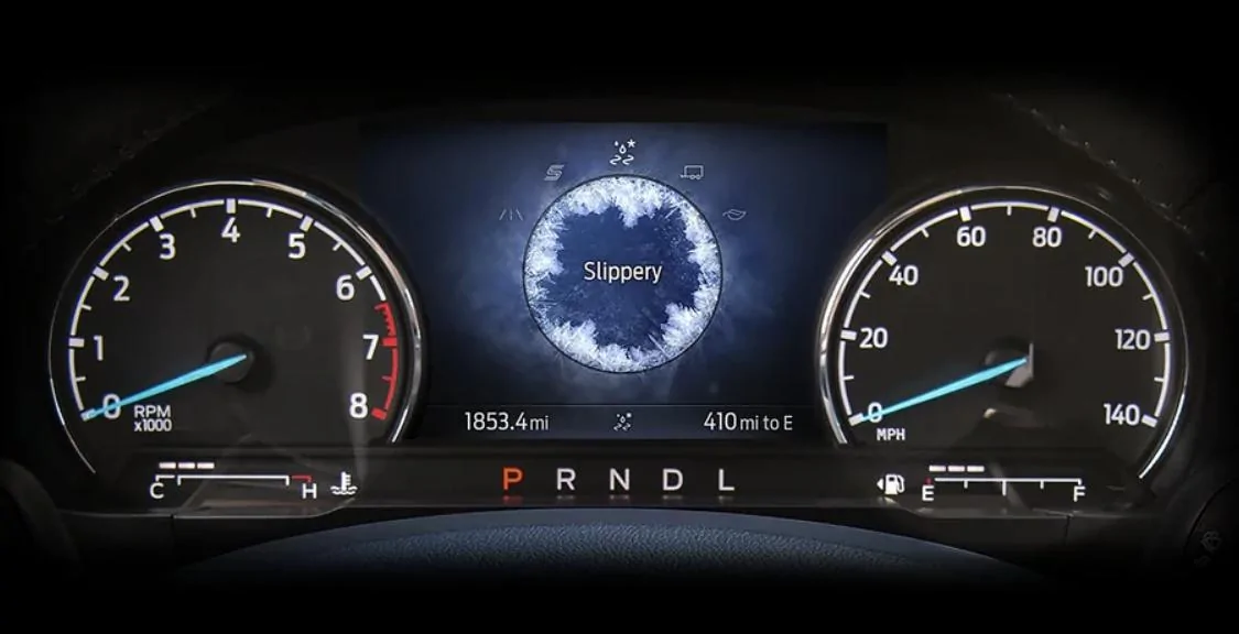

I believe the one they’re having problems with the fuel gauge is when they swap in a full digital Edge cluster.

That 2nd one is the Lariat cluster. Not sure if its plug and play with the XL or not.
If it’s plug in play I’d do it but that’s a $600 gamble 😂
Not an issue anymore, that particular person had not configured their cluster correctly yet when that was stated.
You can either load your as-built to the new cluster or you can configure it through forscan for 1 sender and for whatever fuel tank capacity you have.
Source: I have a fully working Escape digital cluster. My post history should bring you to relevant threads on this forum if you are interested in this mod.

Yeah what he said
My Escape cluster is patiently waiting the truck’s arrival
Already programmed with as built data
