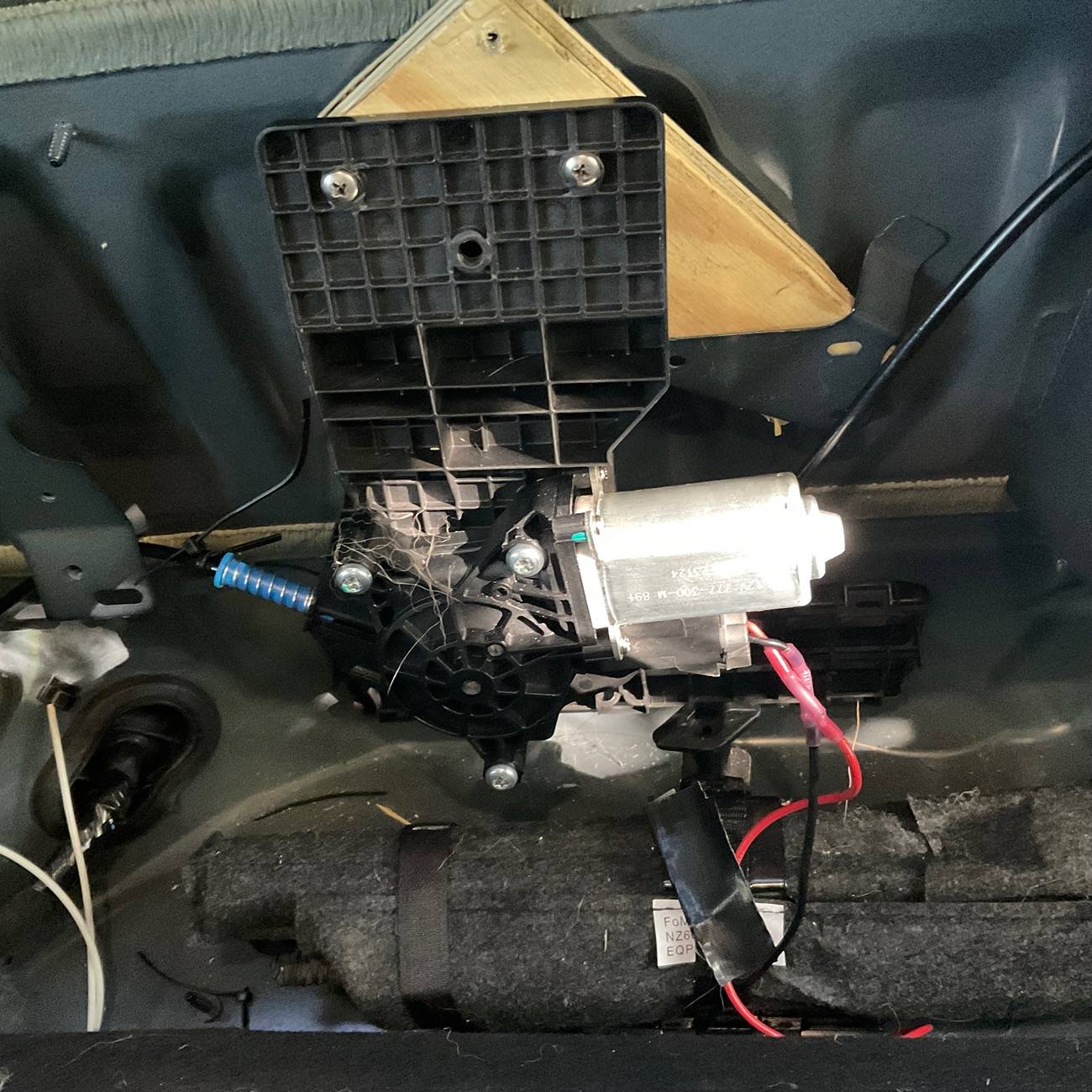

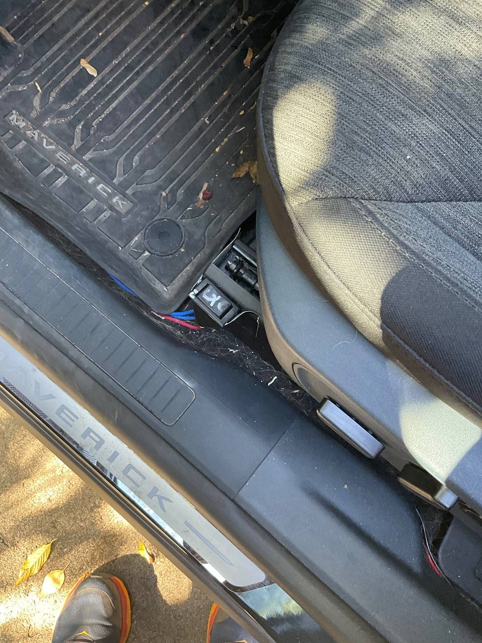

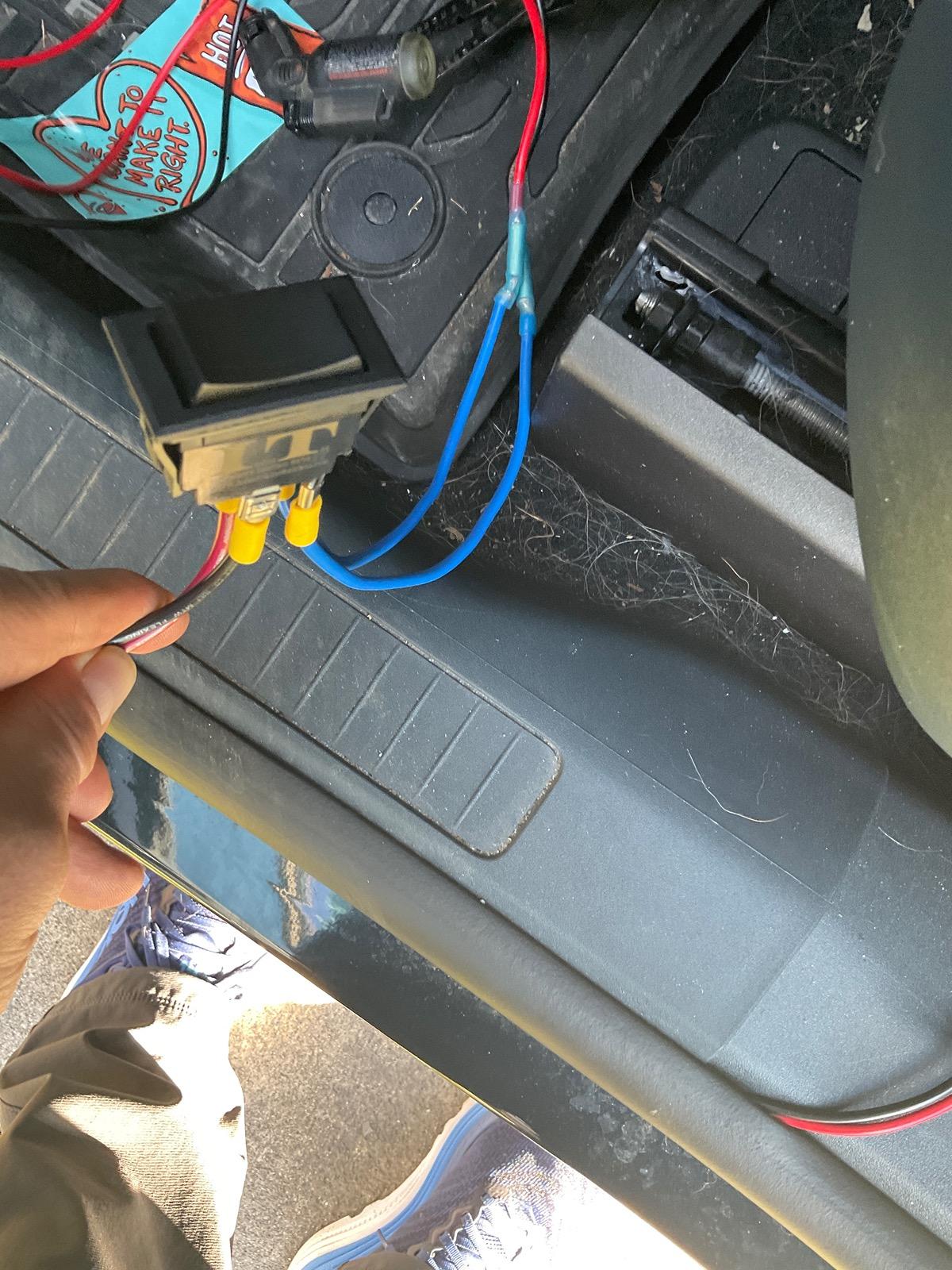

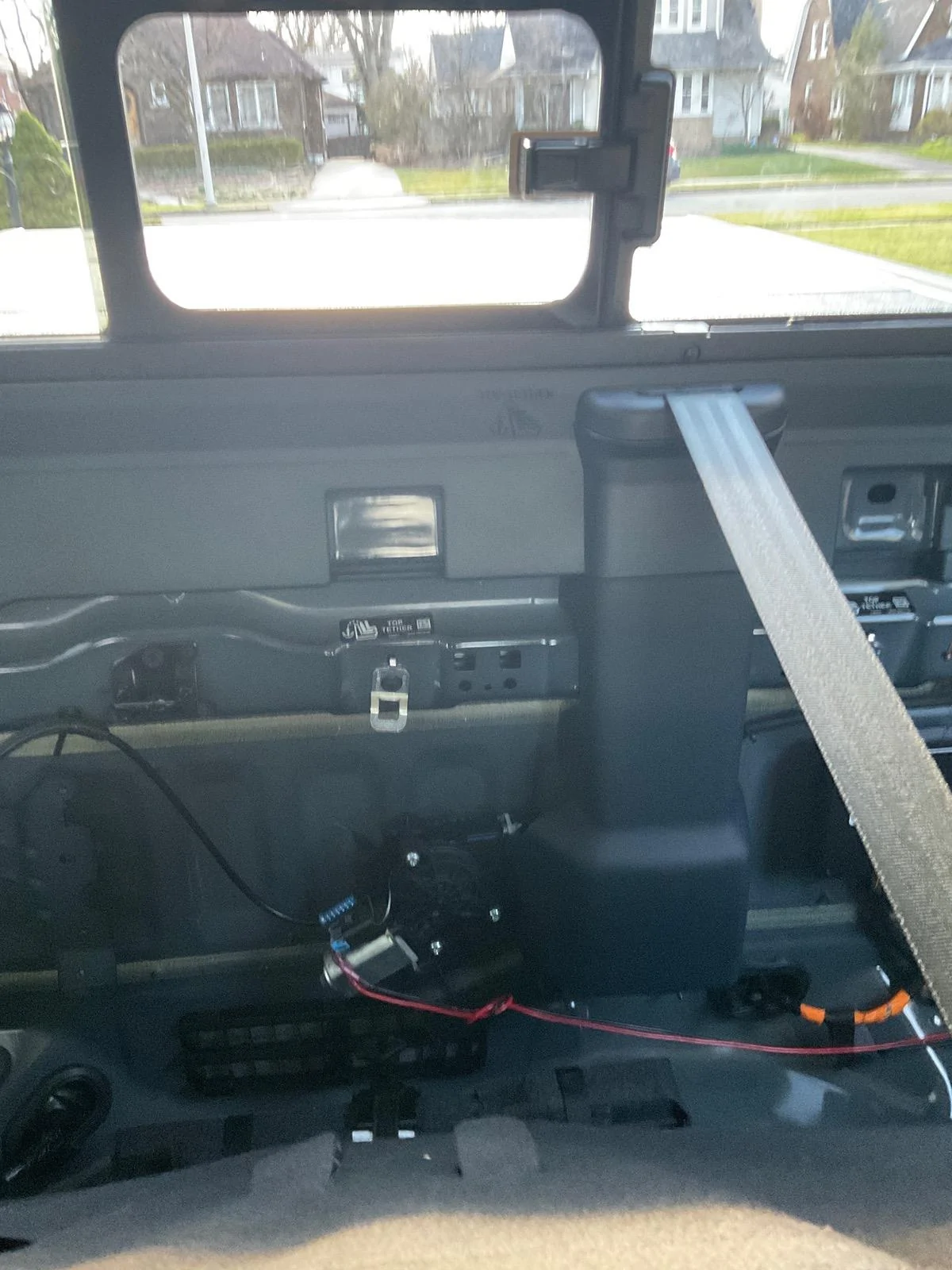

Here are a couple of pics on install. Mounting of switch is temporary but not urgent to run to new location. I just reach down and activate.
switch is 6 pin rocker, motor stops on release, direction using rocker. The F150 motor sorry don’t have number, but I bought ā€usedā€ on Amazon.
i just removed the latch from sliding window Cables secure the slider.
cables on the motor are spring loaded, make sure the stay taunt. 2 cable are different length I used shorter cable as is, longer cable was cut along with the sleeve. I soldered the wire before cutting to stop fraying . I used universal xtra small cable end…from throttle kit to use on cable end going into slider window frame.
motor is behind the seat so scrap plywood was wedge in the vacant OEM mount….it works!
switch in held by gorilla tape, again was temporary, but not on top 10 list of things to do.
this setup has worked all summer it is proven to work.
