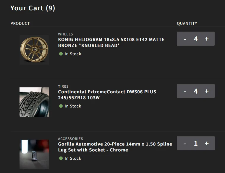

Thanks for doing a lot of the leg work. I spent some time this week also figuring out what to do about tires. Debated between swapping in some 245/50R19 (looking at the Vredestein Ultrac Pro @ $199/each), slightly larger 235/50R19 (Goodyear F1 Asym 6 @ $253/each), or size down to 18" wheels. Ended up deciding to move down to 18" for the added comfort of a taller sidewall, and because I felt with the 19" dinner plates it had a bit too much of a rubber band look.
Decided to get a set of bronze Konig Hyperspecs (shout out to America's Tire for price matching a random website that was about $50 cheaper a wheel compared to everywhere else). Wanted to wrap it in 245/55R18, but unfortunately nobody makes a summer tire in that size. Best would have been the Conti DWS06 Plus, but it didn't hold up all that well when autox'ing that tire in my Volvo. Thus, went with a slightly narrower (and taller) 235/60R18, which counter-intuitively had more summer options. Narrowed it down to the Pilot Sport 4 SUV @ $247/each, or the Goodyear F1 Asym 6 @ $245. Ultimately decided on the latter due to the extra tread life (20K mile warranty vs 30K miles warranty) and because it's newer tech (PS4s are getting a little long in the tooth since they're about 10 years old now while the Asym 6 has been out for less than a year).

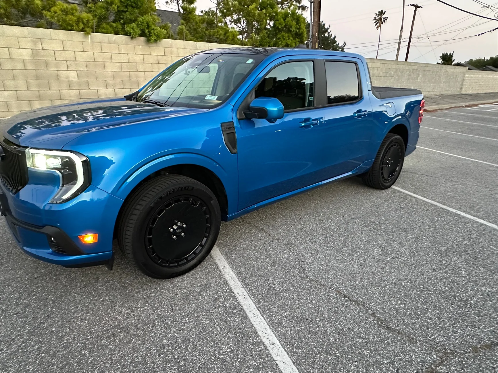

I just put on a set of Michelin Pilot Sport 4 SUV 245/50R19 on my Lobo with the turbo fan wheels. Summer tire 220 tread ware. I've run 2 autocross events this year in my area. I have to figure out how to drive the truck now that I have way better tires on it. It track straight as an arrow on the highways. I can feel the better grip on off ramps and on ramps.

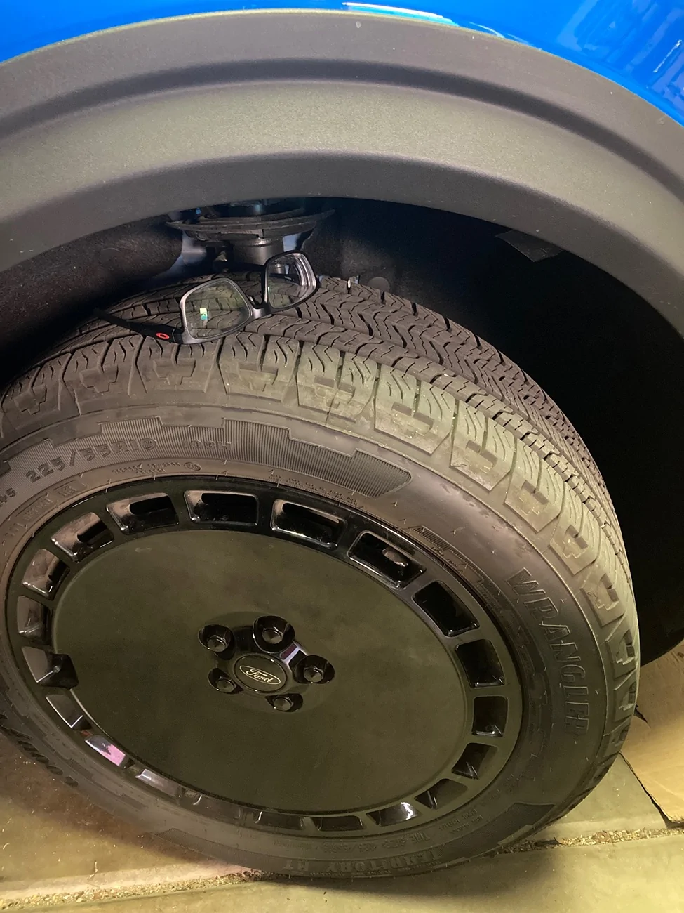

Would it be possible to post a pic of your new tire? Here is my OEM Wrangler:
