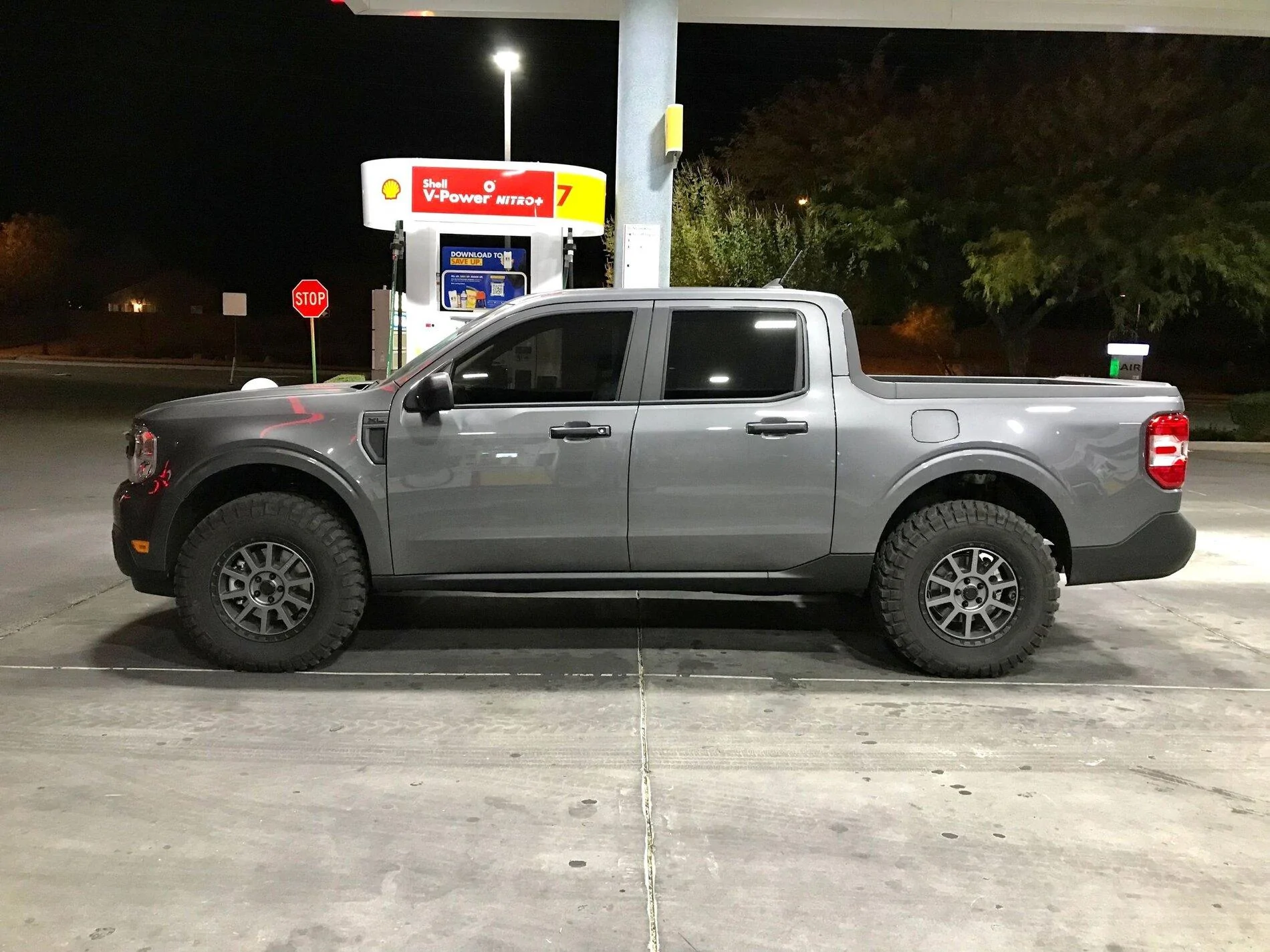

Finally got tires, BFGoodrich KO3 in 245/70/R17 with a 2” level/lift from flatout suspension (and Corolla sway bar links - see above post) on a 2022 Hybrid for anyone looking to do the same. No tire rubbing, everything seems good so far. CV axels replaced around 40k miles (started happening after i got my lift last year, Ford replaced under warranty at Schicker Ford in St. Louis where I purchased the truck new).

truck looks great. how long have you had the lift? I currently have lowered Mav. but have been thinking about going this route.

About one year so far
