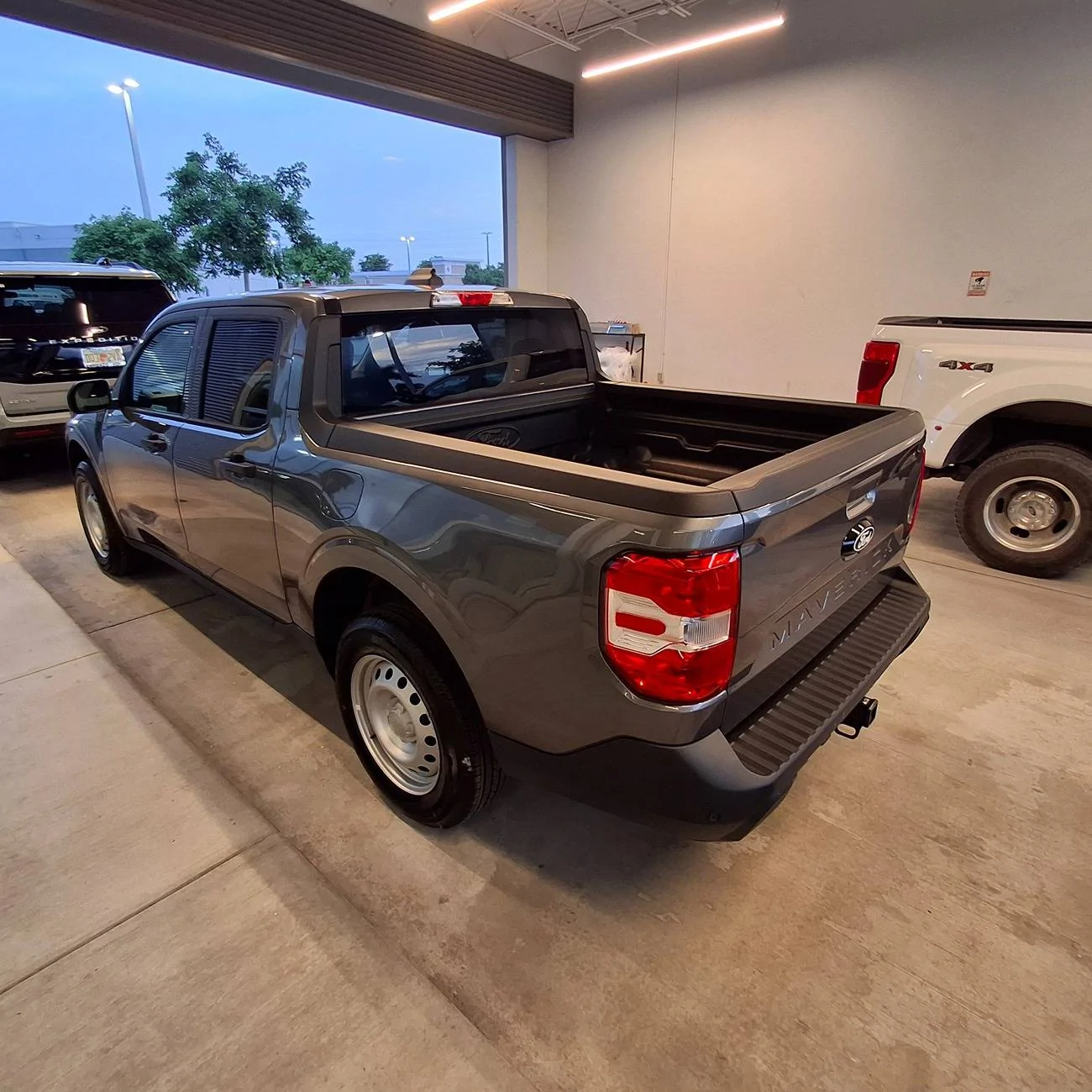

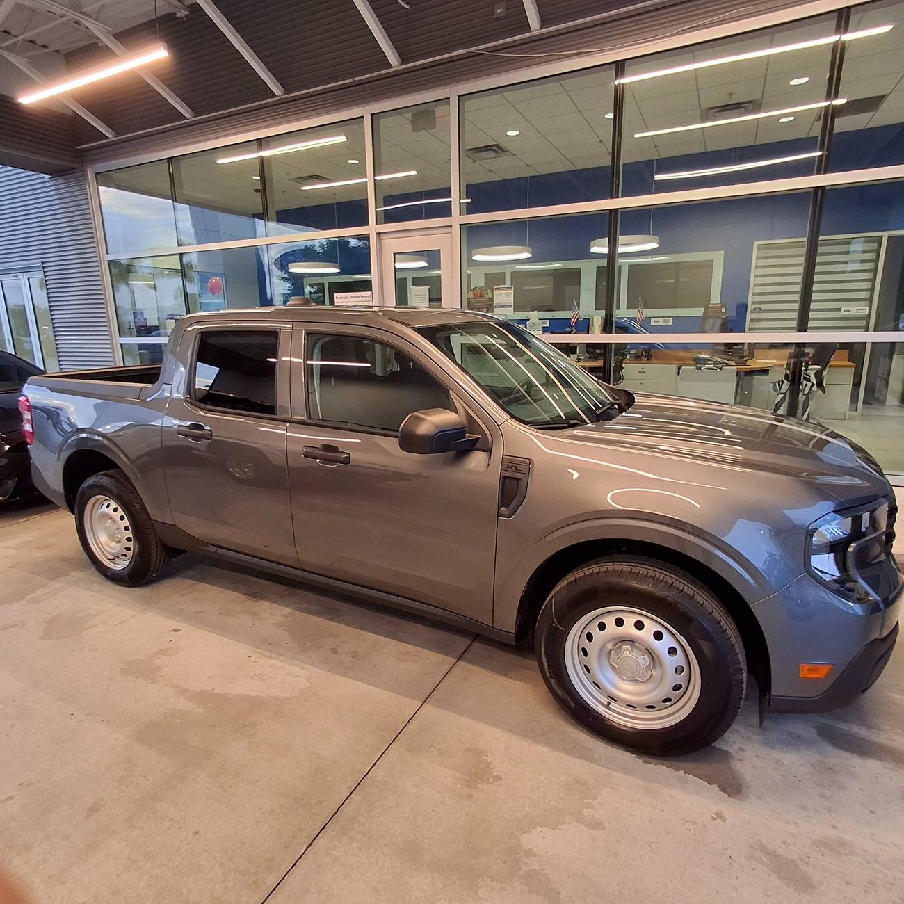

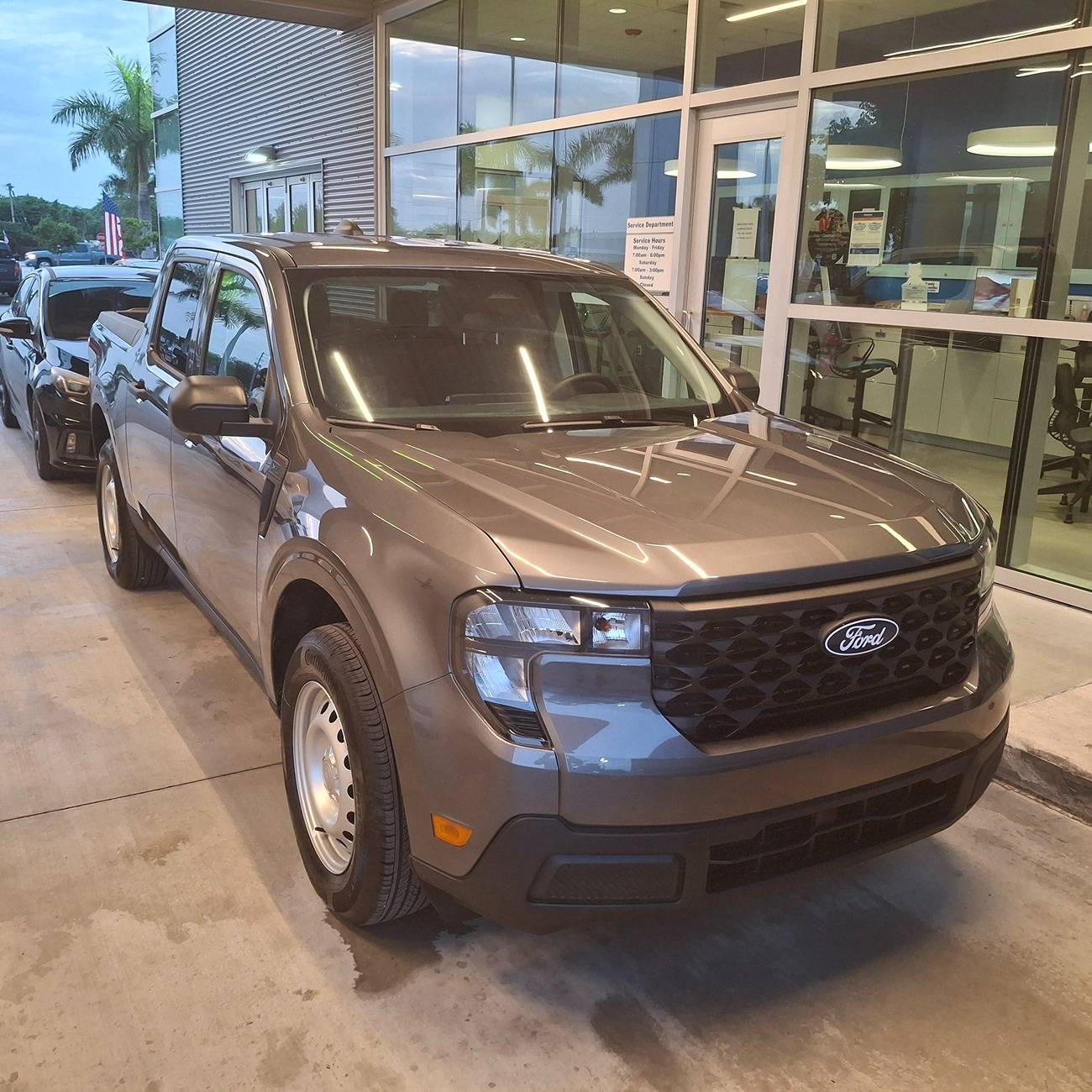

Most Suspesion Kits you level by raising or lowering the overall truck. Ive seen a couple where you just only lift the front 1 inch. Has anybody seen or heard of a kit that only lowers the rear so it levels out?

Leveling is weird on a truck. The rear suspension is set up to take a load without squatting, while SUVs and cars do not.

Some people in Facebook groups said they used stock rear springs from an Escape. The Maverick is based on the Escape, and the Escape is level, but you may not be able to haul as much weight in the bed.
As far as aftermarket rear-leveling kits, none exist.
