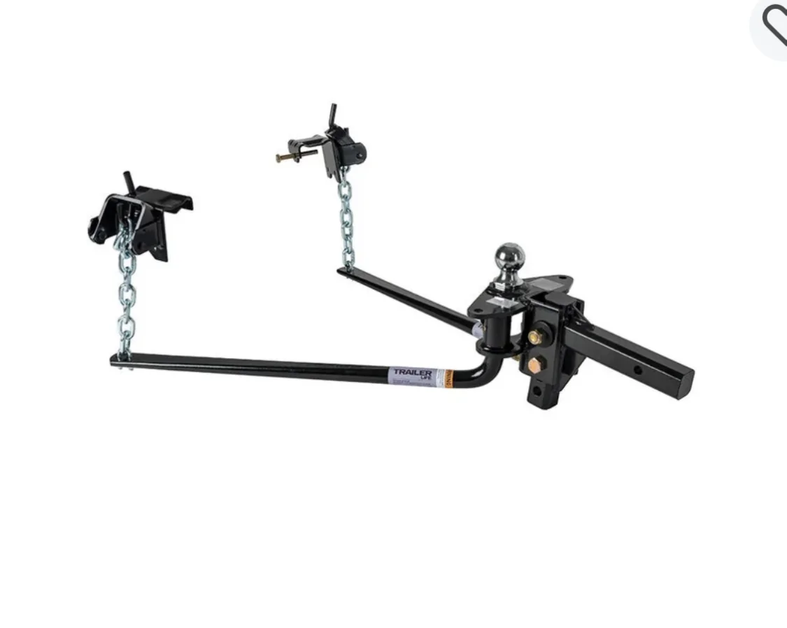

I am circling back around in consideration of WDH, because of a weird-ish trailer I am considering. Weird-ish because it's a long bugger with lots of moment arm, and also when empty has a low tongue weight, like 250lb... which isn't quite 10%... Now we might say fine, just load it front heavy, but as far as can determine, the fresh tank is ahead of the axle and the black tank is behind...
This means that "dry" camping will tend to shift 200lb from in front to behind. Also a consideration is that peak season camping, I've seen it a few times that when everyone tries to dump and leave on a Sunday or holiday Monday, the site has the black dump back up, needing pumping, or mayhap they added more sites than they had leach field for or something. So you might have arrived with finely balanced weighting, but now you gotta leave 200lb out.
So pondering if WDH do anything for "strapping the weight down" when tongue is getting lighter than intended. They are supposed in the main to help with sway, which is your big concern with low tongue weight.
Only considering this problem because the trailer has a really nice layout for me, and is cheapish. Also because a lot of trailers have different problems, like dry weight is damn close to 400lb on the tongue and there's not seeming to be much room in the back to stash stuff. Or they only have a few hundred pounds CCC, like 300-500. Was one that seemed great, 2700lb, but then it had 3000lb axles, where the hell do you get those even? So if it's not one thing it's another.
So really, just pondering if WDH might be good to involve on this prospective unit, as easier solution than solving other problem matchups.
Though I just had an interesting thought, if stuck hauling black, maybe take spare off back of trailer, and off mav, and ratchet strap by them in a "trailer tongue sandwich" to the tongue of the trailer. Though a bit of a pain in the ass.

It's not clear whether there's a question above...
Some weight distribution hitches help control trailer sway because (in addition to transferring load to the tow vehicles front axle/tires) they have an additional or optional sway control feature which is generally some type of adjustable friction bar mounted to a 2nd small ball or pivot.
If your trailer attains a rear weight bias over time and unloads the ball too much, just move some weight forward.
Good luck...
