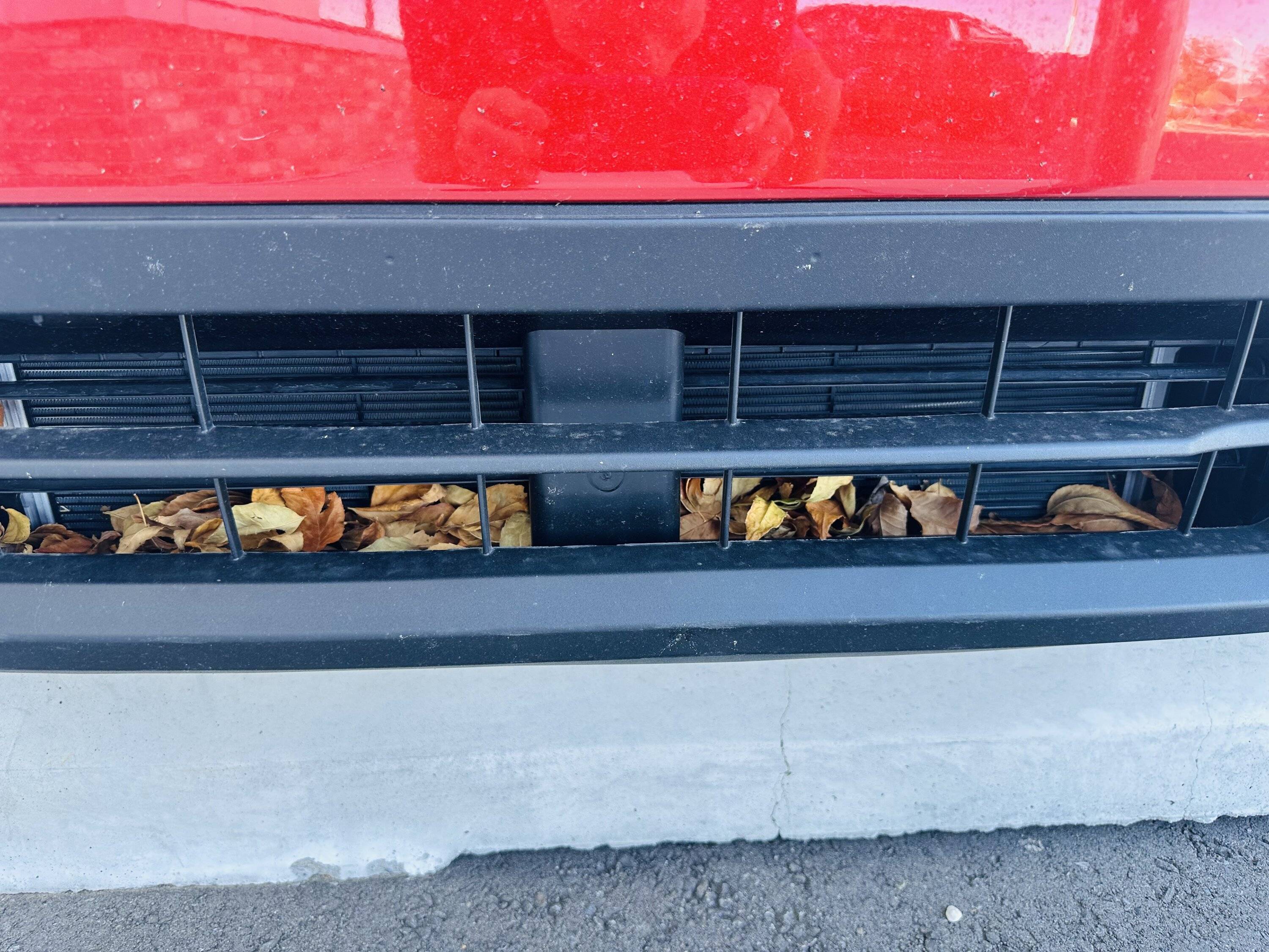

The leaves are falling but why are they collecting in the front lower cowling of my Mav , what a pain to try and remove !

Hmmm. A strong wet/dry vac should make short work of this.

I have a screen over my grille openings. Keeps leaves, pine needles, grass, larger pollen and bugs out of the condenser and intercooler.

That’s exactly what I’ve been looking for Turbobill! Do you have pics or brand name of product? Thanks.

I cut hardware store black screen and attached it with black tie wraps to the grille bars. I'll get a pic tomorrow.
