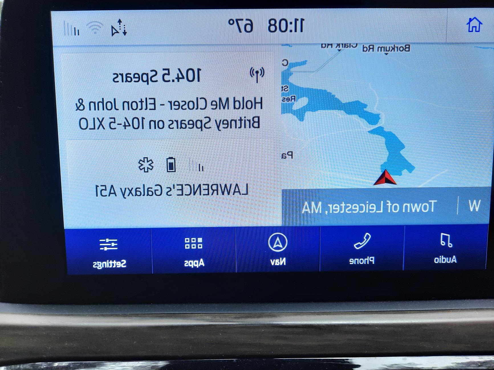

Have Escape (much of Maverick comes over from the Escape) and although it has never gone blank, did have it go to a mirror image. Like others said, goes away after the car is off for a period of time. Happened only once in 60,000+ miles.
