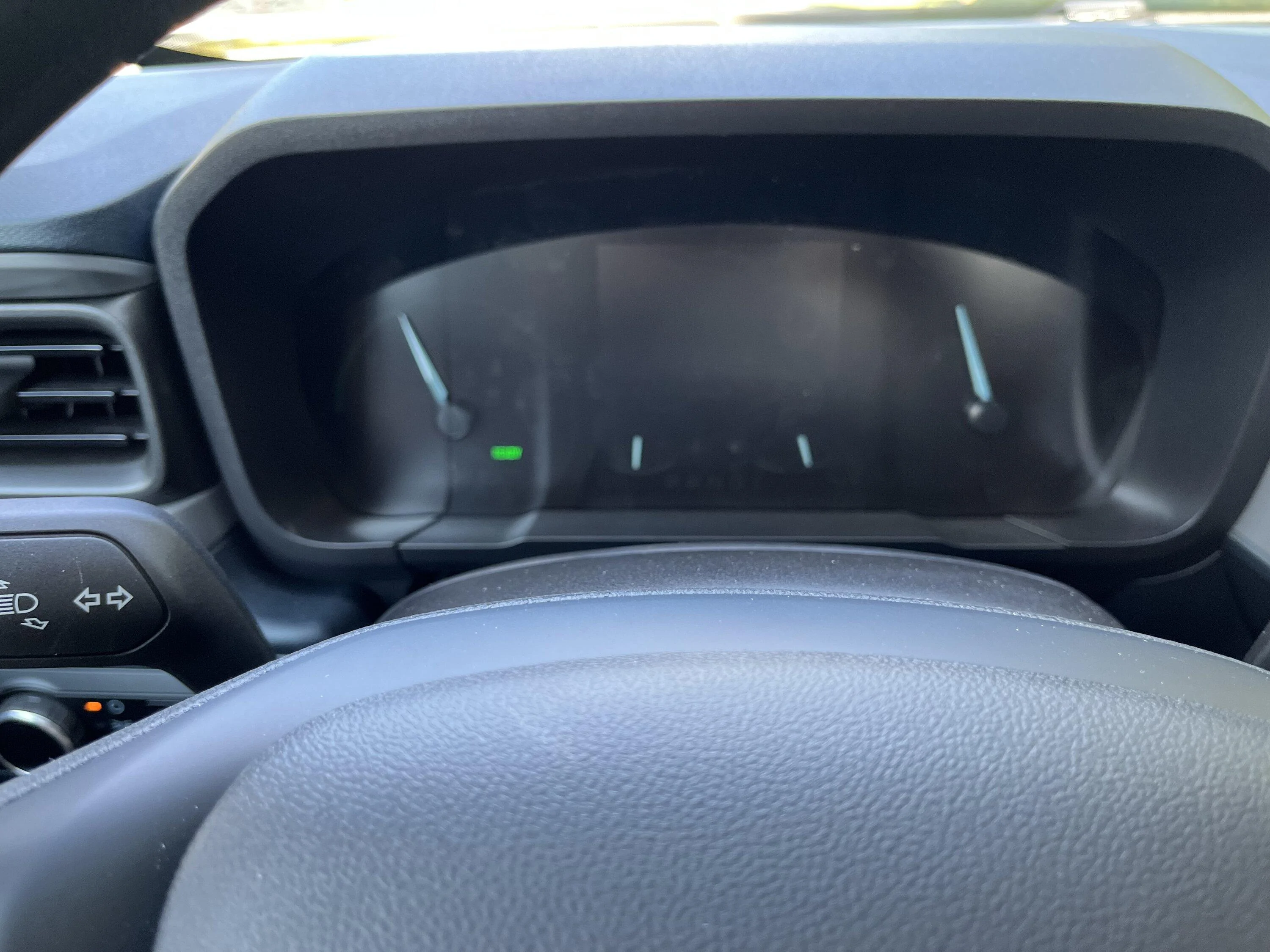

Thank you for that idea. My instrument cluster went blank out of the blue today while driving. When it happened I thought this is a huge bummer. I’m going to have to go to the dealership to get this fixed and it my main transportation to work, definitely was frustrating.
Ford Maverick instrument cluster went blank IMG_4025
I I was able to search on the forum and found your fix idea and tried and now it’s back up and running. Thanks again Maverick Truck Club
