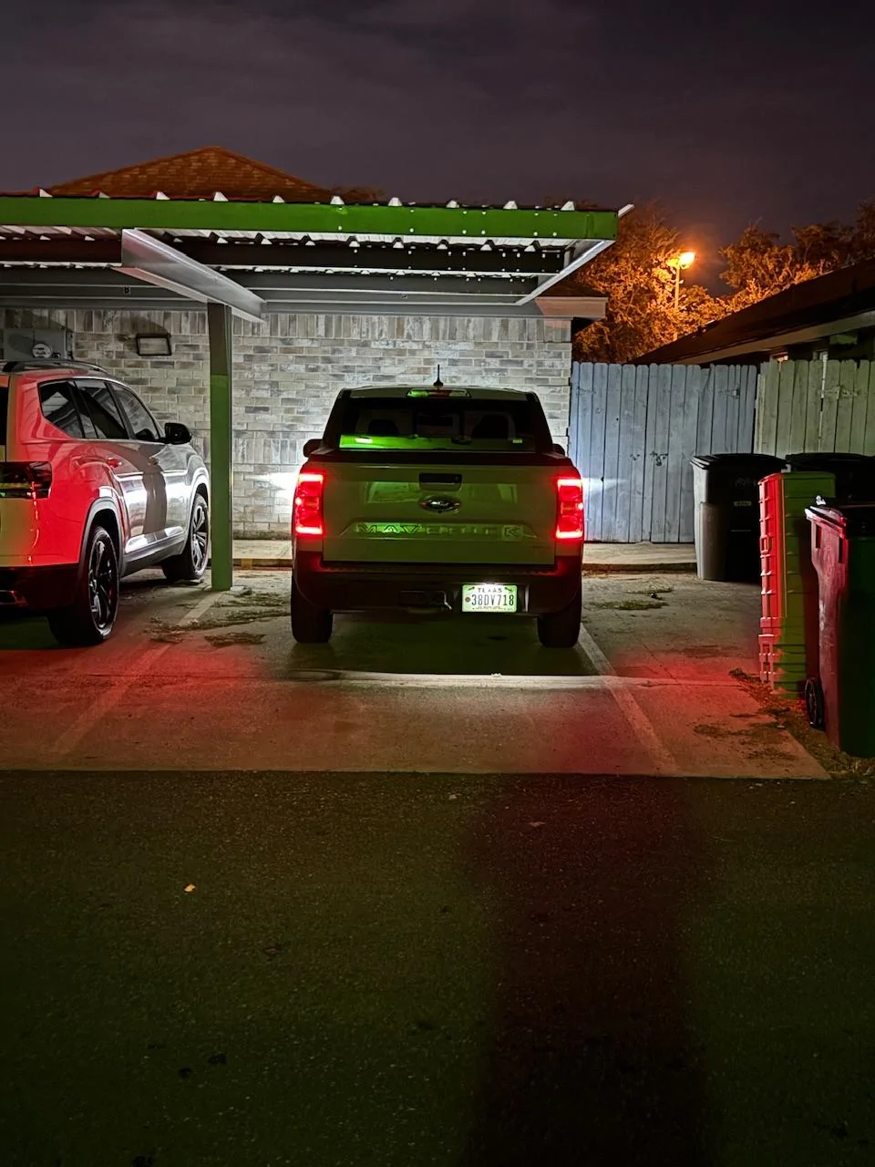

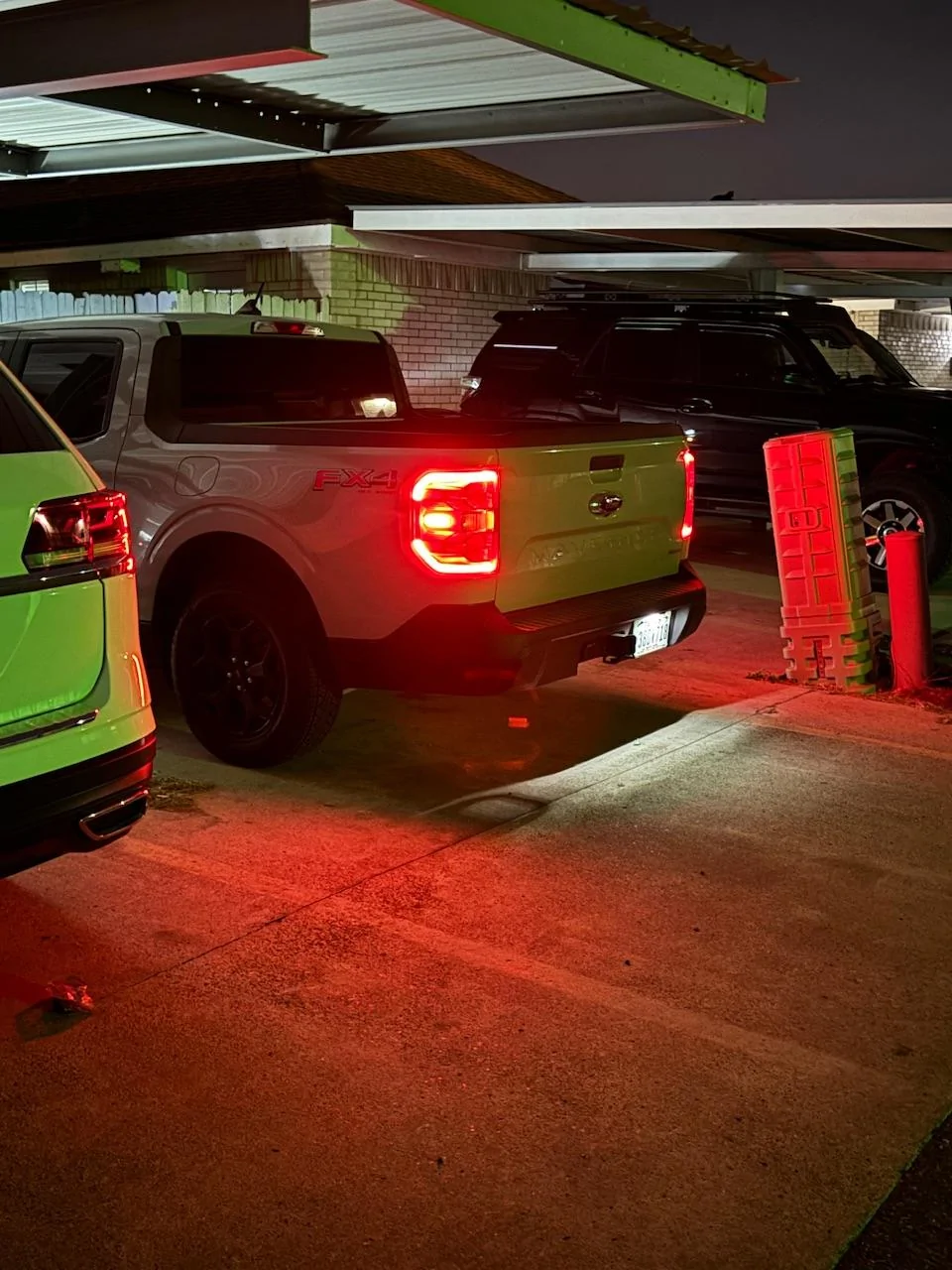

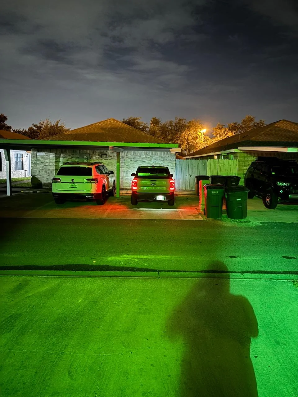

I did my best here.
Wow, I'm absolutely sold on doing this now. That looks amazing. Thank you so much for the detailed images and video, super helpful!!
