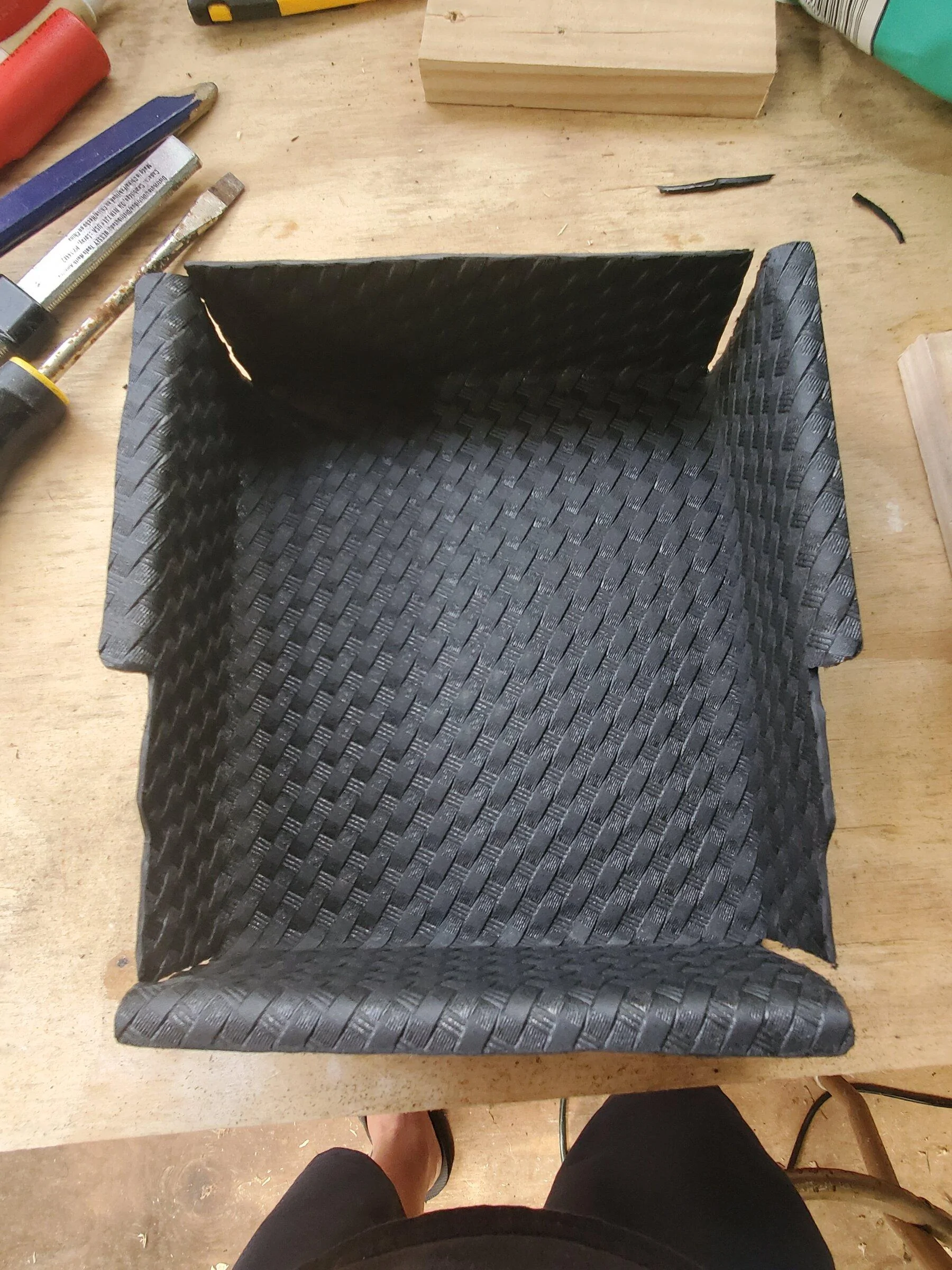

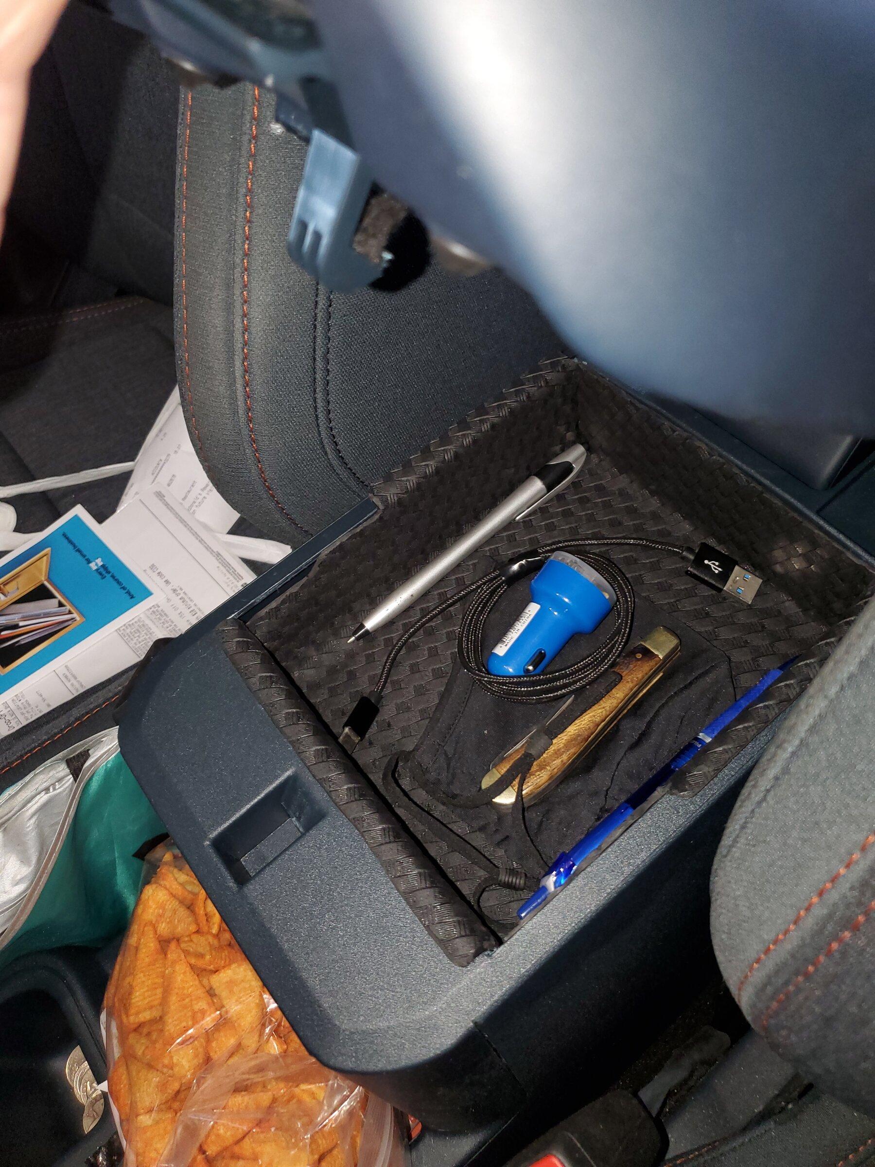

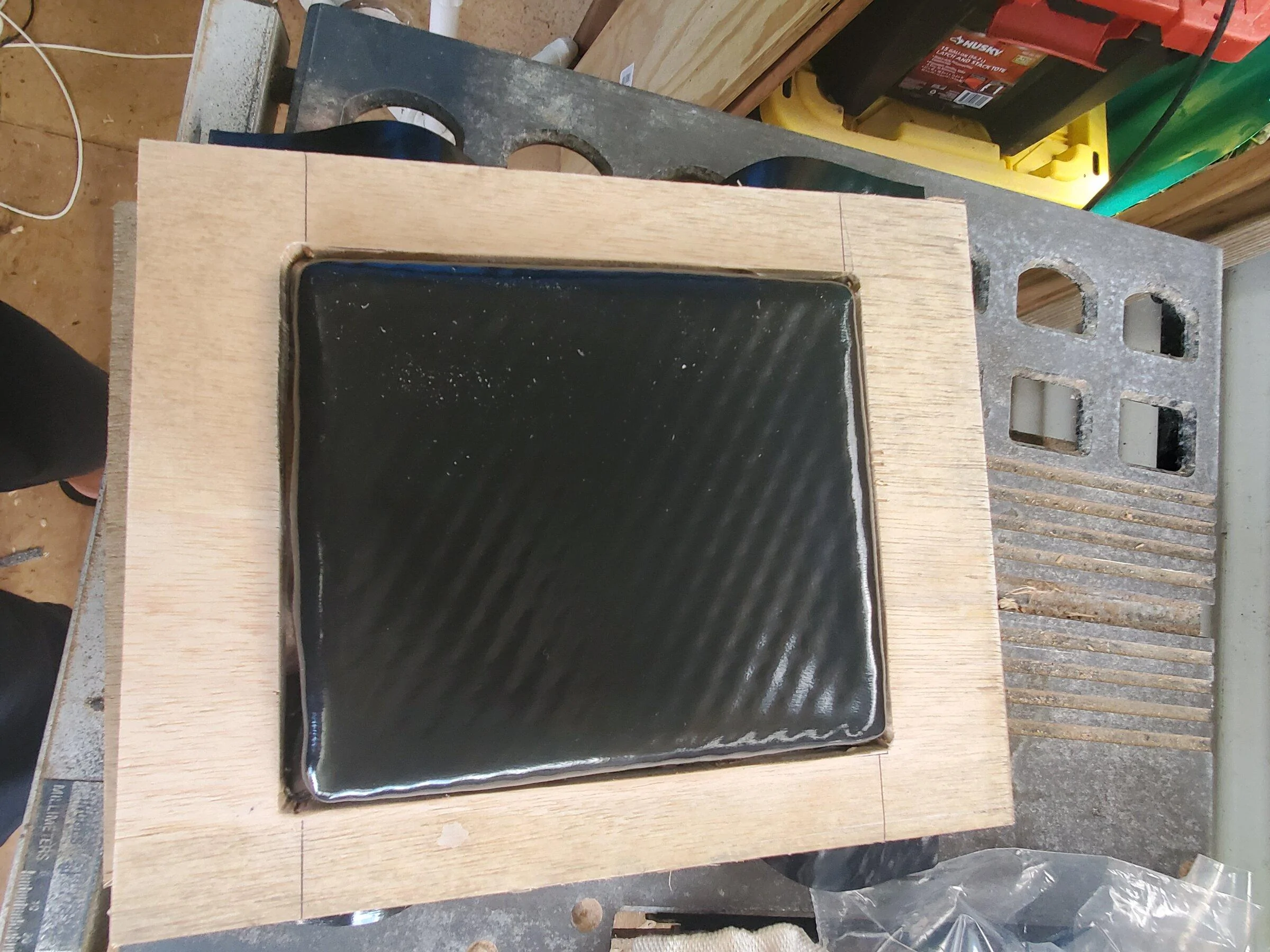

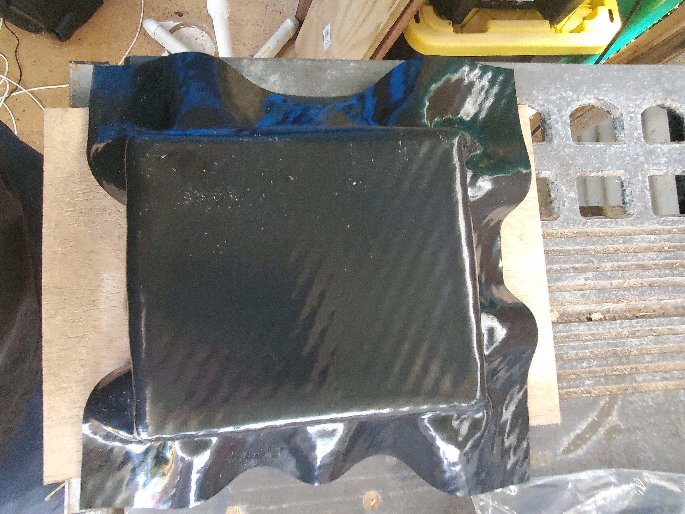

You know the stuff they make gun holsters with , well I made a console tray with it. I watched a couple of Youtube videos (actually only 2 videos of making a tray). I ordered a 12 inch sheet from Amazon for $15. With the help of my toaster oven I heated per instructions ( also used my heat gun to form also). The sheet thickness I used 0.80 which was a little hard to work with but they make 0.60. You have to wear leather gloves because to be workable it has to be really hot.

Are the corners left open? I like the kydex idea better than the printed ones I’ve seen.
On this one they are, given this was my first try at making one. It wasn't fitting just right so I had to cut the corners and trim to fit. I think I can use a soldering iron with the flat blade and close off the corners.

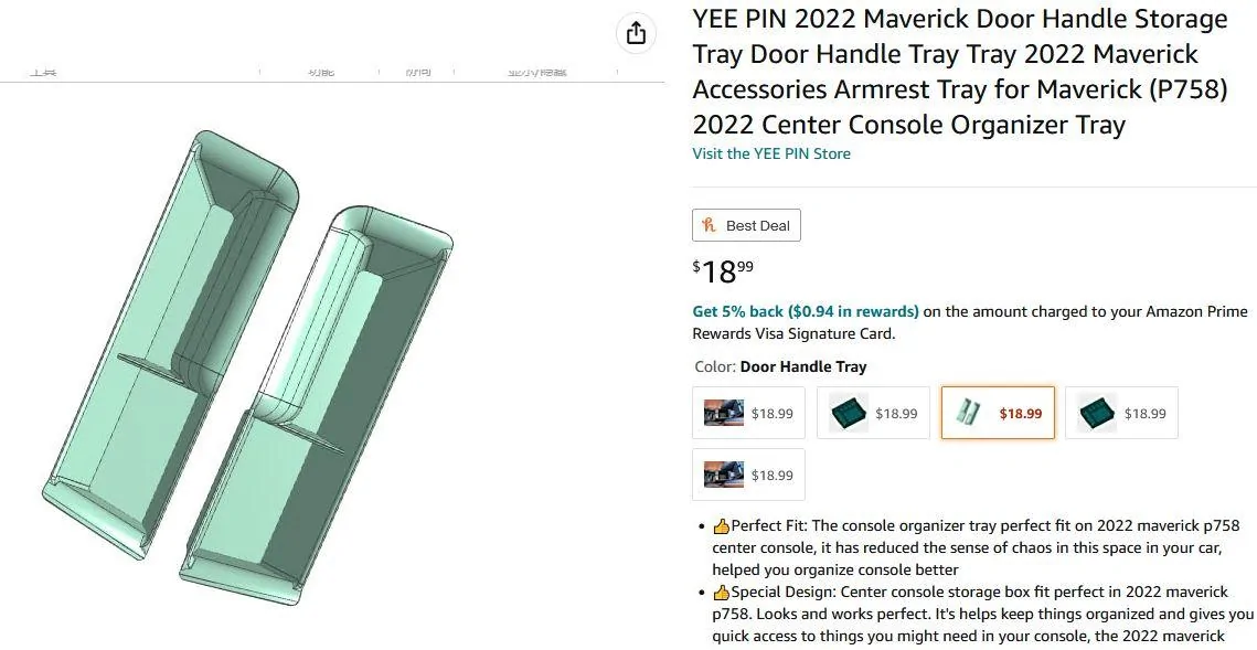

I saw they have a Door Handle Storage tray also. How does this shape work? Does it go in the bottom?
