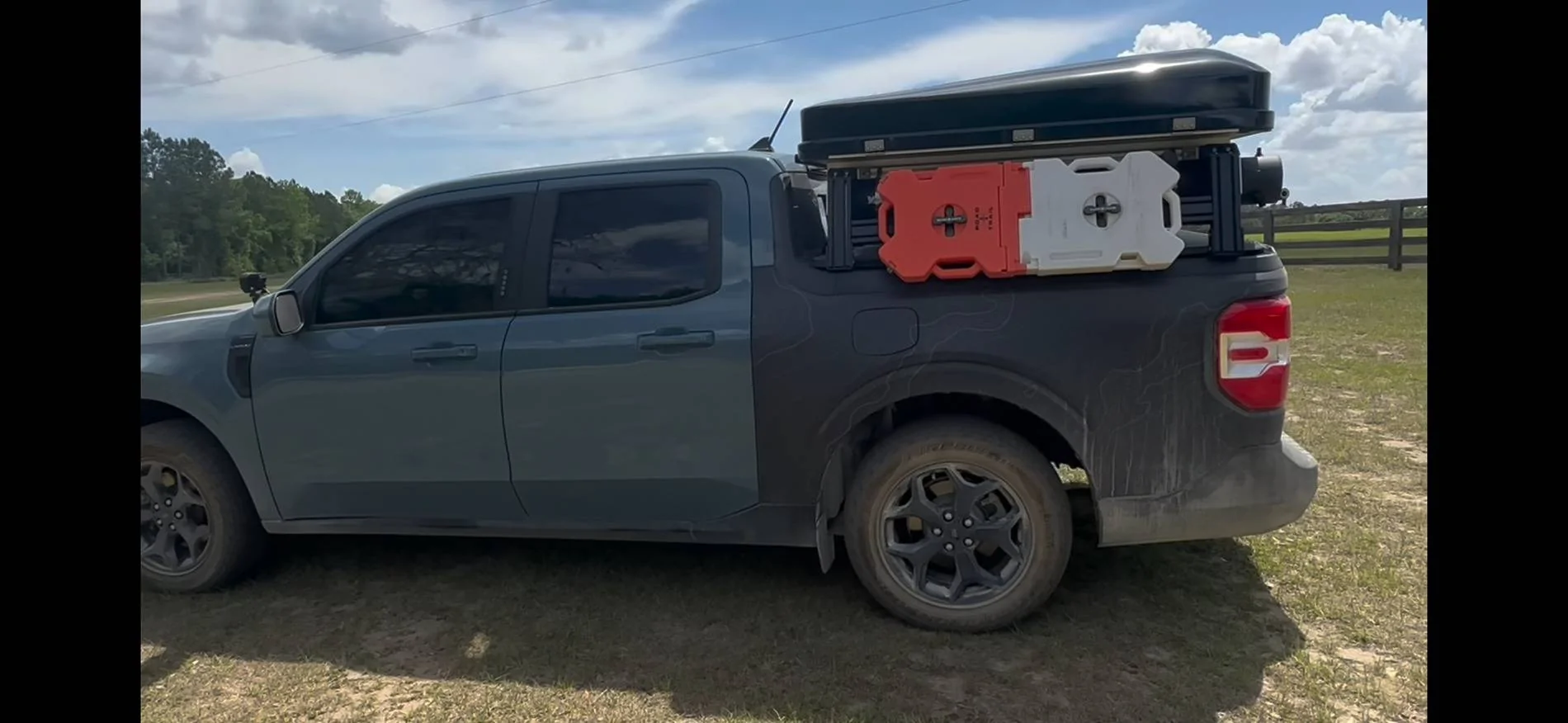

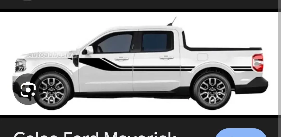

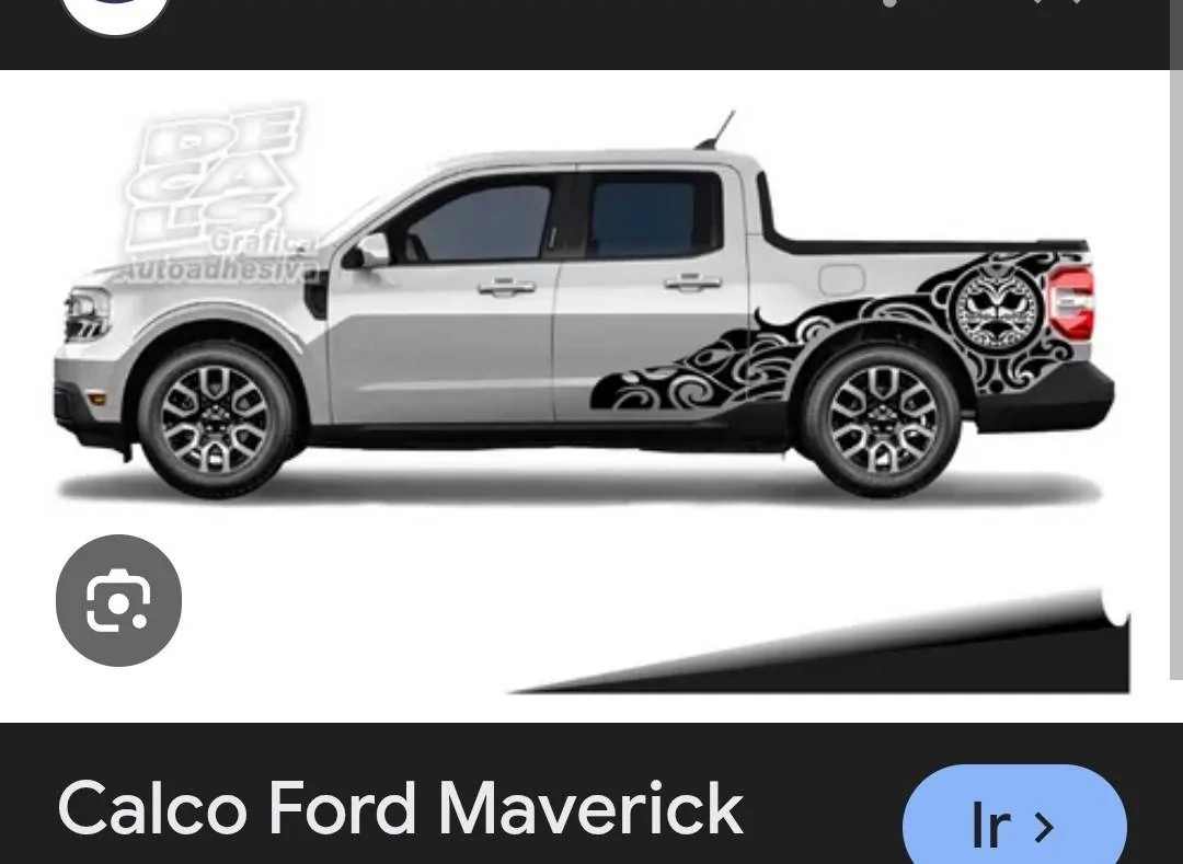

This guy has vinyl wrap over the hood and the side panel
That's get you an idea, vinyl is cheaper than painting

Vinyl wrap requires a perfect surface , so you'd still have to pay for sanding, priming & painting. The only savings would be on color match/blending.

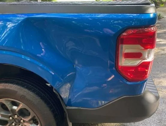

Exact match since I bought paint from Ford. You'd never be able to tell which fender was painted...most modern paint takes several years (depending on color) before it starts sun fading. I did a good job on rear fender dent. ($950 labor and material by a local independent body shop.)
Mav hood is aluminum but seems most body panels are steel; fortunately, the rear bed fender and tailgate is steel...so a powerful magnet saves time and money for body shops. Clear coating adds to the cost of body damage.

Some Mav body panels are aluminum (hard to work on) some steel; fortunately, the rear bed fender is steel...
The only aluminum panel on a Maverick is the hood.
