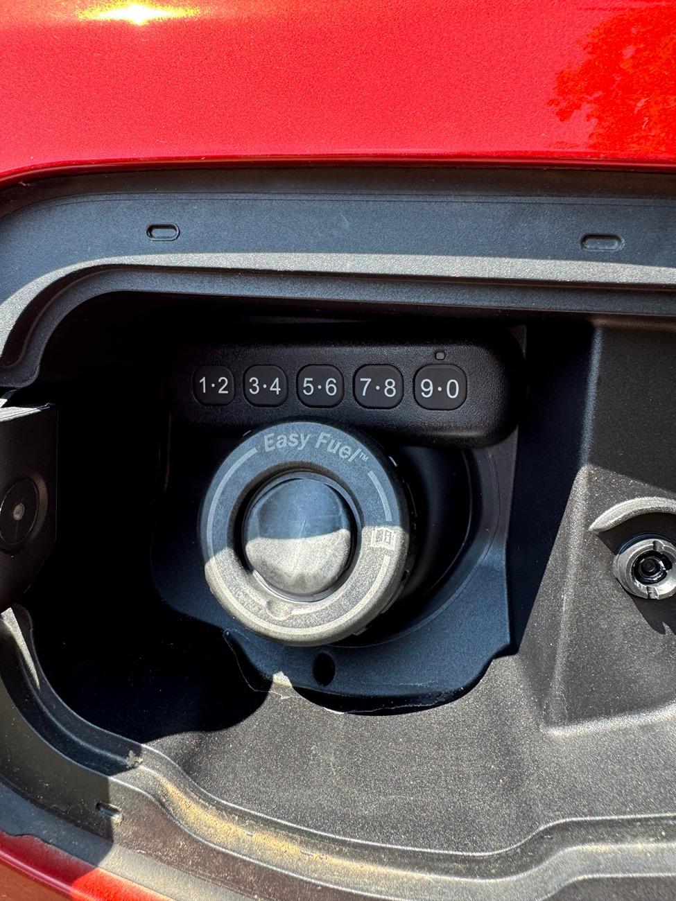

I bought one through Ford with the install for $24. First dealership couldn’t program. Said they had a lot of trouble with them. Said to return to get another. Went to another dealership. Took two trips to program. Come to find out, you need both remotes present. They wiped out all programmed devices then reprogrammed fobs with keypad. I installed it in my fuel door. Probably could trim the keypad case or remove it. But it works great
