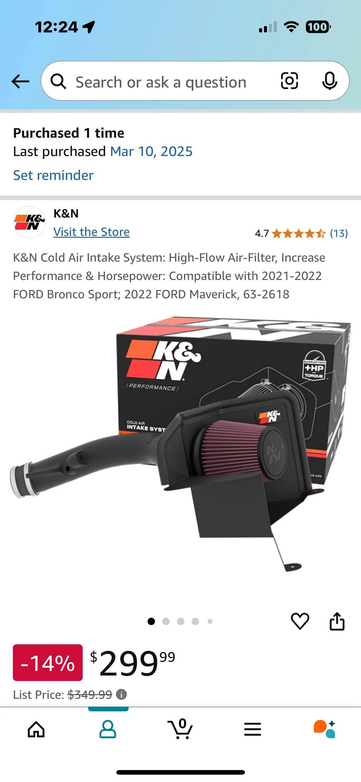

K&N Cold Air Intake System: High-Flow Air-Filter, Increase Performance & Horsepower: Compatible with 2021-2022 FORD Bronco Sport; 2022 FORD Maverick, 63-2618

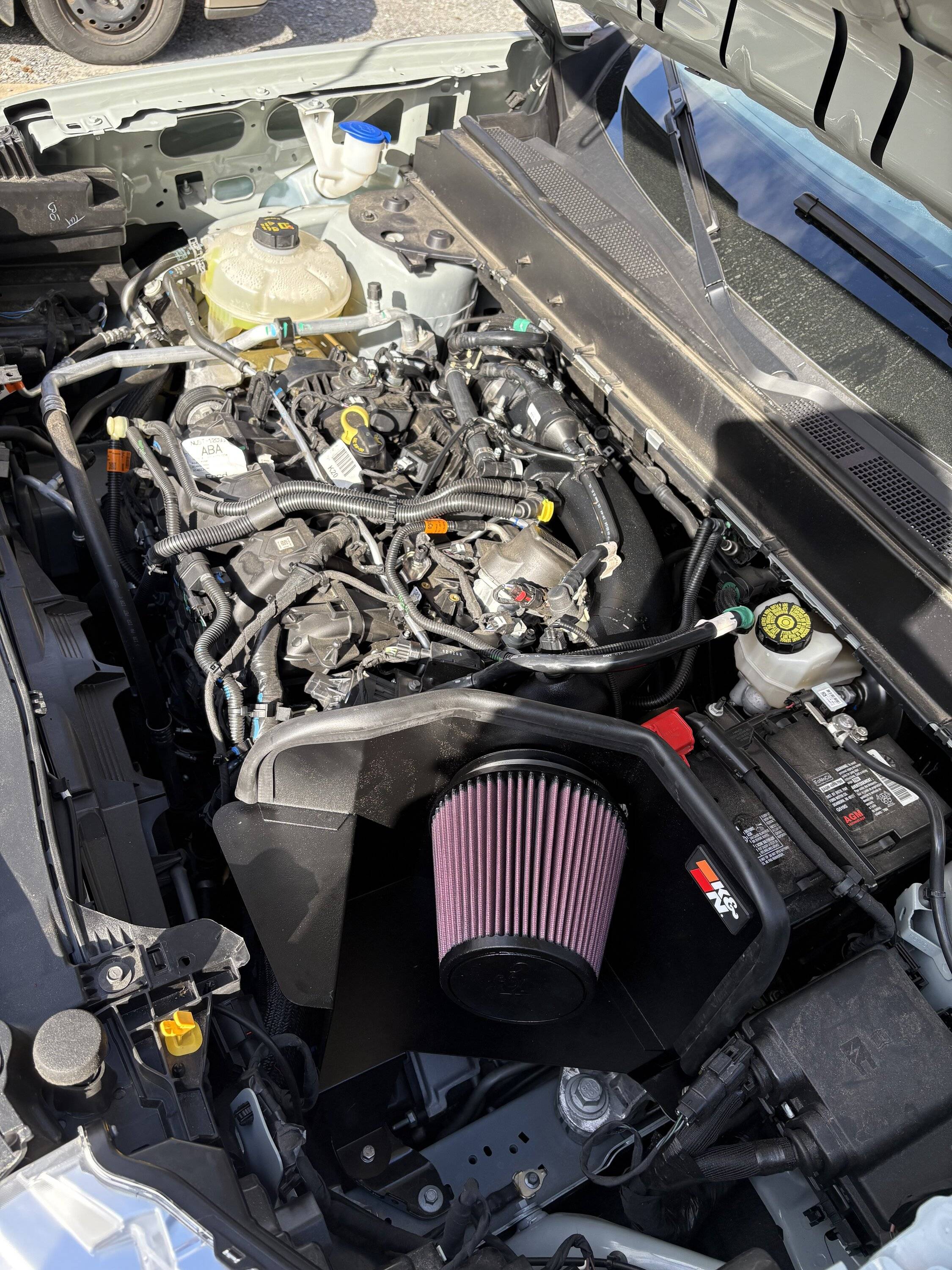

I installed it on my 2024 Ford Maverick XL EcoBoost engine. It run so great make a good sound to the turbo sound.
Ford Maverick K&N Cold Air Intake System Installed IMG_0668

Why only a 22 and not a 23 or 24 model?

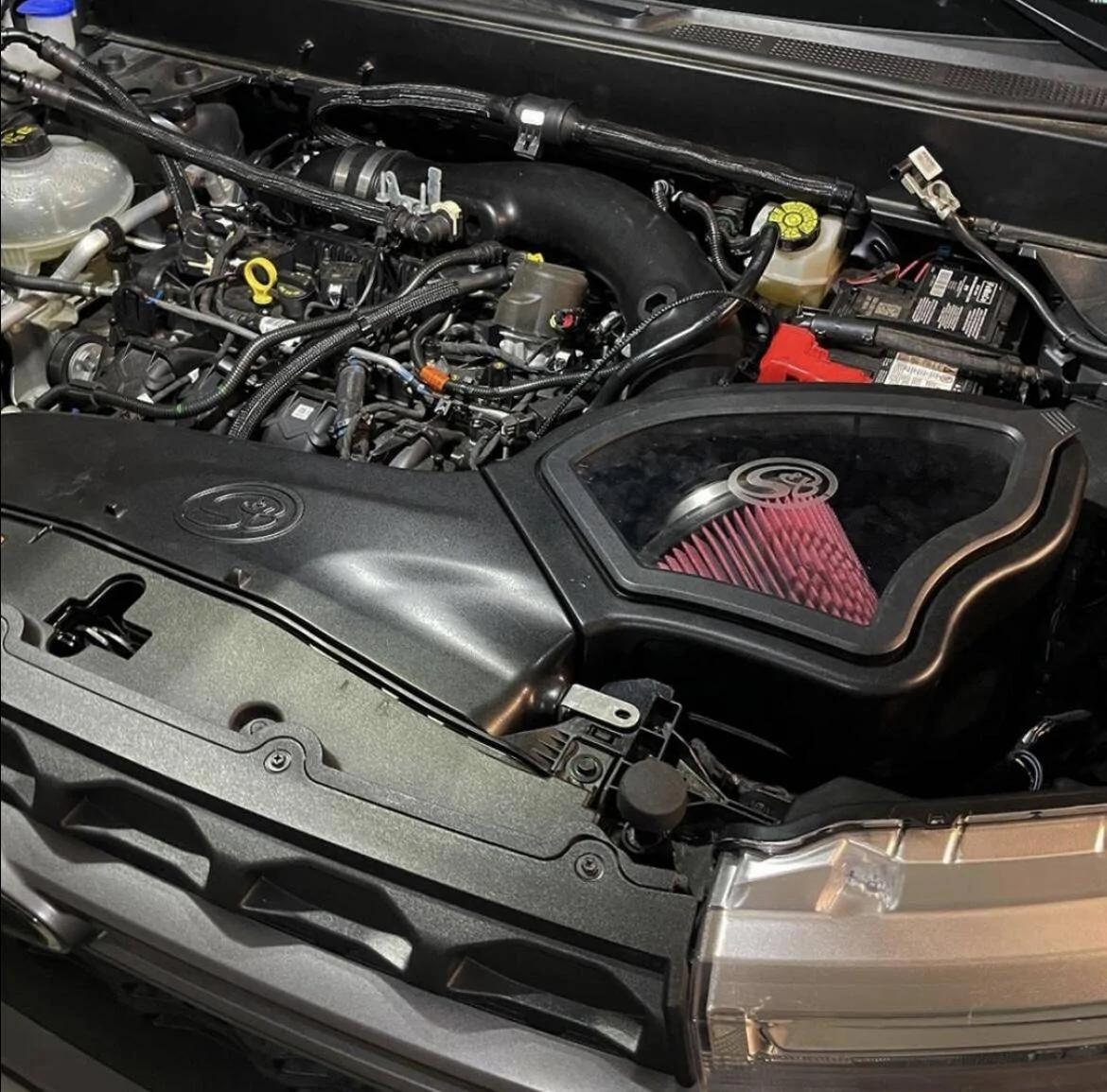

I put an S&B intake on mine. Closed box and large intake scoop eliminated underhood heat and makes no extra noise.
The S&B is a better investment because it's a true cold air intake, and the K&N is not.

I am averaging a 10% increase in fuel economy especially on the highway.

Total waste of time... everyone loves the extra vroom under the hood.
I have used a K&N type filter on my dirt cas for years but the cold air deal is wishful thinking

The deal is the computer adjusts fuel and timing based on the air temp, coolant temp etc. Adding the cold air intake just forces the computer to adjust those parameters to compensate for the new air temp...
Back when we had carbs it worked...today? Not so much ..
