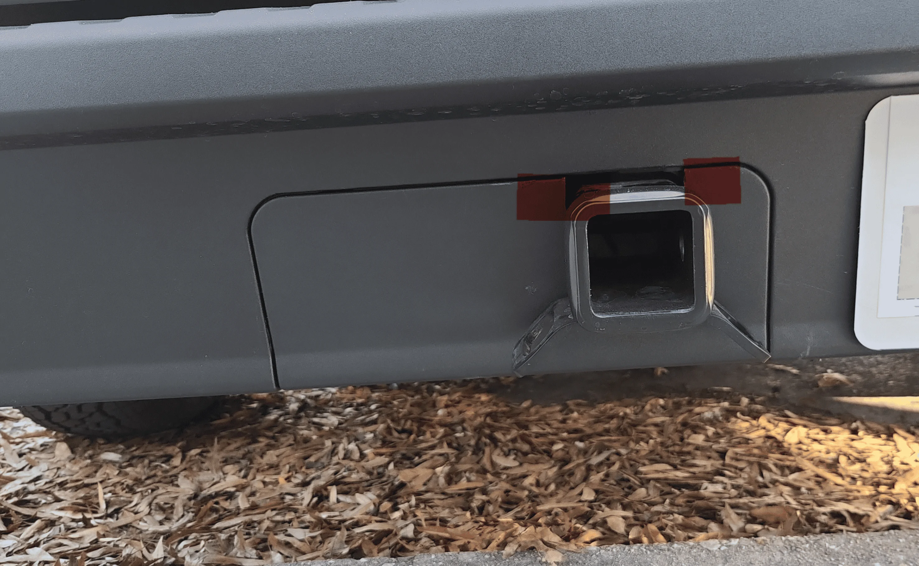

Is there an install video or how-to instructions for the hitch bumper finish panel?
groovesocket
Atom
May 2, 2021
41
496
824
Central TX
2022 Cyber Orange Ford Maverick XLT Hybrid
Is there an install video or how-to instructions for the hitch bumper finish panel? This:
Ford Maverick Is there an install video or how-to instructions for the hitch bumper finish panel? PXL_20231227_213223718
Any help or tips is appreciated.

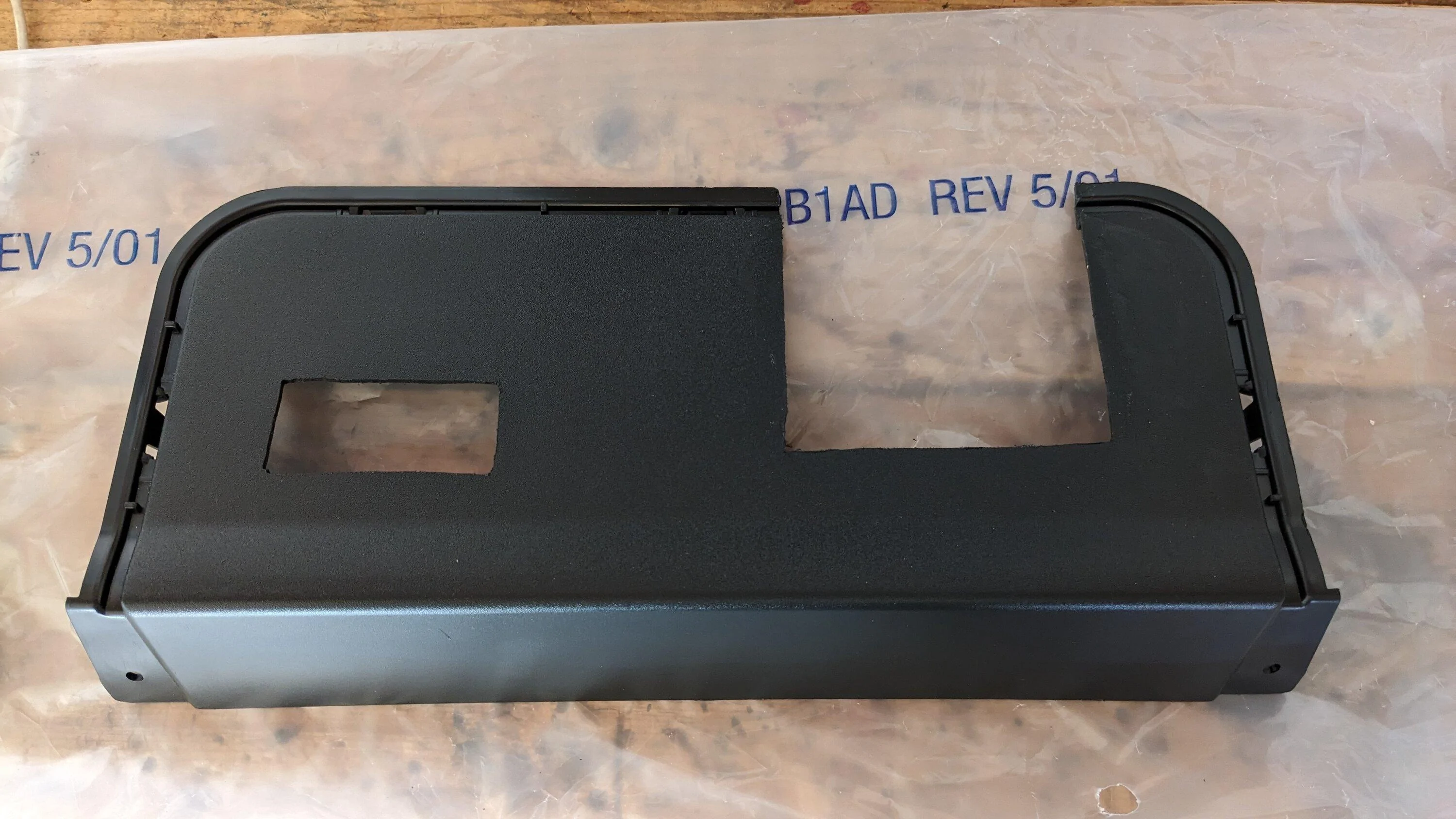

your gonna need to bend it a bit to wiggle it in. its a PITA.. i did mine without the hole for the plugs and just moved them right behind the panel.. (i wont use it anyway)

Removing the wiring plug will help
(I didn’t do that) the PIA part is getting it around the chain hooks. If I had to do over again, I would have put the piece in some super hot water for a few minutes right before trying to install it
Thanks for the tip. What did you use to cut away the back lip part that tucks under?

jigsaw
