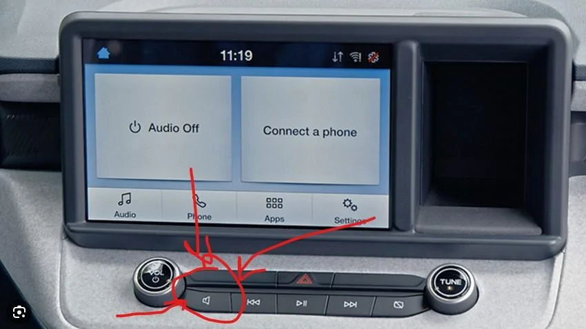

I think while everyone is trying to help, they are leading you down the wrong path. Or at least an overly complicated path. Here is how you get to the radio while Android Auto is also running. Could be maps, could be Spotify, could be Waze, whatever. Doesn't matter.
Click the physical button below the screen that looks like a speaker symbol. It will open a menu where you can select AM, FM. etc.... Essentially change the audio "source". I can't recall exactly, since at this point it is all muscle memory and automatic for me while driving, but you might also need to tap that "Audio" button on the screen that you see in the example screenshot below.
So step 1 is to press the physical speaker button below the screen, then MAYBE also need to press the "virtual" Audio button on the screen.
You can then go back and forth between that and Android Auto and it will continue to play your radio, even while the screen displays something via Android Auto. And yes, it will still read out your GPS directions and other voice type things over the radio playing. Sometimes it seems to mute the radio so it can talk to you, sometime it seems to turn down the radio and up the volume of the "robot person" who is talking to you.
Another fun fact. Did you know if you adjust the volume knob (or the volume buttons on the steering wheel) WHILE the robot is talking to you that it will increase or decrease the volume of only those notifications, separate from your radio or Spotify or other music? So if you ever feel like the robot isn't speaking loud enough (or it is screaming at you), just turn it up or down while it is in the middle of talking to you.
Thank you! Yes, this exactly what I needed to know.
