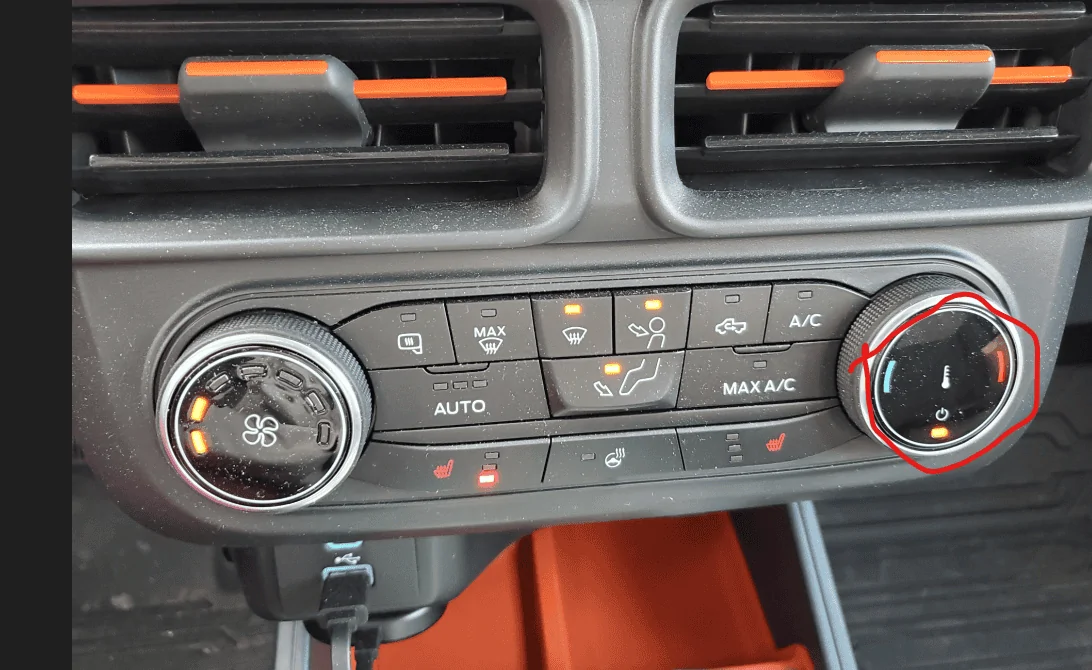

I have a 2022 XLT with Lux package. I've noticed on the temperature control knob it does not display the current temperature as is shown on some similar models. I presume they omitted a chip. Is there any way this chip could be added now? I would like to have the temperature setting displayed as intended. I know I can turn the knob and see the temperature setting on the console but would rather this function as intended.

Oh, I thought it was just missing a chip. Not sure if I want to go through all that. But I do miss having the current temp. setting displayed.

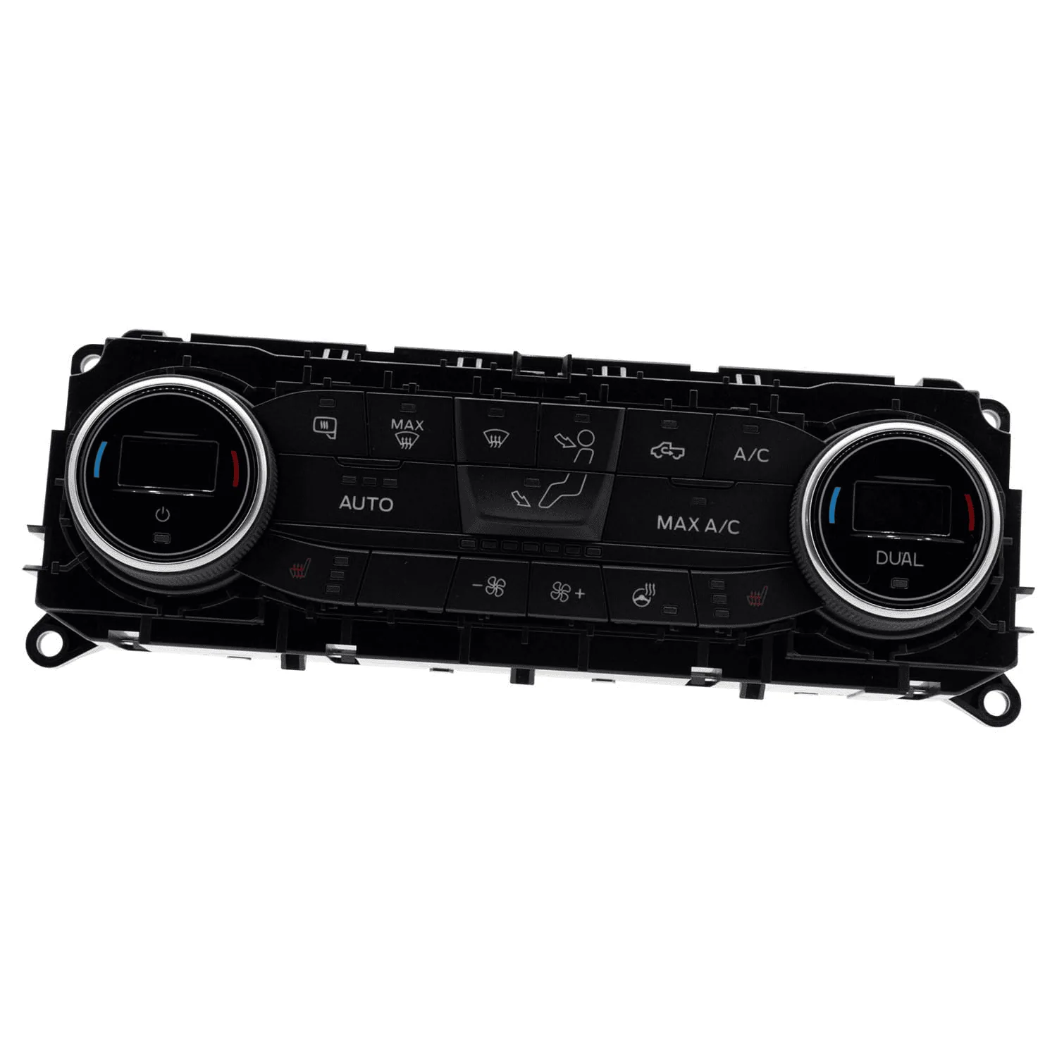

The readouts are missing entirely on the one you have, and the layout is different as well. Internally, there are other changes, too. Thats why its not just a simple controls swap. The video on it notes the heated seats, heated wheel and even the AC itself doesn't come on simply swapping units and you have to change a few things to make it work correctly. It seems easy enough to do though. Just wish the dual-screen unit wasn't $375 :)
[EDIT]
This is what the other unit looks like. Its hard to see here, but the fan speed LEDs are not on the left knob, they are above the fan speed control buttons as well:
