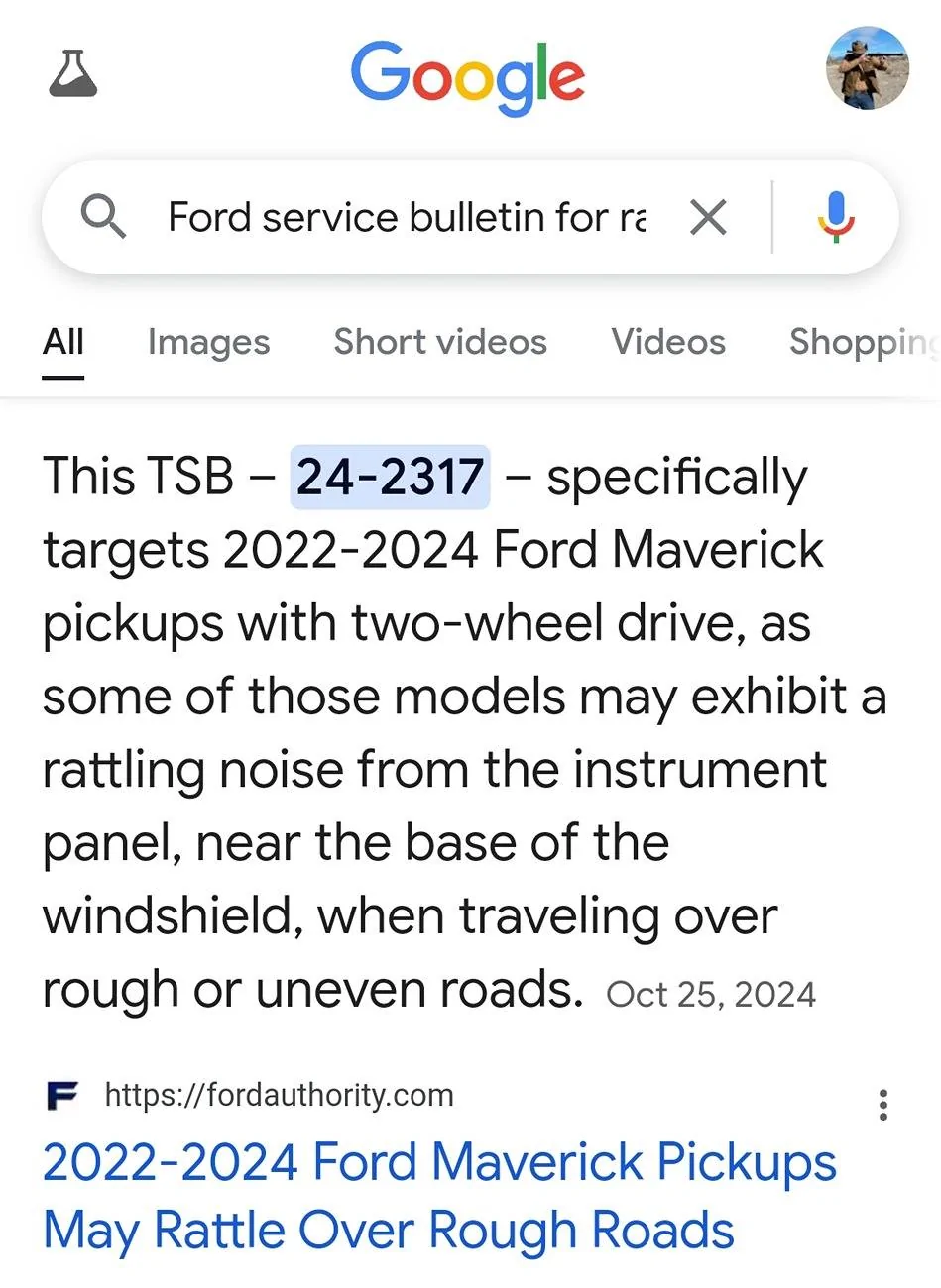

Ron S
I believe there are shims that are put in to stop the rattle.
Perhaps this will help. 👇👇👇
