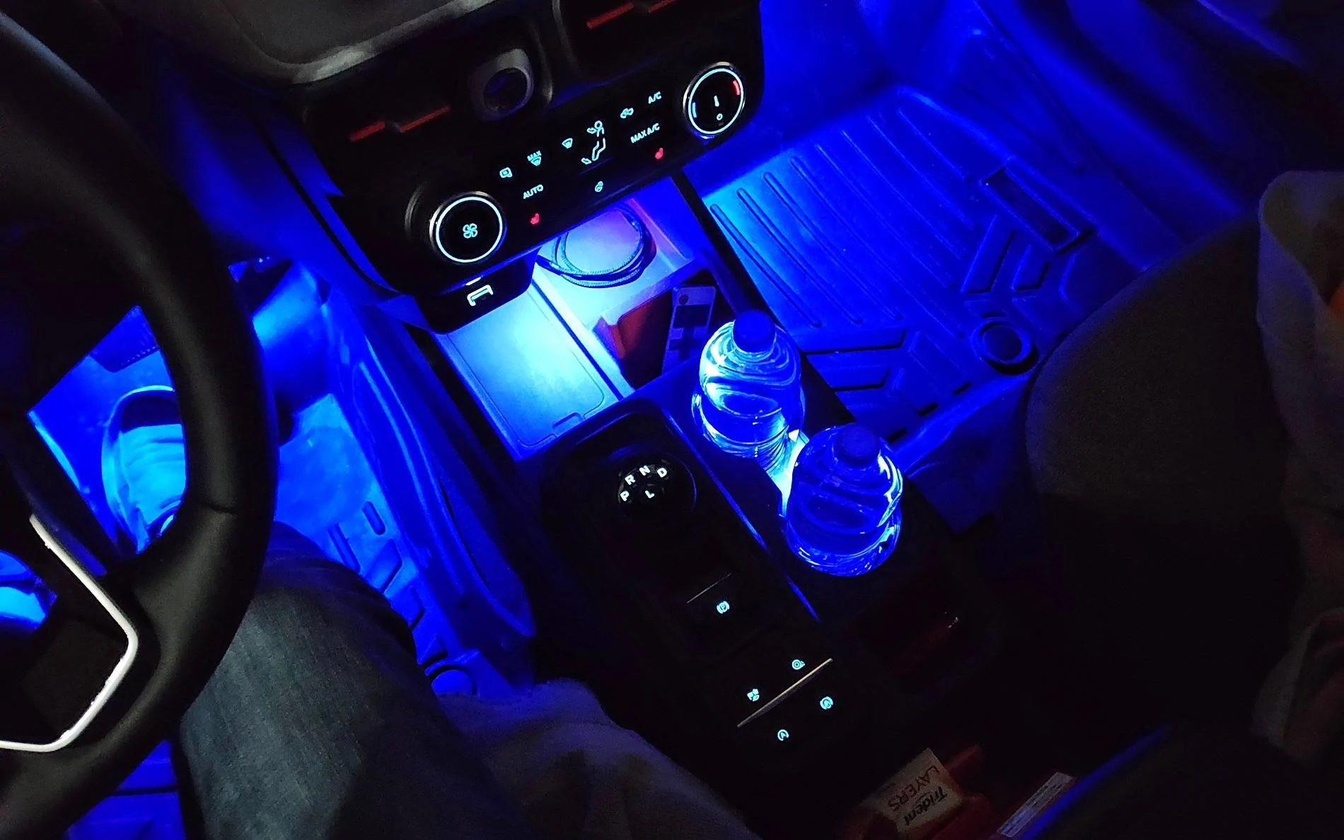

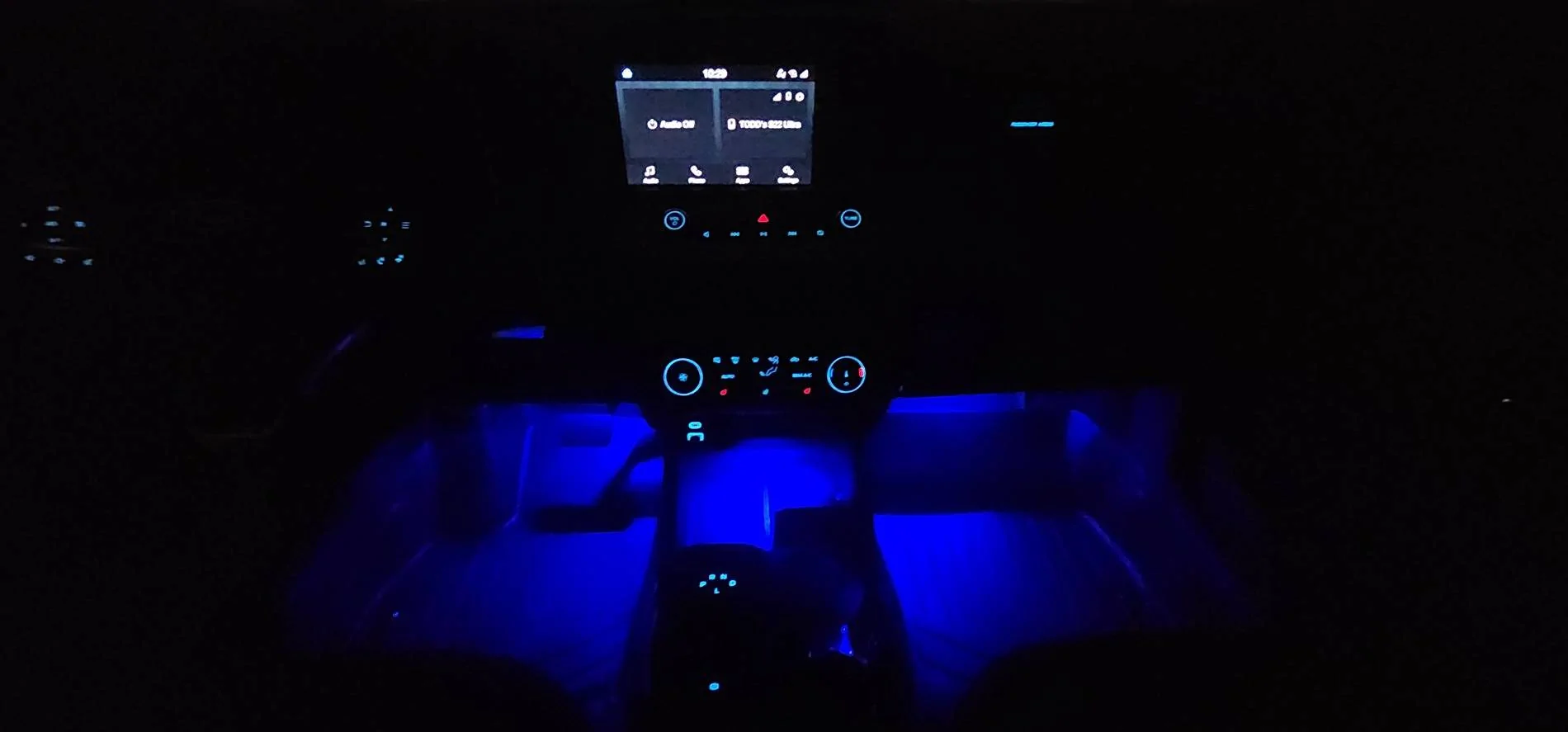

I’d like to have one myself. Hard to see the cup holder when it’s dark.
I'm talking about the console not the cup holders.
I already added ambient lighting to the cup holder area, as well as the front and rear footwells and front cubby.

Did you do any write-ups on those ambient lighting mods?
I just bought the XLT center console lamp from someone and I'll splice that into the foot well lighting of my Lariat.
Would like to do something similar for the back of the center console so that it shines on the rear floor...

I did but finding the older post is a pain in the butt on here, if I run into it I'll quote you again and post the link.
If that's what you're wanting to do, that back panel just snaps off the console. Its held in place as you know by five bolts, you could run the wires under the console from one of your current ambient lights and just cut/Dremel a hole the size of the light underneath the accessory slot on the rear of the console that's where I drilled a hole 3/16 of an inch for the LED to shine through.
Since the XLTs don't have ambient lighting I tapped into the 12 volt accessory port below the climate controls for power.
