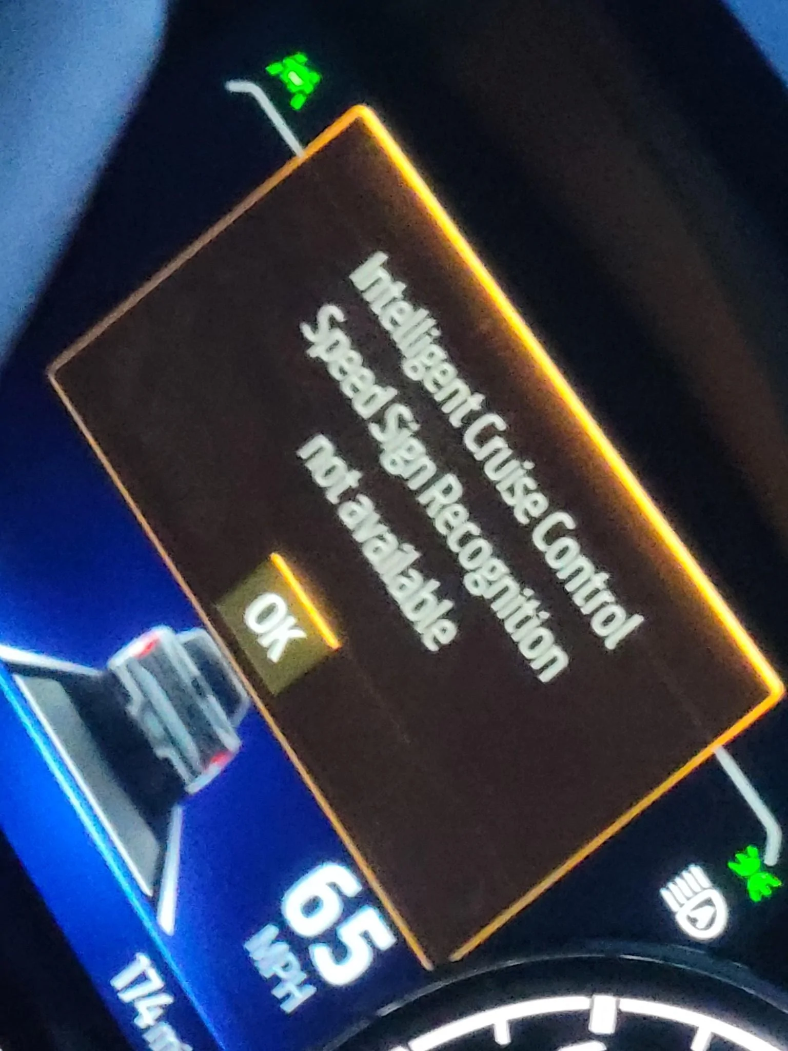

Has anyone done this? Ive got the option for intelligent cruise control but I get an error with it not being able to read traffic signs. I have TSR turned on but i just ran out of time today. I have a lariat lux with ACC
Im working on a list of forscan mods also for a video so far what ive done:
-added off road screen
-added mud/ruts and sand modrle
-Courtesy honk disabled when you take your key out when engine on
-global windows down
-(TSR) i got 2 bubbles testing to see if the 2nd one shows any signs of working....
-(personal) removed seat belt reminder for driver and passenger since my job sometimes has me driving around a lot.
- disabled honk on lock
I like to hear of there is anything on Intelligence cruise control if not let me know of some more forscan trick with the Mav! Thanks

Yes, it's possible, I have it enabled and working, but outside of using it once, I run normal adaptive

If you have any of the coding for forscan or where a forum page has some good information that would be great! Thanks

@nickn066 's posts suggest it needs to have an APIM with NAV so Sync 4 or maybe a 2023 Sync 3 unit and:
IPMA
706-01-01
xxxx-xxDB-xxxxx
Darnon
Jul 4, 2021
5,707
7,205
WNY
I will try this code when i get home since im using xxxx-xxD2-xxxxx for the TSR
If you set it to D3 (or SLIF in easy mode) and in the IPC:
720-03-02 -- xx4x xxxx xx
720-09-01 -- xxxx xxxx 8x
That should give you the square traffic signs, FWIW.
