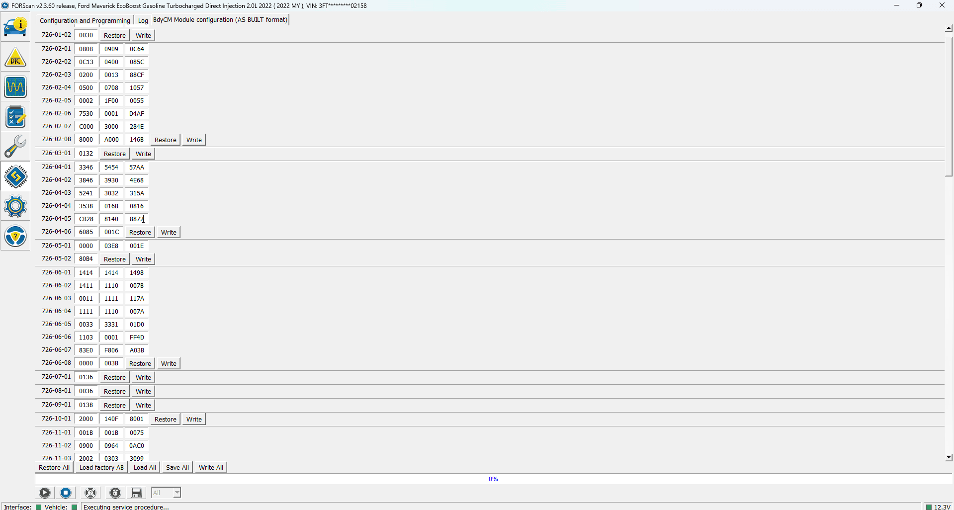

the switch comes stock on a lariat correct? I could just tell you the stock coding for the lariat.

Ford Maverick Adaptive cruise control on 2.0 EcoBoost XL Screenshot 2024-05-08 at 9.44.22 PM
This is the coding from a lariat ecoboost bap 2024

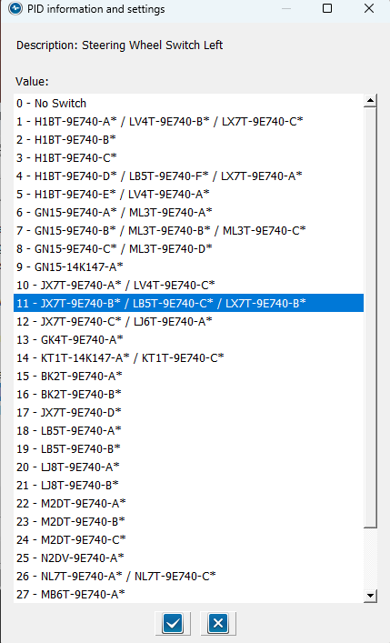

Steering wheel switch left is LB5T-9E740-A*

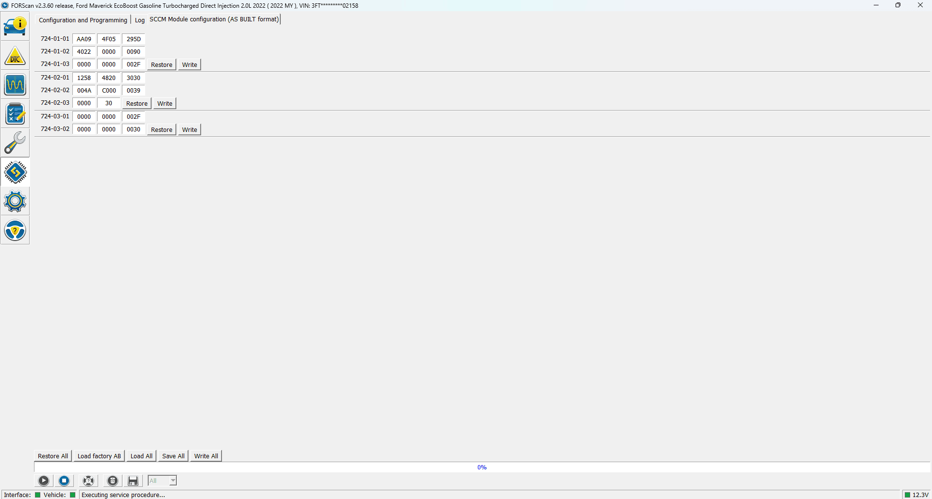

You can change this through easy mode or through as built coding. steering wheel switch left, right and Lane keep aid are all grouped together under 3 digits at
SCCM
724-02-01
xx??-?xxx-xxxx

let me figure out what your exact as built coding should be if you want to keep the right switch the same but change only the left switch

Ford Maverick Adaptive cruise control on 2.0 EcoBoost XL Screenshot 2024-05-08 at 9.51.56 PM
Here is your current coding for based on your 724-02-01
EONR24
Swag
Feb 26, 2024
44
1,442
1,656
United States
2024 Ford Maverick XL
Here try the following coding change
SCCM as built
724-02-01
xx90-4xxx-xxxx
ABOVE IS WITHOUT LANE KEEP AID ACTIVE
FOR LANE KEEP AID ACTIVE, TRY THIS CODING BELOW INSTEAD
This is also the exact coding for a Lariat Ecoboost 2024 BAP
xx90-6xxx-xxxx
This should fix your issues. let me know if it does.

Or you could try selecting NUMBER 18 - LB5T-9E740-A* on the EZ mode list but I am not sure if that will make the right changes..
you are the man, i just needed to change the button to the right one, it works like a dream. i appreciate it man. thanks a bunch.
