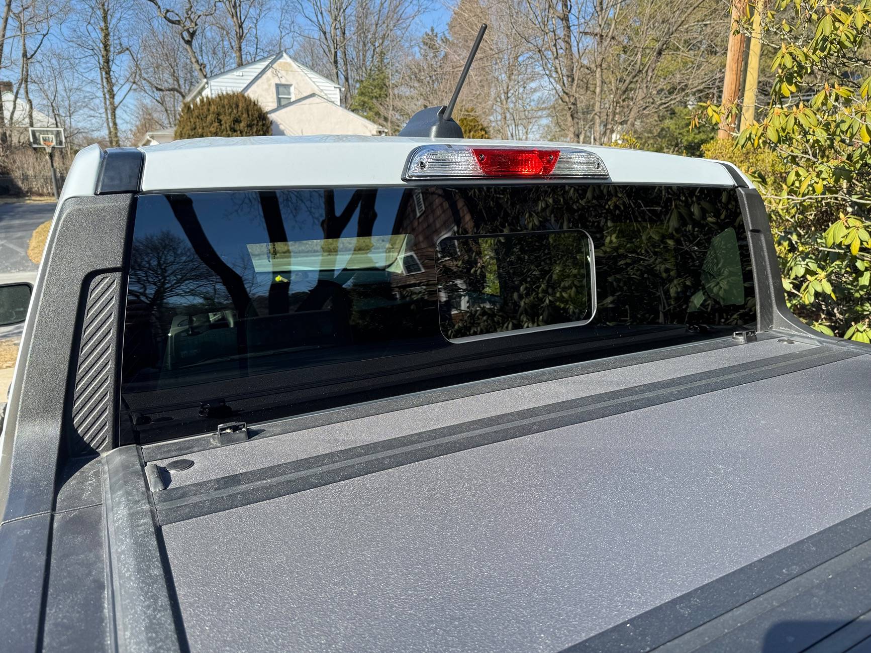

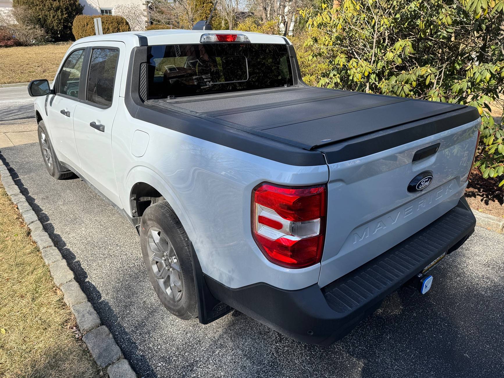

Pulled the plug and just had the aftermarket back window with a manual slider installed. The glass is actually thicker than OEM, and I am loving the added versatility.
that looks really great. (y)

Got it from these folks for $403 including shipping and had it installed in my driveway for $320. I kept the original glass as a backup.
https://nagd1.com/products/manual-s...ompatible-with-ford-maverick-2022-2024-models
The listing says for 2022-2024 models, but I spoke to the owner of the company and he assured me that it would fit the 2025. It does!
