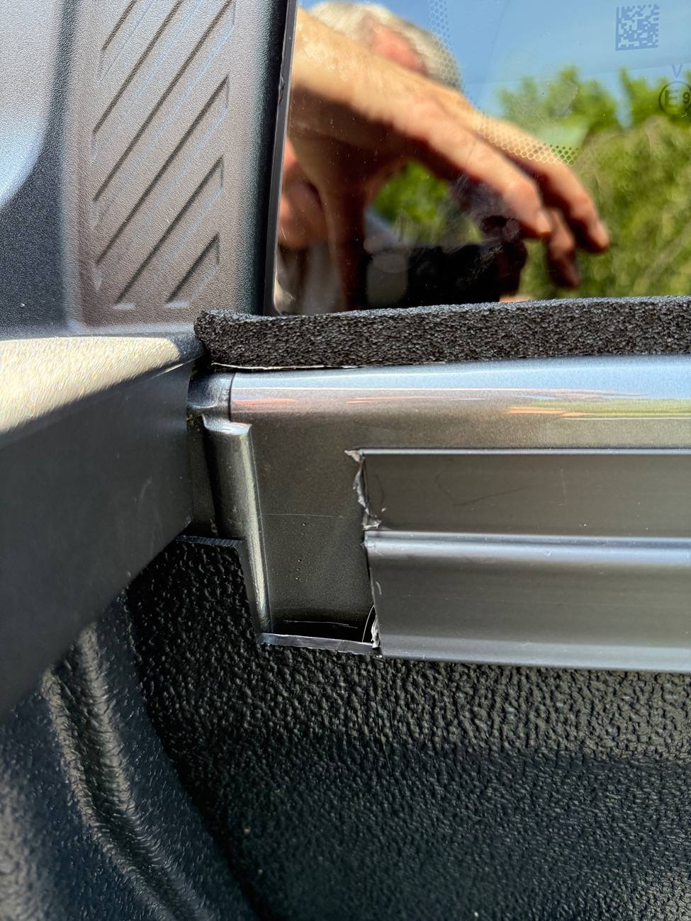

I know this is an old thread but I just installed a Bakflip MX4 tonneau cover. I have the Ford oem drop in bedliner. I did have to make modifications to the bed liner for the cover rails to properly install. Without cutting a small square in the bed liner, the drain plug was pressed directly against the bed liner, causing the cover rails to not properly seat on the bed rails.
