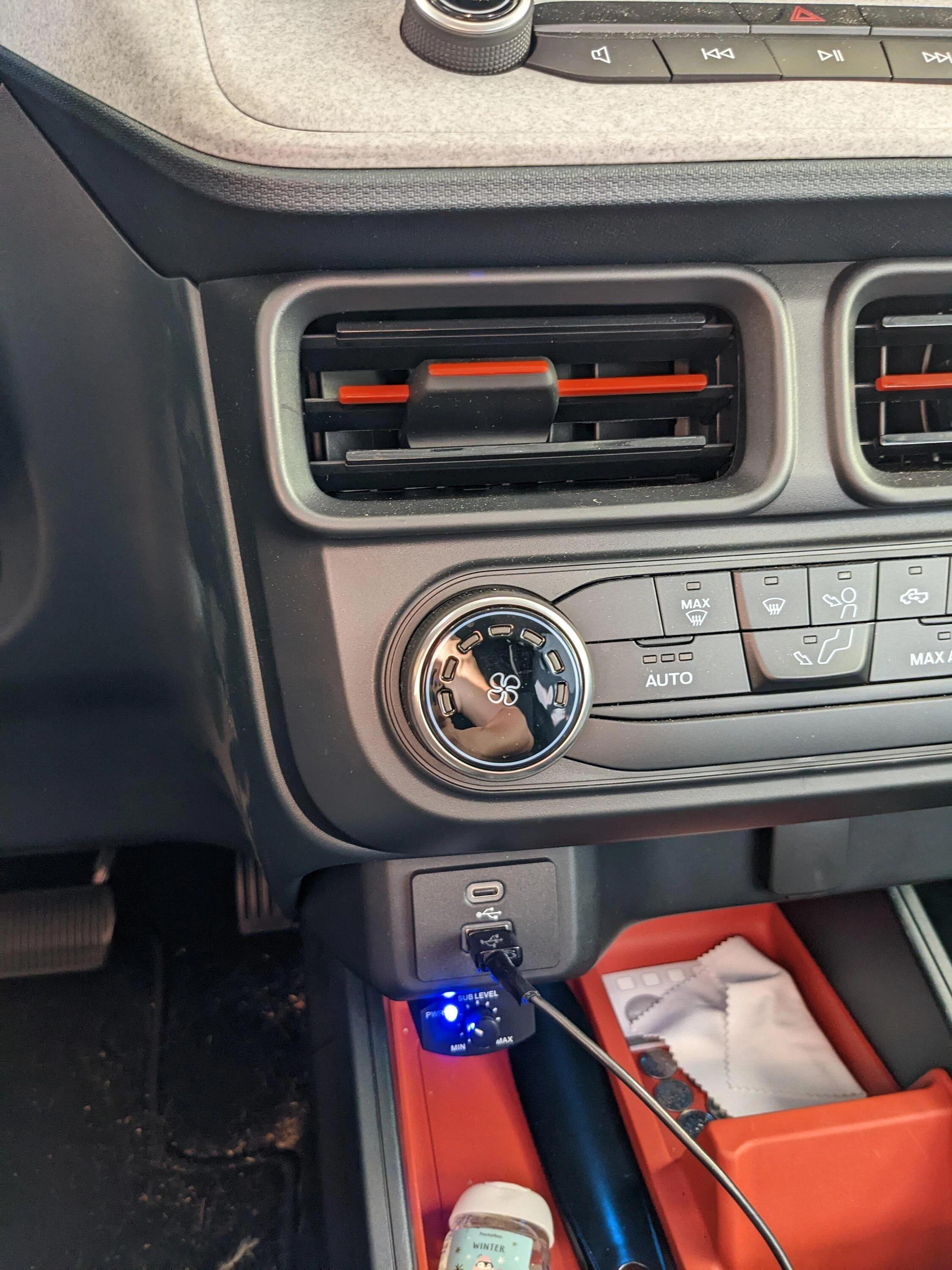

Hi folks. I just had an infinity basslink mini installed in my xlt hybrid (so base, non b&o branded audio system) and I thought I'd leave some [rambling] initial impressions. Here's an obligatory pic

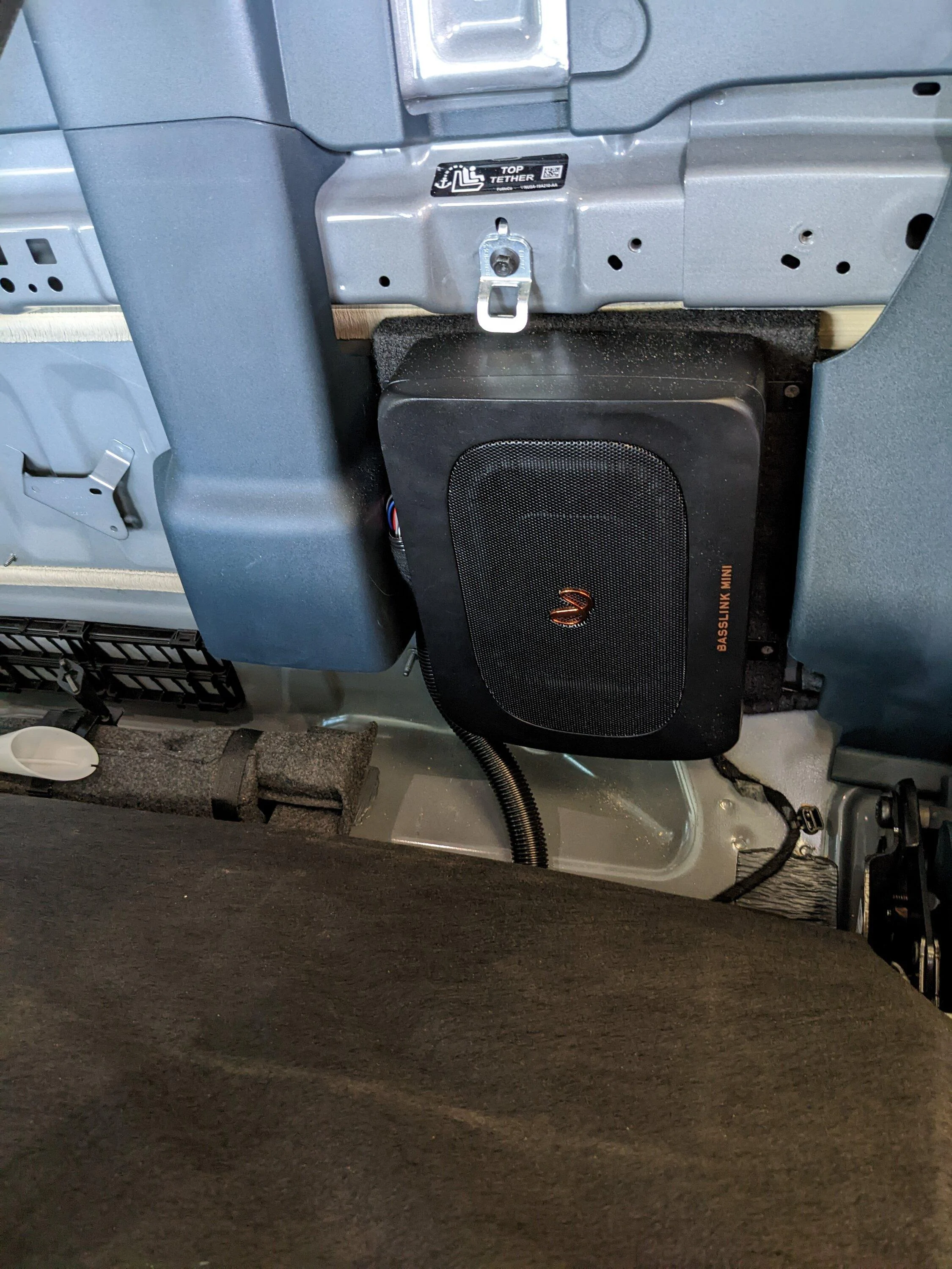

My preference would've been to install it under the driver's seat or passenger seat, but I didn't want to delete the under-seat air vents. I had measured and made little cardboard mock ups of various options to check on fit, and I decided that the basslink mini would be best for me.

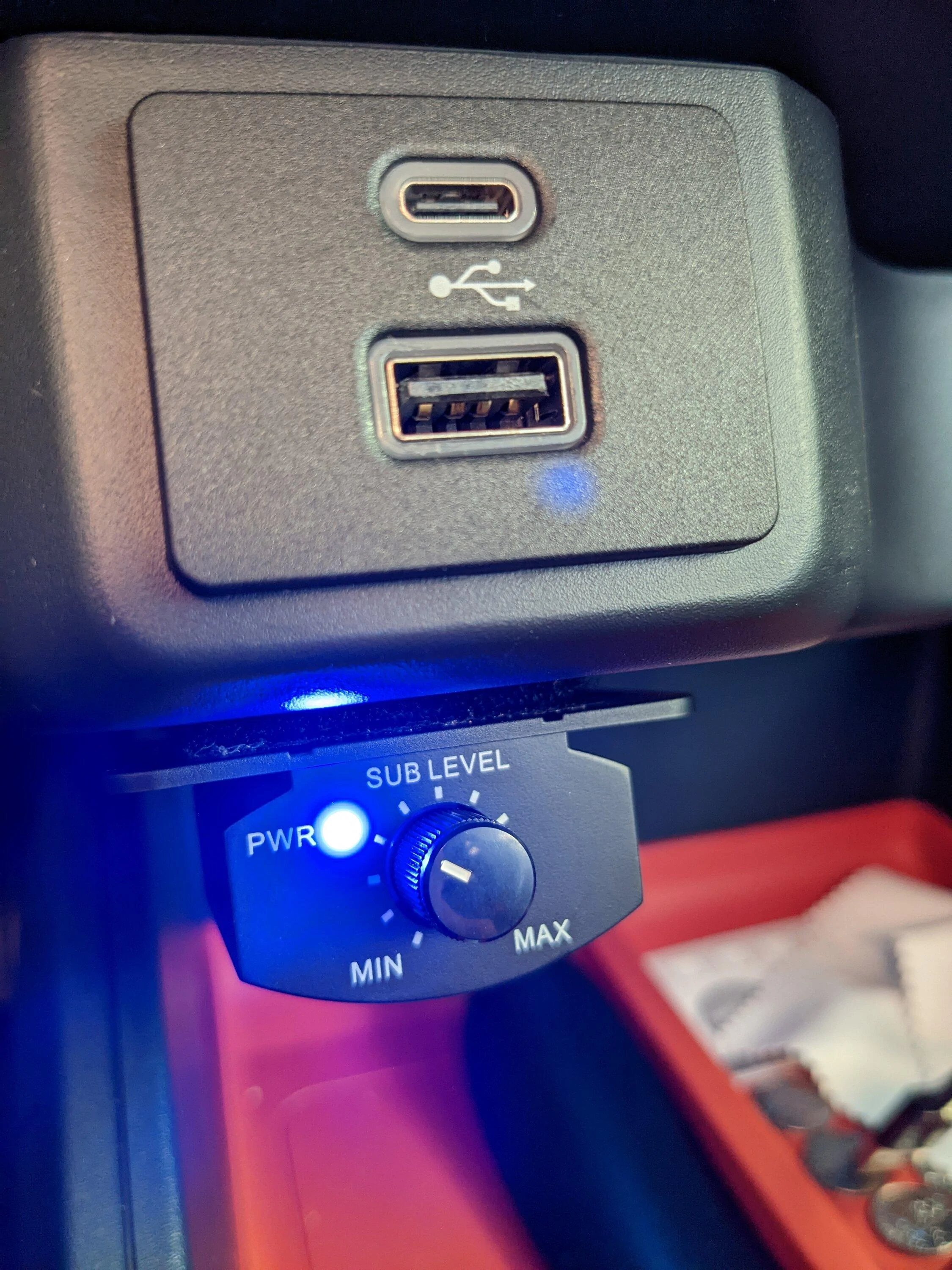

Now, the me of 20-25 years ago would've just done this install myself... But I'm older now and I had always wanted to go to a particular install shop (mobile car audio) as a kid but could never afford or justify paying others. So my installs were, shall we say, not as clean as this turned out. They made the wired remote look almost stock

The basslink mini is not going to rattle your rear view mirror or give you the kind of thump as a traditional setup. I have never auditioned any other powered sub options such as hideaways or other brands--this is my first mobile powered sub--so I can't compare. But it's pretty musical, can produce a surprising amount of low end range and volume (I kept the gain properly set on the unit itself and did not move the remote past 2/3, nor did I turn the master volume above 12) for a tiny metal box with a 6x8 driver. It is also pretty quick and musical. I am satisfied and feel like I made the right decision for me.

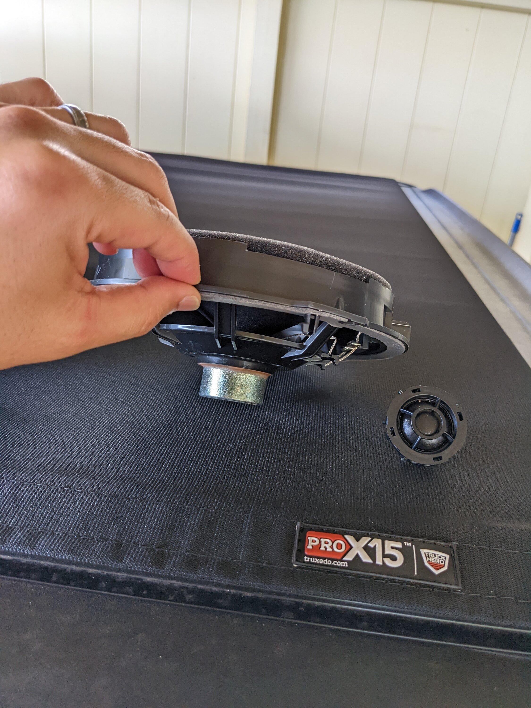

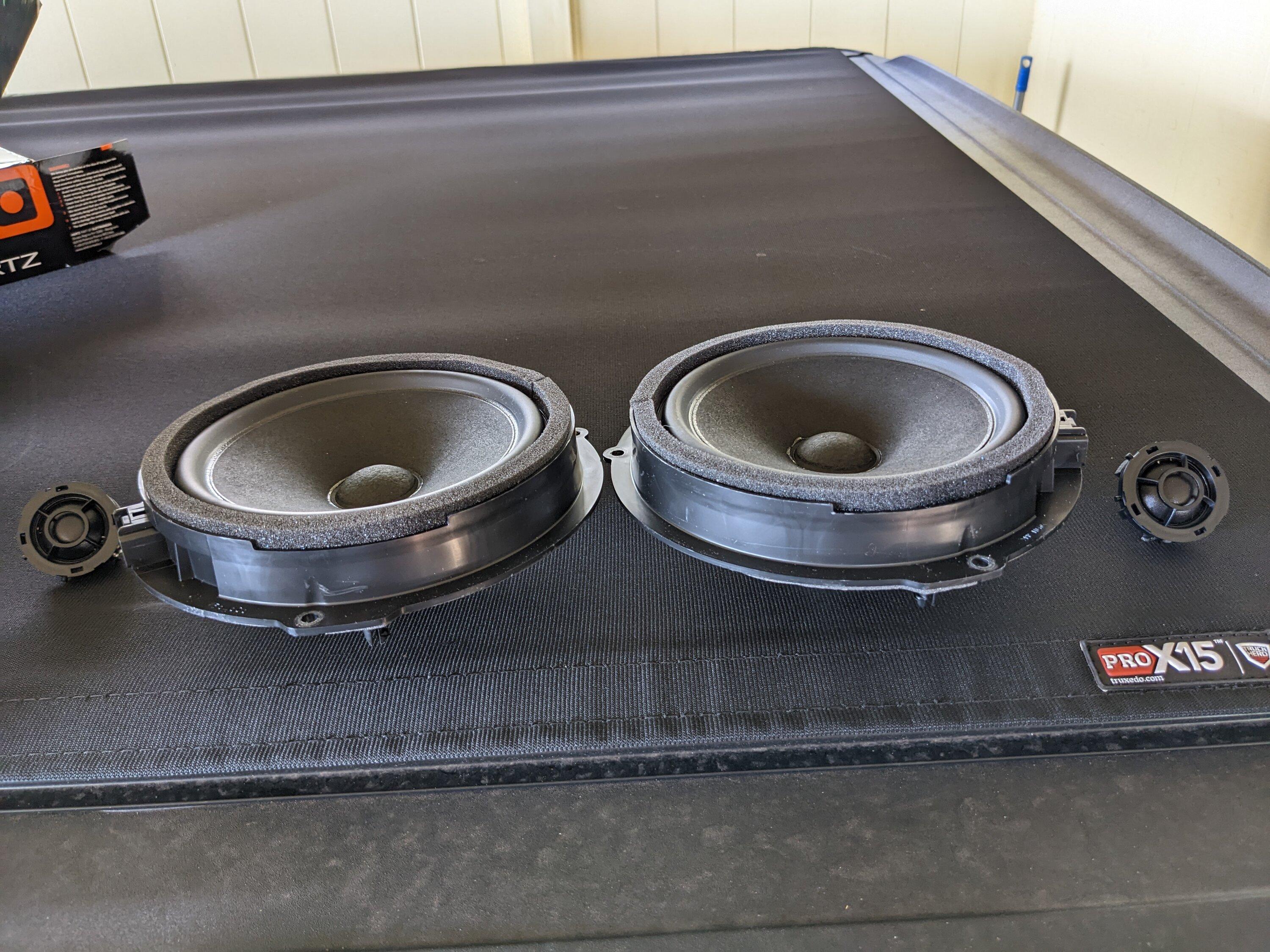

There's may be question as to whether one could just keep the stock speakers, high pass them, and run a hideaway...I think the answer to that is maybe. There are gains to be realized by replacing the stocks, but query whether that is worth the cost and effort to you. Finally, an ode to the stock fronts:
